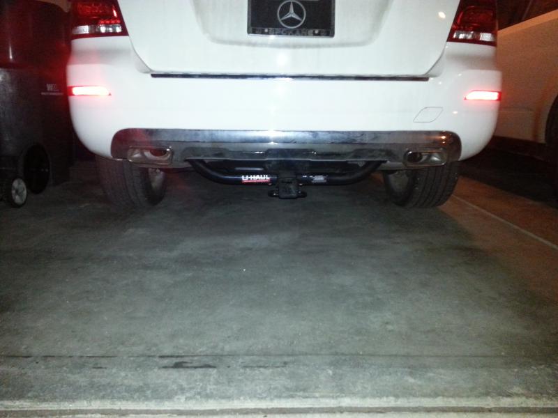

I think the photo did load, I hope. I don't think it's great looking hitch, but it'll will work. My other car is an 09 Subaru Forester, it's hitch is 2 or 3" high off the ground than the GLK's Curt hitch.

pictures? did it look as ugly as the one posted above?

have to agree, toogrumpy was kind enough to post this pic, and thanks for that... But this made me rethink installing an aftermarket hitch.

That's what it looks like. Its tucked way under the bumper. Unless you lay on your stomach taking pictures its not very noticeable. It looks much less obtrusive than the Hiddenhitch.

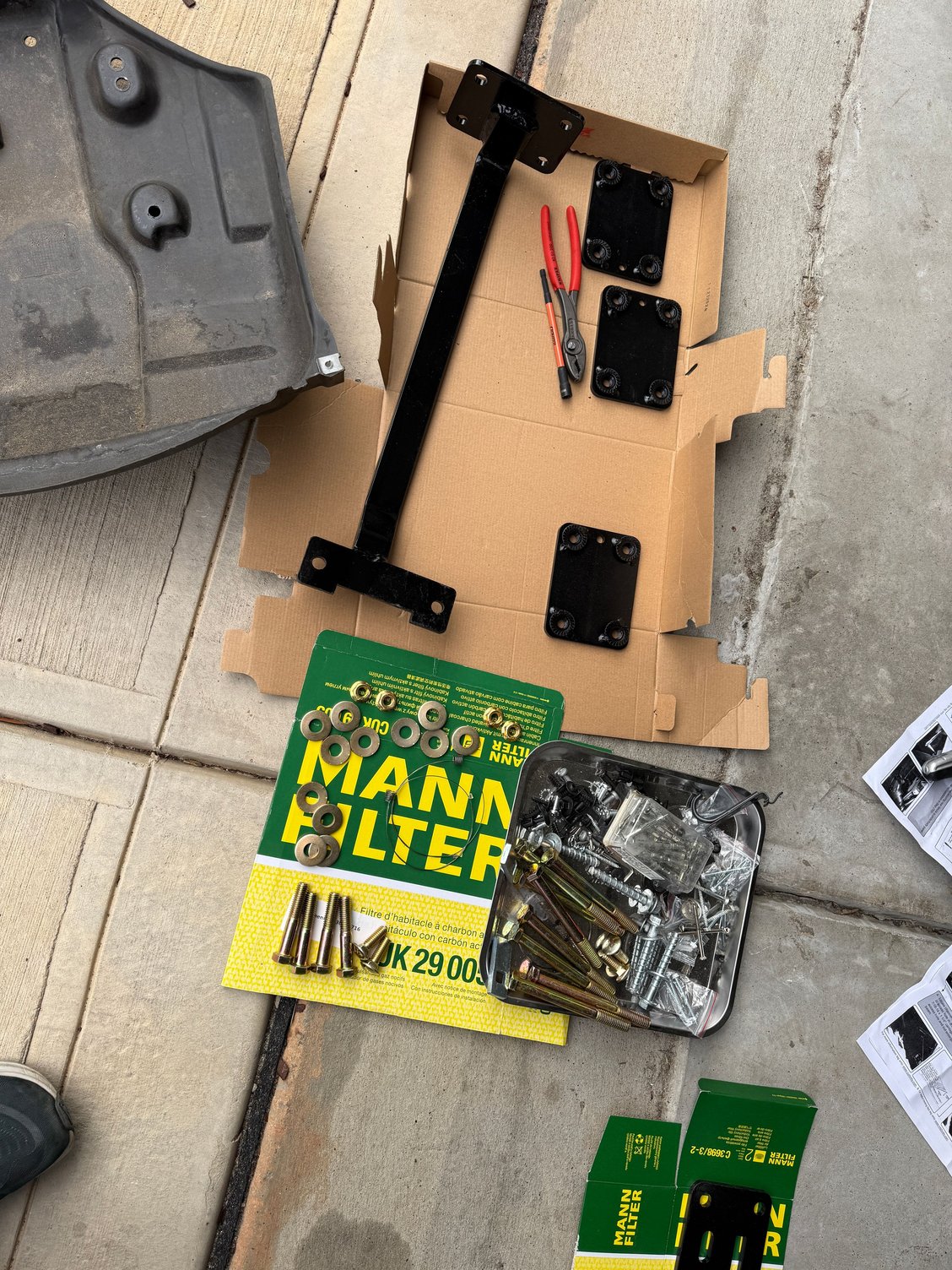

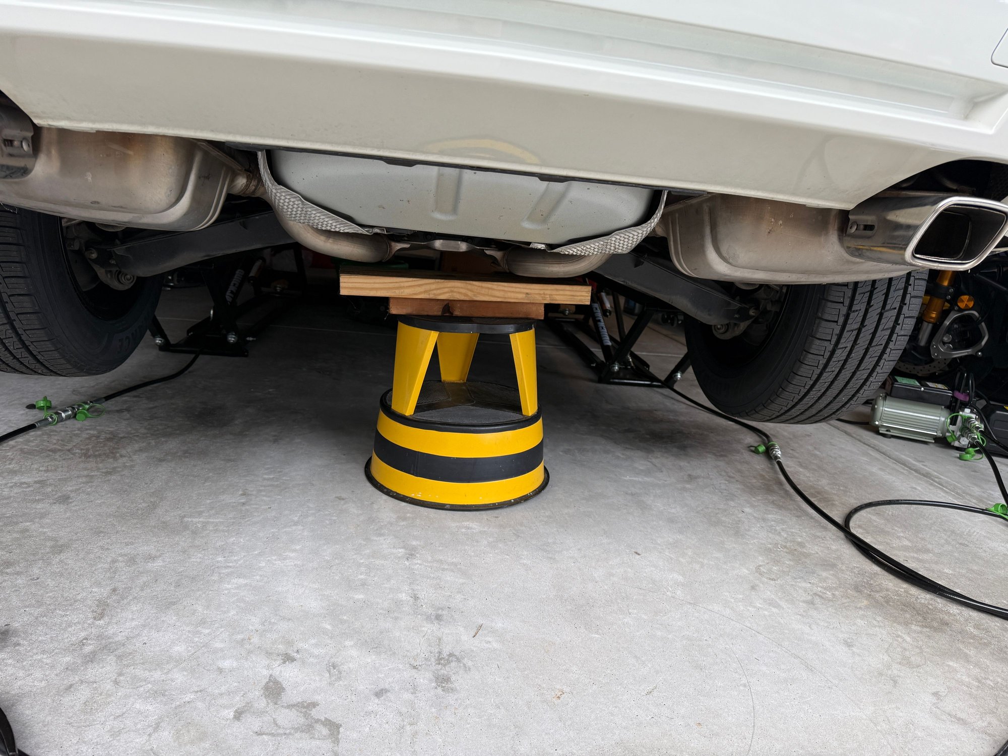

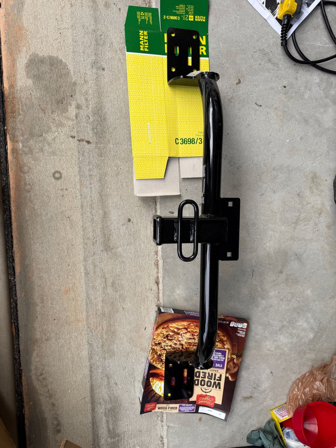

Decided to share my recent experience with installing a Curt hitch on my 2012 GLK350 4Matic. At the time of writing this, there are 2 versions of the 2-inch hitch for sale at eTrailer. I went with the cheaper version to try and save a few bucks but didn't really pay attention to the suggested difficulty of install rating = 9 out of 10. If you read nothing else, and unless you really like punishing yourself, go ahead and splurge for the slightly more expensive newer Drawtite version to avoid the headaches I encountered during installation with mine.

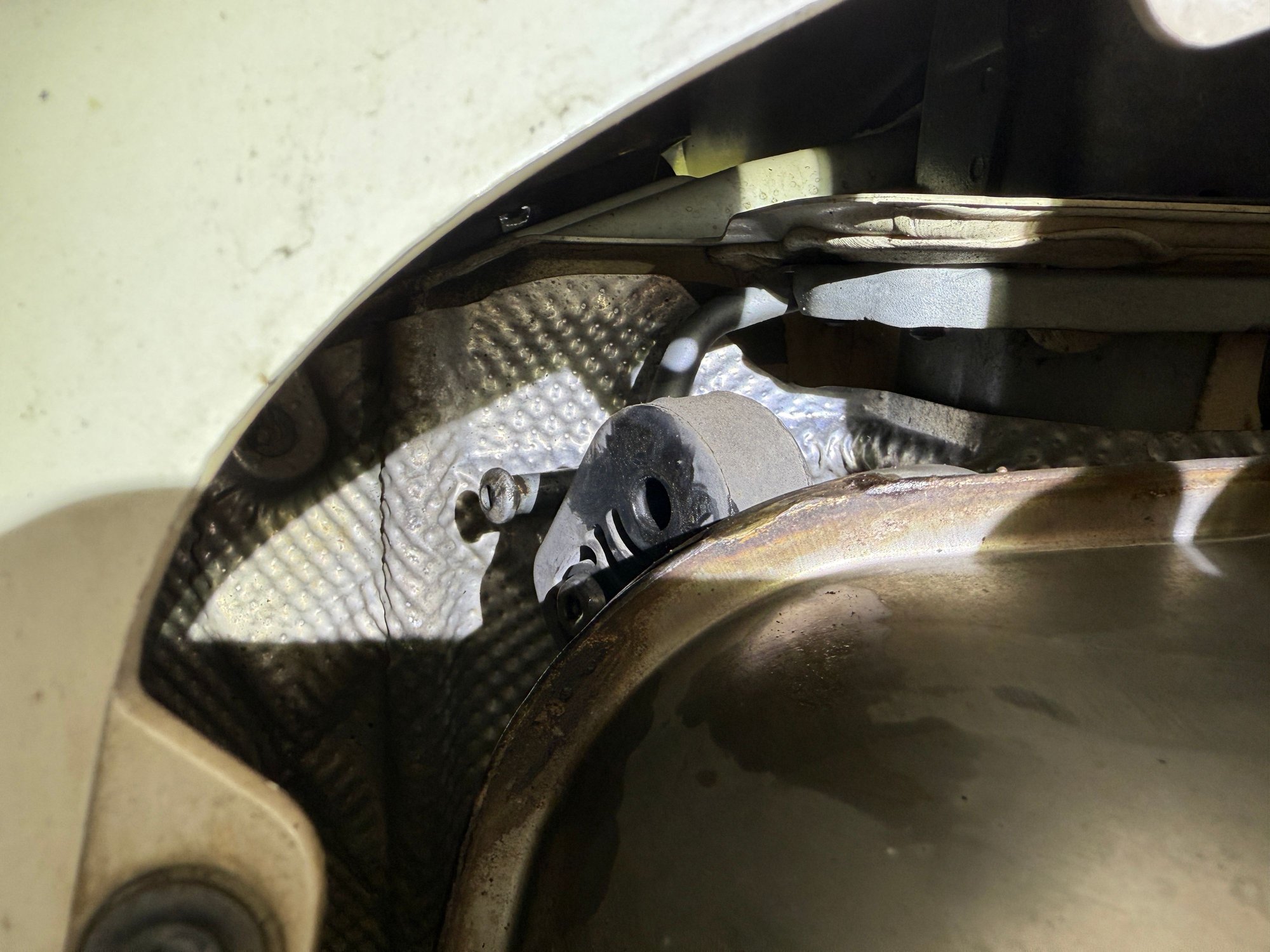

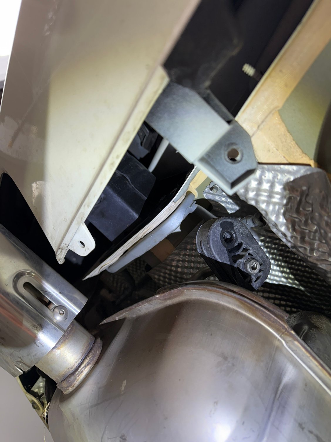

If you do not have a exhaust hanger release tool to help you remove the exhaust hangers from the rubber holders, then do yourself a favor and get the tool along with soapy water to treat the rubber mounts. Makes the job of exhaust lowering significantly easier,
Toughest part of the installation has been trying to fish the bolt and rectangular washer through the driver's side rear beam frame. Very little space to fish the rectangular washer through between the hole on the back of the frame and the rear bumper valence. Passenger side was fine by utilizing the emergency tow hook rear bumper pop out.
Was also surprised when I encountered problems with the reinforcing arm having clearance issues with the rear underside plastic guard for the emergency tire wheel well. Ended up having to remove the plastic piece in its entirety to give the tow hitch enough clearance.
Curt 2 inch hitch
Curt 2 inch hitch
Curt 2 inch hitch
Curt 2 inch hitch
Needed something to hold up the exhaust while I was removing them from their exhaust hangers.
One of the 6 exhaust hanger rubber holders to be removed in order to drop the exhaust.
Really tight clearances to try and reach some of the exhaust hanger rubber holders to lower the exhaust out of the way to install the tow hitch.

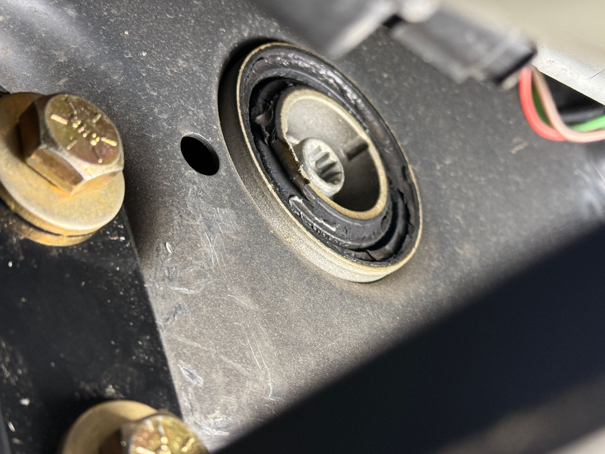

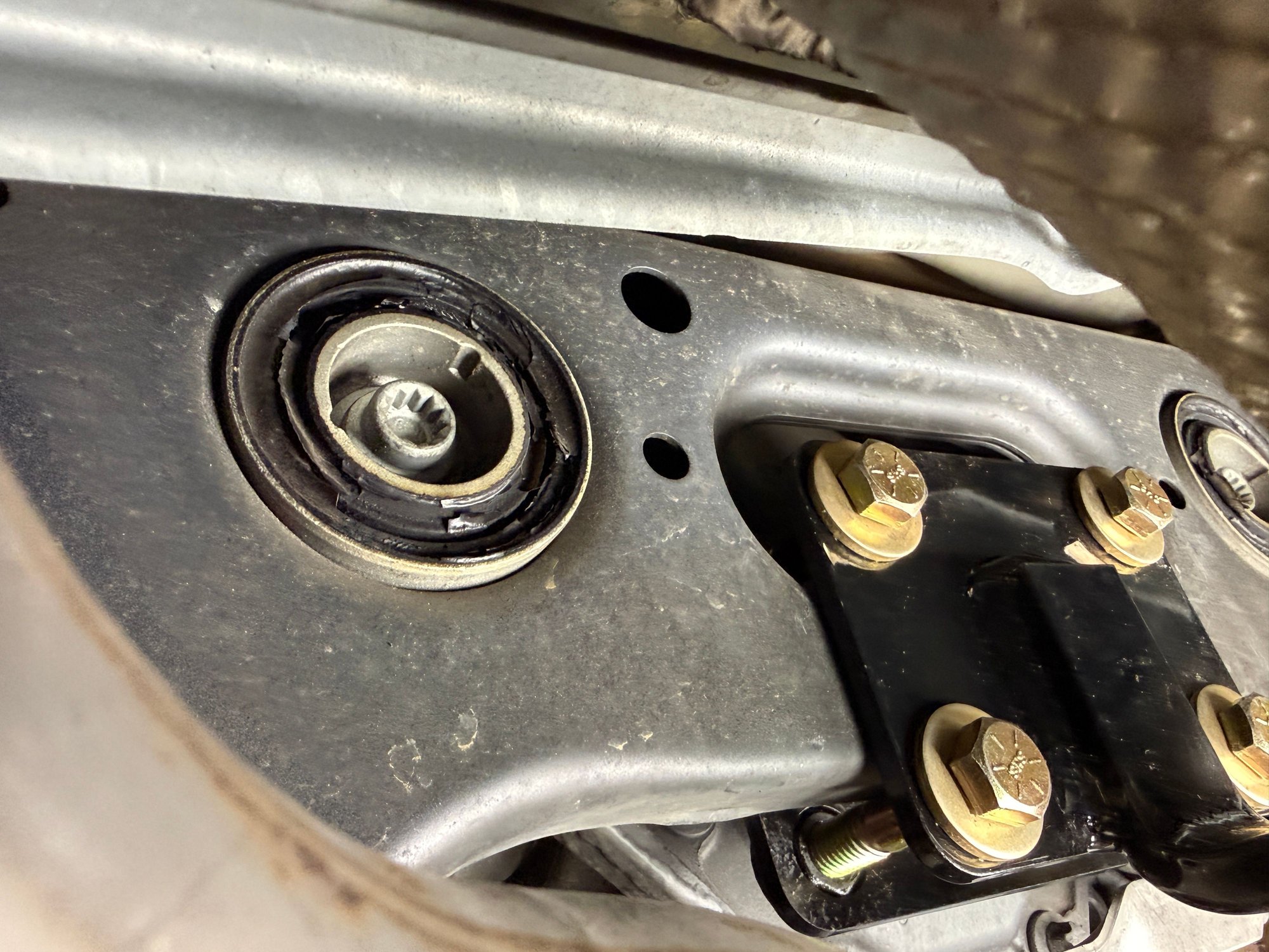

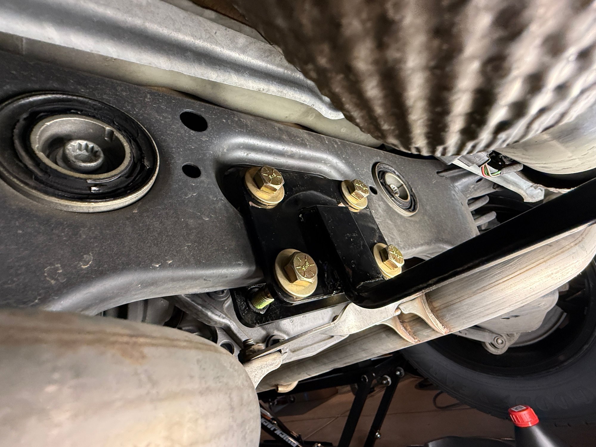

Curt 2 inch hitch reinforcing arm
View of what the stabilizing/reinforcement arm looks like on the underside of the 2012 GLK350 4Matic. I did notice that these bushings looked worn. Anyone know what these bushings are called and whether or not they need to be replaced?
Curt 2 inch reinforcing arm in black as connected to the rear suspension cross frame.
Anyone know what these black bushings are called and whether the wear is normal?
Not sure if this is normal for the black bushings…it is a 2012 GLK350….

What torque did they give you, and what size bolts are the 4 bolts that clamp around the cross member? I was not able to achieve the recommended torque (1/2-13 bolts,110 ft-lb, IIRC) without crushing the cross member...

Keep an eye on that. I just had my rear subframe replaced, thankfully under warranty, for rusting out. The back end gets a bit squirrelly when it finally breaks apart!
Instructions stated 110 ft-lb but I too was not comfortable with that high of a torque level given what I felt as though I might be causing damage to the cross member. I only did about 60 ft-lb for all of those bolts and will keep an eye on them.
