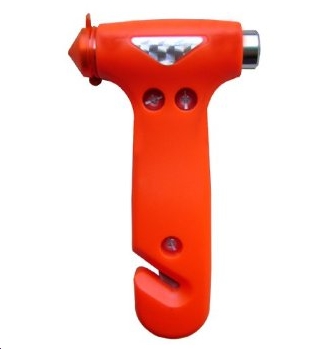

Have you ever seen one of these. It is an amazing tool in case of emergency or in cases of vandalism. It has a pointed spring loaded head that when applied to a window and the trigger is pulled will smash a window into tiny pieces. Fire fighters and EMT's usually carry them. It doesn't leave much of a trace if any at all. This may very well have been the culprit.

I, for my part, do even have one easily at hand in the the car. It's certainly an useful tool in an emergency situation (either ones own or others), to cut safety belts or break windows when (electromechanically operated) door locks doesn't disengage.
However, in the case of CA Bob, I would expect finding fragments of the window inside if such a tool had been used from the outside, not at least bearing in mind the tilting (angle) of the rear window.
An "Automatic Center Punch" which can be purchased from most tool and hardware stores for a few dollars works the same way and can destroy a tempered glass window with only one hit. If you make the initial impact point over the part of the window that is bonded to the window frame (usually that is under the black painted outer edge of the glass or at the edge of the older window mounting gasket) the window will completely shatter but not fall apart.
I have destroyed hundreds of windows that way when I used to part time at a salvage yard.
The simplest explanation is often the closest to the truth. Your window was broken because somebody wanted it broken. With the bad economy there are a lot of Mercedes haters out there.
