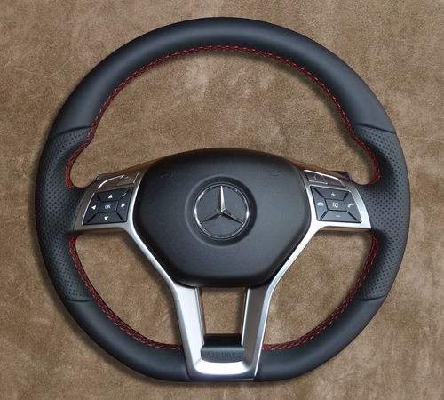

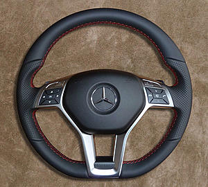

I got this beautiful (C class 204) steering wheel with red stitching to go with my Mars red 2012 GLK. Supplier said it would work on my car except for shift paddles so I went to the dealer today and tried to install it but although it fit fine the control buttons would not function because the wheel was not able to communicate with the computer even though they tried to make it work. Anybody had any experience with changing steering wheels. Waiting to hear if I can return the new wheel and airbag but would love to make it work.

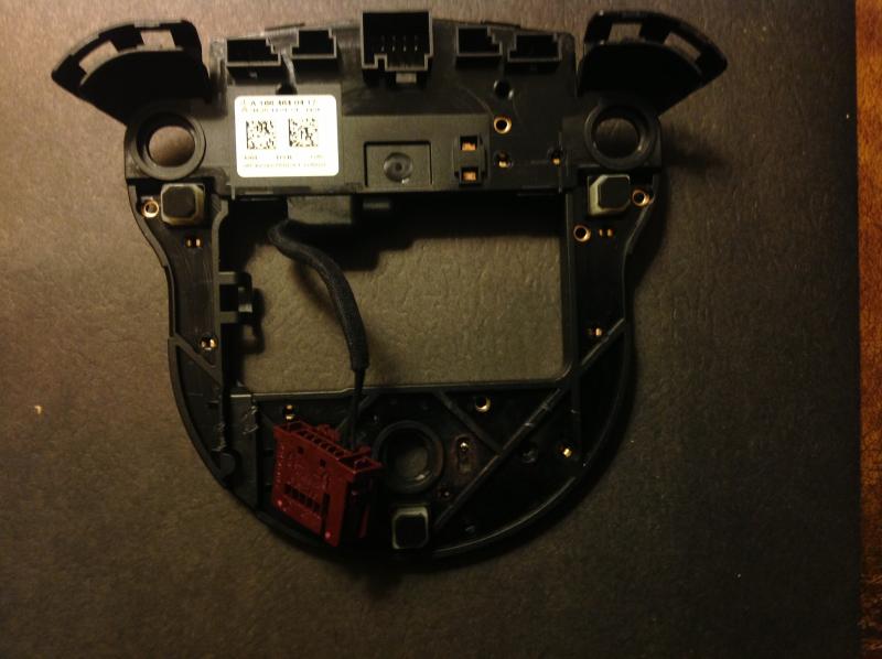

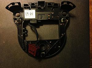

possible solution
The seller says I need a different contact plate there are two different ones apparently and I if I replace the one I got the wheel function buttons will work. Seller will send new plate. Hope that solves problem.

I changed the steering wheel as previous posts show. Ended up having to change the contact plate in the wheel and the steering column module (that has your levers etc in it for wipers cruise etc.) So now all buttons light up and work and here is the bonus - THE SHIFT PADDLES are working - yes shifts show on screen. The cruise control lever also has a speed limiter setting (if set cannot go over set speed with gas pedal have to hit brake first) This all sounds complicated but it isn't and is easy to do and as long as you disconnect the NEGATIVE battery lead before you do anything there will not be any trouble codes or need to go to the dealer.

Pictures
Cruise has extra function and a little light that is on if you are limiting top speed.

I started out just thinking I needed the wheel and that was 850 (EBay). Yes expensive. Then I had to change the contact plate a couple times to finally get the right one - the seller paid for these plates and I only had to pay for return shipping. I had read that the lights in the wheel would not work unless I changed the column module (has all levers on it for turning cruise etc.) so I changed the column module (was 250). This was all a very simple uncomplicated process as long as you always disconnected the NEGATIVE cable from the battery the computer never needed a reset or set a code. The unexpected benefit was that the SHIFT PADDLES on the wheel ARE FUNCTIONAL which means my late 2012 GLK already had the paddle shifting programed into the computer. The red stitching on the wheel goes nicely with the Mars Red color of the car and black interior and the flat bottom of the wheel gives a bit more room to enter and exit the car. Overall it was good learning experience and I am totally pleased with the result.

The GLK pre-2013 steering wheel has a totally different contact plate design.
Contact plate has to be one that can interface with car computer on your specific model. I only changed levers module so that the lights on the wheel would work but I could have left the original and everything would work except for the button lights. C class forum has lots of posts about all this.

Yes this all gets confusing. I wish I would have written the part numbers down - the SCM (steering column module with levers) had to work with the wheel and I think was an Eclass part (my original one worked fine except for the lights for the buttons) The contact plate is different for different models because it has the electronics that interface with the specific computer on your model. so the contact plate (as seen in an earlier post on this thread) was specific to my GLK. The supplier knew his stuff and kept sending me the parts I needed until I got it all working. He did need my VIN. I could get his email probably if you are interested in this mod.
