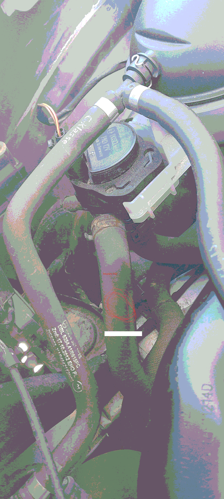

Mystery hose goes to little pump at end of expansion tank

It is now 2026. I just found this post as I am indeed trying to activate my jacket water heater (block heater) as it is -26 today and has been for a week. The Canadian Spec GLK's have a few extra parts and they are designated in the parts system with build code "460" I have yet to figure out what all is included in "460 builds" . The small coolant hose coming off the black plastic rad pipe joiner piece goes up to the output of a little water pump mounted onto the front of the expansion tank. The pumps suction is from a rubber, then steel line that disappears aft beside the engine on the passenger side near the body, under the air filter box. I have noticed that the little pump runs for a few minutes after shutting down the engine. Perhaps it is for turbo cooling post engine run?
Line in center is from main rad hose joiner/branch
pump's suction line can be seen running aft.
