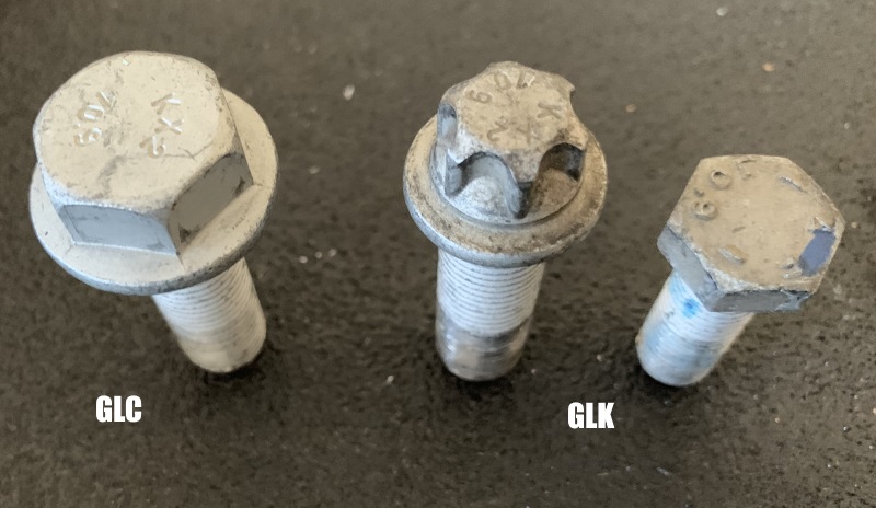

Do the rear caliper bracket bolts also use E18 socket - or is it something else?
Old Oct 2, 2019 | 10:43 AM
  #66
JohnnyC's Avatar

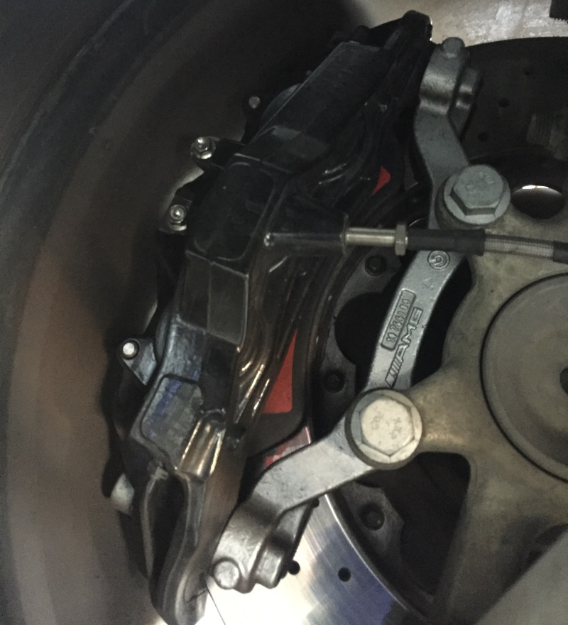

Originally Posted by JohnnyC
Wheel bolt:
M14 x 1.5, radius seat
17mm hex, Mercedes 17mm key, or lock key socket
150Nm ~ 110 ft-lbs
Front brake caliper mount external torx flange bolt:
M14 x 1.5 - 45mm
E18
000000-005639
180Nm ~ 133 ft-lbs
Rear brake caliper mount hex bolt:
M12 x 1.5 - 35mm
18mm
124-421-05-71
120Nm ~ 88.5 ft-lbs
Front floating caliper guide pin hex flange bolt:
M10 x 1.25 - 31mm
15mm hex + 20.6mm flat
000-421-53-74
29Nm ~ 21 ft-lbs
Rear floating caliper guide shoulder screw:
7mm hex key
000-421-08-18
34Nm ~ 25 ft-lbs
Brake disc retention screw:
M8 x 1 - 12mm
T30
220-421-01-71
10Nm ~ 7 ft-lbs
Right brake caliper sensor external torx flange bolt:
M6 x 1 - 20mm
E10
910143-006002
8Nm ~ 6 ft-lbs
Front hub axle flange bolt:
M16 x 1.5 - 60mm
E24
000-990-75-03
160Nm ~ 118 ft-lbs, loosen,120 Nm ~ 88.5 ft-lbs, then 90°
Rear hub axle flange nut:
M26 x 1.5 - 17mm
32mm or 1¼"
000-353-13-73
350Nm ~ 258 ft-lbs, then stake
Rear wheel bearing carrier flange bolt:
001-990-42-03
70Nm ~ 52 ft-lbs
Front outer tie rod flange nut:
M14 x 1.5
000000-008261
50Nm ~ 37 ft-lbs, then 60°
Front tie rod jam nut:
M14 x 1.5
308673-014001
65Nm ~ 48 ft-lbs
Front inner tie rod assembly:
41mm octagonal
212-330-28-03
110Nm ~ 81 ft-lbs
I would HIGHLY recommend updating the caliper bolts. it will make your future brake jobs easier
124-421-05-71 (GLK350 rear caliper bolt) -> 018-990-00-01 (CLS63 rear caliper bolt)
000000-005639 (GLK350 front caliper bolt) -> 019-990-79-01 (GLC300 front caliper bolt)

Awesome. The E18 was unpleasant to remove - even with the right socket. I'm thrilled to see that the rear is not an E18.
In what way are the suggested updates different? How does the update make it easier?
Many thanks!
Old Oct 2, 2019 | 07:32 PM
  #68
JohnnyC's Avatar
Joined: Sep 2014
Posts: 1,051
Likes: 217
From: LaLaLand
2015 GLK350 & 2020 C300
The bolt part numbers I provided have a bigger flange and are hex shaped. My brake system is modified, but you can see the difference.
