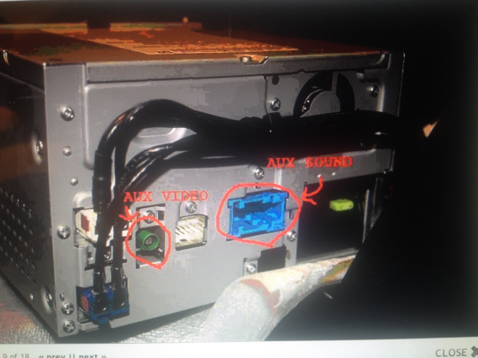

I updated my navi system from standard audio and have no audio? I'm wondering why the blue "AUX SOUND" connector circled in photo didn't have a male piece from my original system, and if that is why I have no audio. Any ideas would help, CD player and FM works, screen functions.

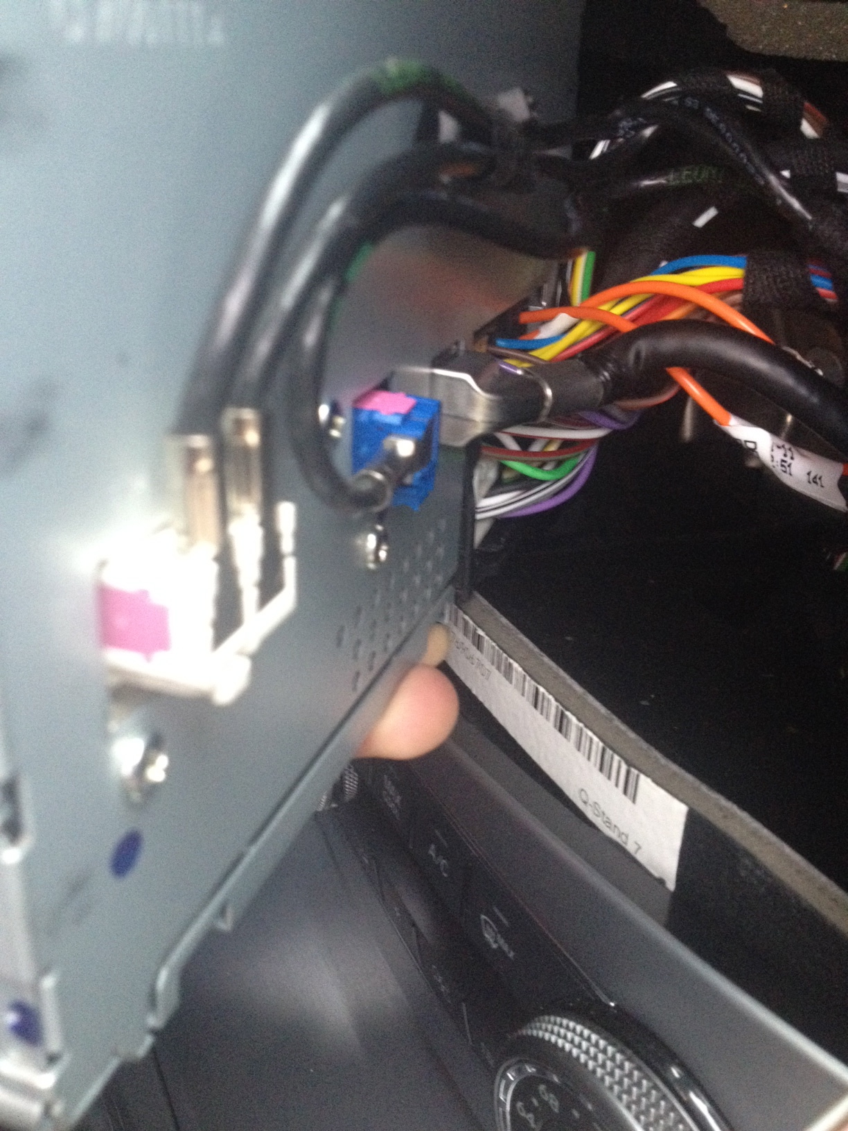

Added another photo of the original system, see 2nd photo.

Is this for the blue "AUX Sound" connector, seems like it.

This morning I went into engineering mode, Audio was disabled, wouldn't let me highlight it to turn it on, I'm guessing something isn't connected and that's why?

MBUSSADO IS A GLK GOD! WE FIXED THE PROB AND IT WAS AS SIMPLE AS TURNING "AUX ON/OFF"
