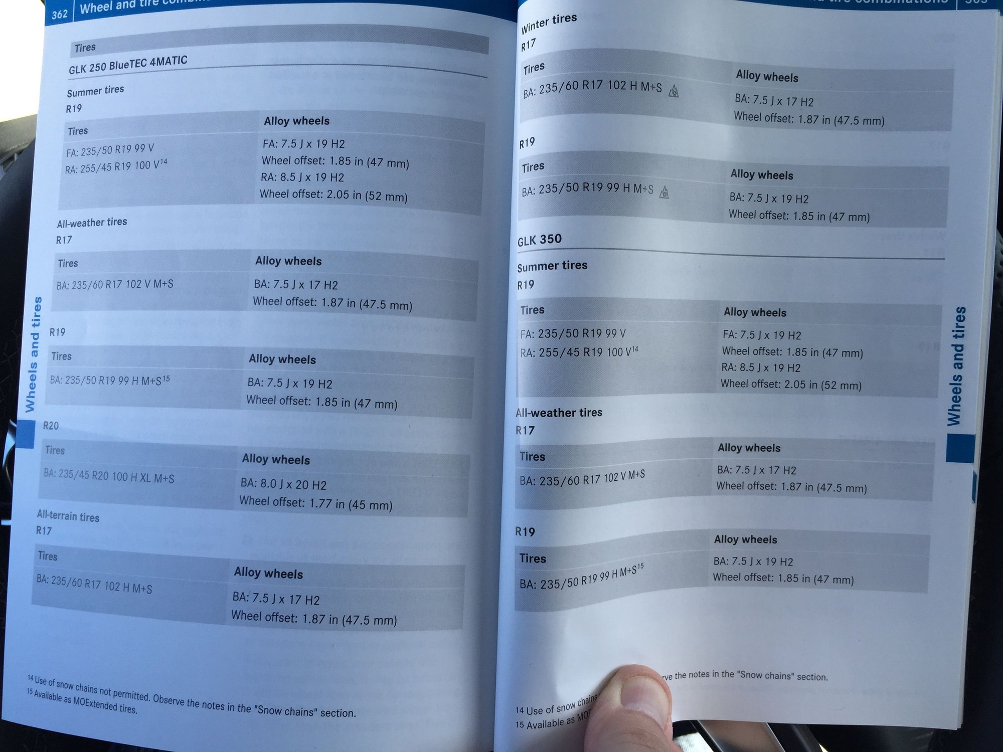

Woo hoo! Found this table in the Manual today. Hope it helps someone. And a mandatory thumb picture too

Original Question: What is narrowest rim for winter driving?
I think that this picture above, as well as the specs I compiled from the on-line OM, confirm what I posted above as to the proper dimensions and tire selections for winter driving, viz:
Here is the data from the Mercedes Benz OM on winter tires with a 17" rim:
Winter tires R17
Tires: 235/60 R17 102 H M+S plus iceflake symbol
Alloy wheels: 7.5 J x 17 H2
Wheel offset: 1.87 in (47.5 mm)
Note that, in the picture above, NO wheel spec for any season is less than 45mm offset.
