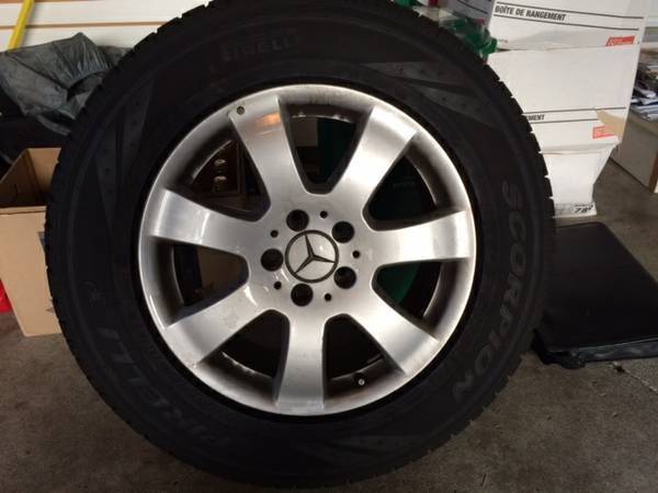

Just came across a set of oem used rims and tires in my neighbourhood off from an ML. Used for one season and the price is not outrageous. Checked on rimsntires.com and they seem to be ok for my GLK 250.
Would you guys see this as an insult to GLKs, or I could be forgiven for this cross-pollination? Any other thoughts?

I am a new MB owner, but I don't see any harm in it if the wheels fit and the offset is correct. If you are using them for winter wheels, no one will care once they are covered in schmutz. I have found that the finish on OEM wheels usually hold up better, especially in the harsh environment associated with winters up north. If the price is right, it seems like a logical choice.
Do you have a picture of the wheels?
OJ
Reply 0
Nov 7, 2015 | 10:53 PM
Thanks. The ML wheel has 7 spokes as opposed to 5. Slightly bigger offset too.
