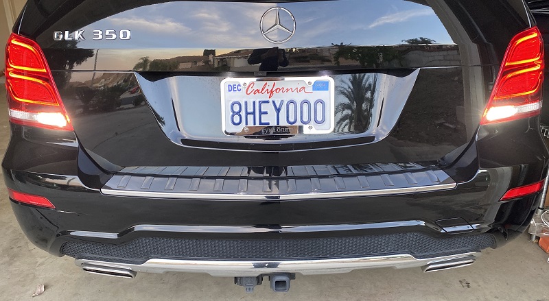

So I finally found some reverse LED bulbs that I liked on Amazon from this company called MAXGTRS. These bulbs actually have a housing for the board.
Not bad , mines been holding up , pretty good . I believe there philips
