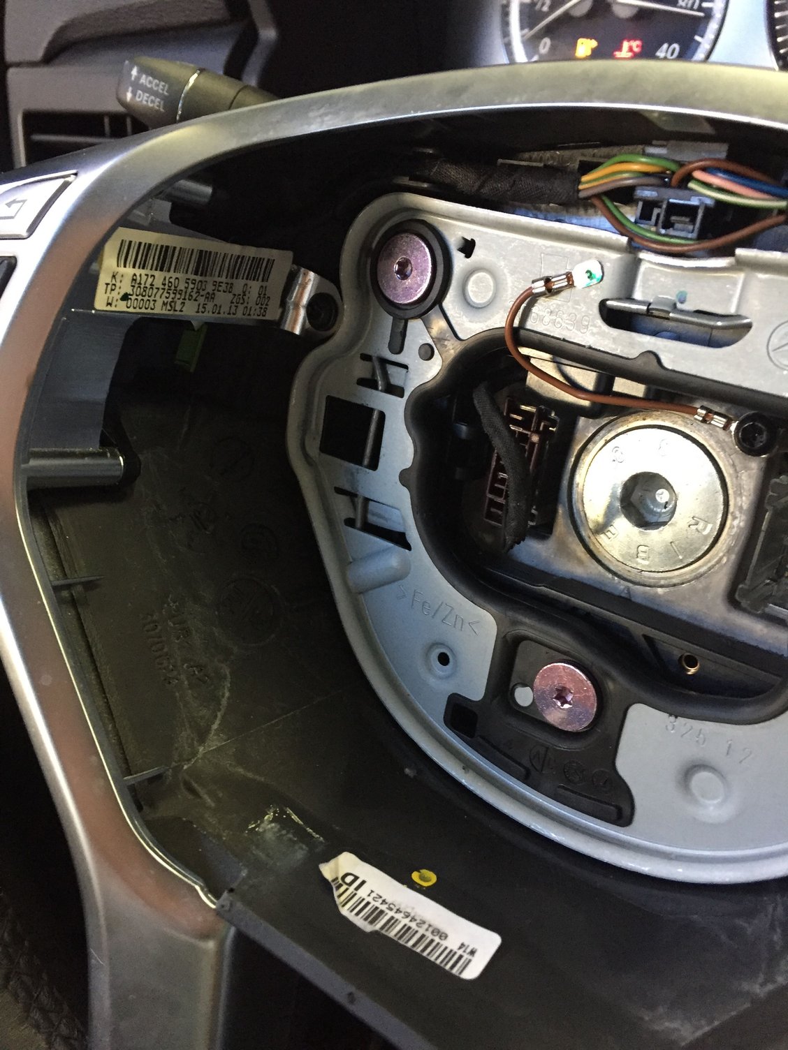

Hi!
i bought a used steering wheel of 2013 c300 and i installed on my glk 2012 but none of the button seem work, , horn and buttons doesn't work, the airbag is ok (NO scan code) . i already see other threads and its compatible maybe is the contact plate that i have to replace?

so looks like you are using a 172-460-59-03 flat bottom steering wheel with a pre-facelift GLK. Looks like you need a new steering column from a newer W204.

so looks like you are using a 172-460-59-03 flat bottom steering wheel with a pre-facelift GLK. Looks like you need a new steering column from a W166 166-900-96-02.
I read other thread that you only change the steering column to function the control lights, i guess i need another contact plate?

No the steering column is the only part need. the Contact plate is backwards compatible. The steering column doesn't work with new steering wheels.

thanks to all , i only replace the new chip for the old one. all good
