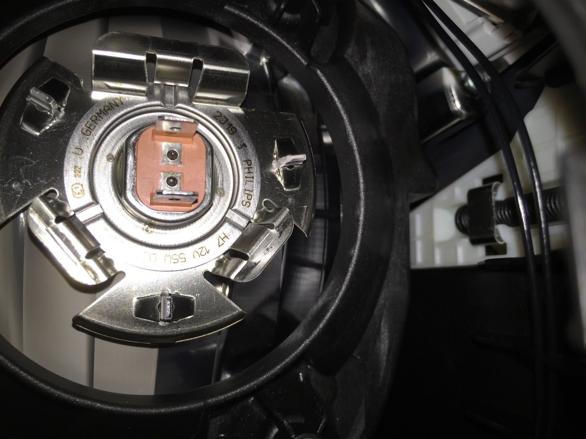

I need to find out how to remove an H7 low beam bulb from a 2013 GLK 350

I took a picture and want to find out how to remove the bulb, I appreciate any help I can get.

The two smaller tabs need to be slightly bent outwards (they are pliable spring stainless steel). You can then tilt it off the top tab.
