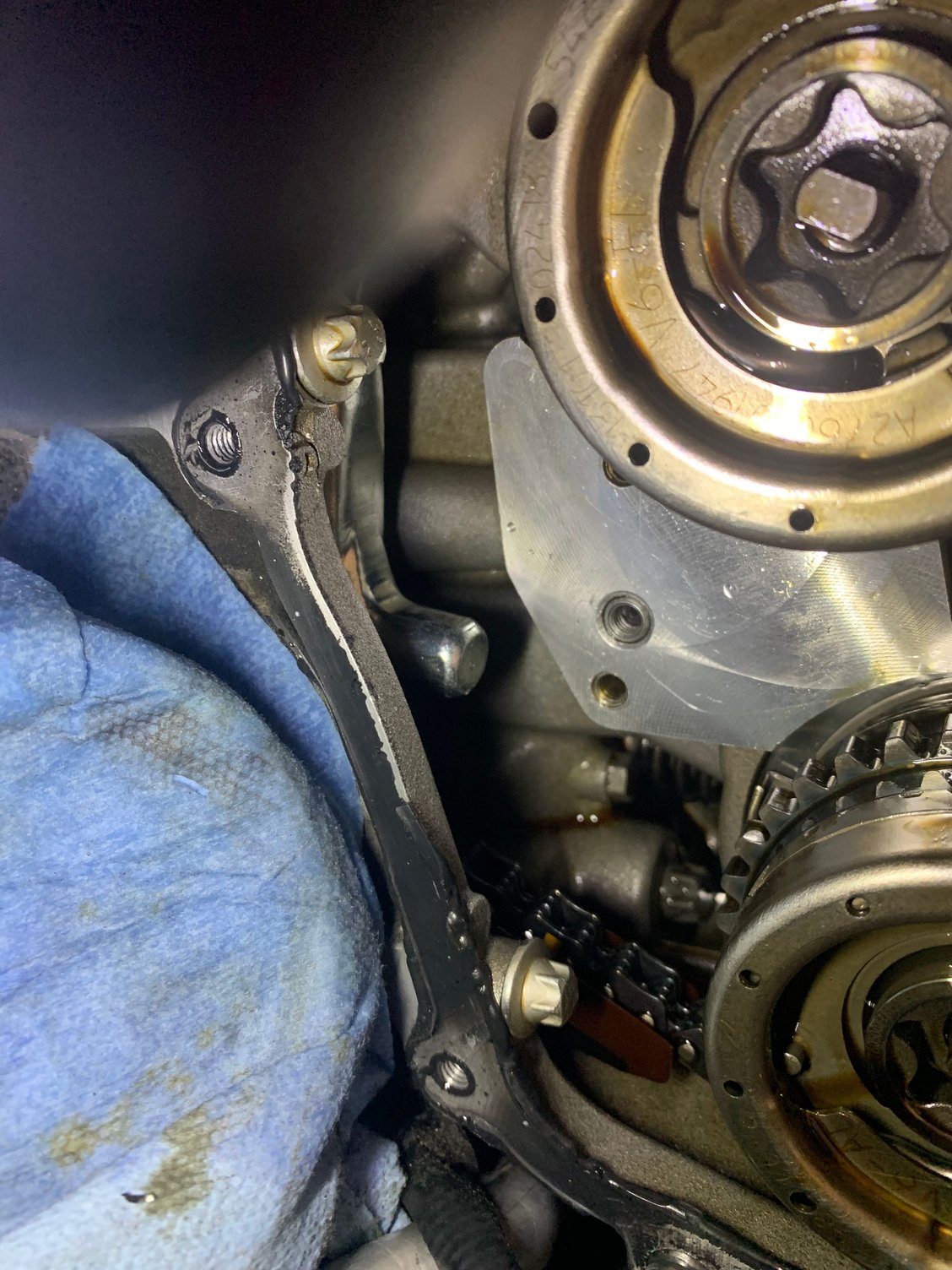

Hello guys . Thanks for having me in the forum . So i have 2013 GLK 350 and today i decided to change the left tensioner and check valve because i had auful noises on cold start . Everything went well untill i ripped the check valve threads and the valve housing left inside . What can i do to remove the housing ?
Im so frustrated ..... Could i try with screwing a M6 Tap inside and try to pull it out ? Or you guys give me other advice .

I can't really tell what I am looking at here. Is there a check valve stuck in one of those holes? Did you strip the threads?
If there is a check valve that is supposed to screw out and the threads are stripped then yes, try cleaning it up with a flat bottomed tap. Since it is aluminum you could also try to carefully straighten the threads with a sharp hard steel implement. There are also some specialty tools made for reforming threads in cases like this.

Yes actualy the check valve is made from 2 parts , the hreads are crimped inside . When i used slide hammer i ripped them . So now the housing is inside . When i screwed the tap it gripped and now the valve is loose in the hole . Obviously from the factory the surface is hit by something and this prevent the valve to be removed . I have ordered a cone rimmer to remove small amout of the aluminium from the hole to be easy to extract the valve housing . I hope this will work.

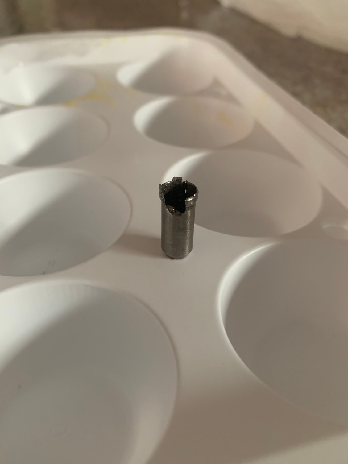

Hello People , i have success the valve is out .
I am attaching pictures and i wish success to other guys with me . I hope that this can help .
Cheers guys .

congrats, Bro. not easy job, wasn't it. Did u change the check valves because they are gone bad?

Oh it was a nightmare the last 3 months . You cant check the valves because its a ball with spring and they are encapsulated inside . Be extremely carefull when removing the valves . Buy a decent slide hammer and be gentle .
