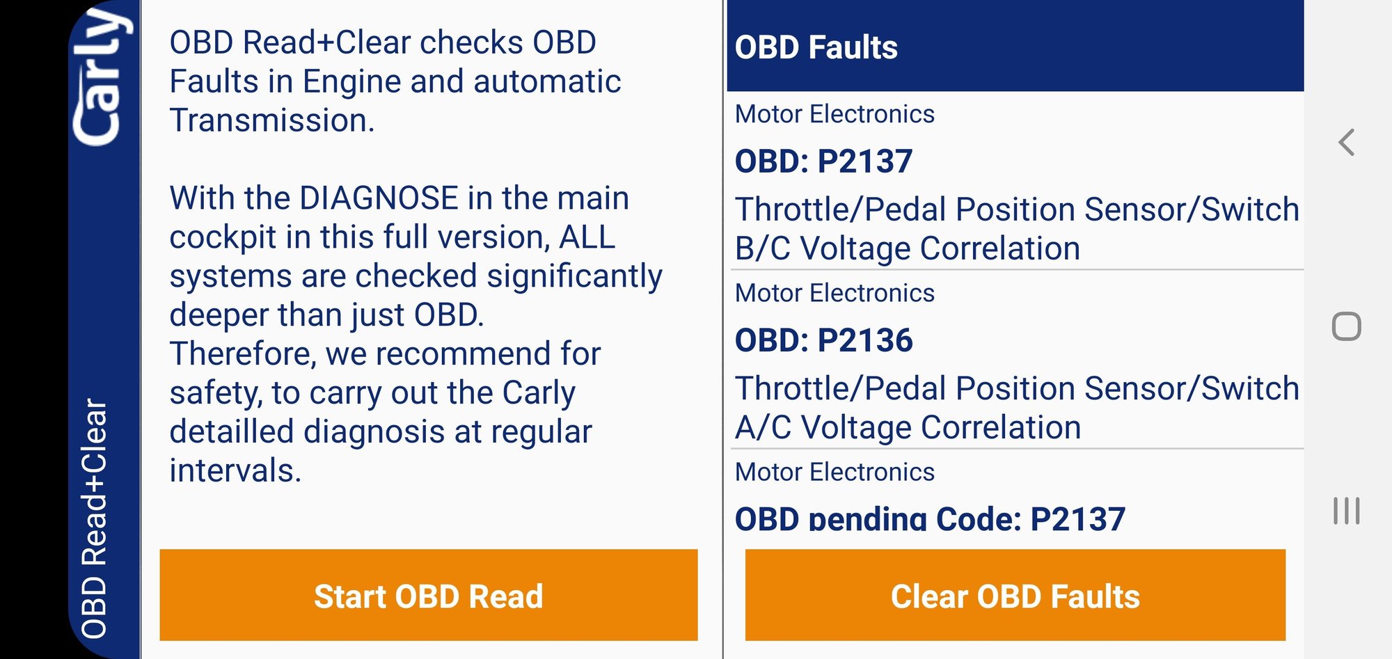

I got a check engine light with the following error codes P2137/P2136 (Throttle/Pedal Position Sensor/Switch/BC and A/C voltage correlation. What does this mean?​​​​​​​

I tried this little temporary fix below, but it did not seem to clear the check engine light. Just curious on how serious this fix is to get completed. I have 62K miles1. Turn the key to ON position. Position II that is. Don't start the car.
2. Press and hold the gas pedal for at least five seconds. Keep the pedal pressed.
3. Turn ignition off but do not remove the key. Now release the gas pedal.
4. Remove key. Wait a minute before you restart your Mercedes.

How old is your battery and what is the voltage before you crank up the engine? I'd clear the code with the OBD tool, then see if/when it comes back.

Typically, electronic throttle pedals have several different position sensors, for example, one that increases in resistance with added throttle, one that decreases, and a third with a different rate of change, When the ECM detects a difference in the reported position between any of them, it sets a code. Voltage issues, connection issues, or an internal fault can all cause the code.
