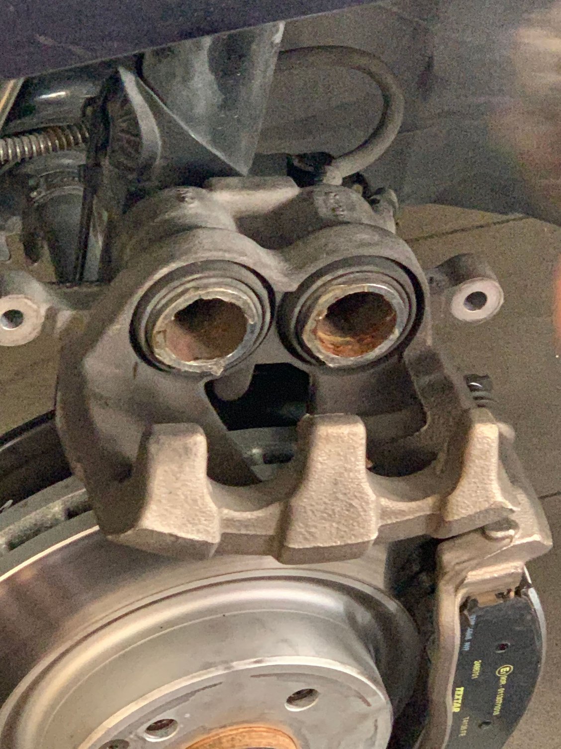

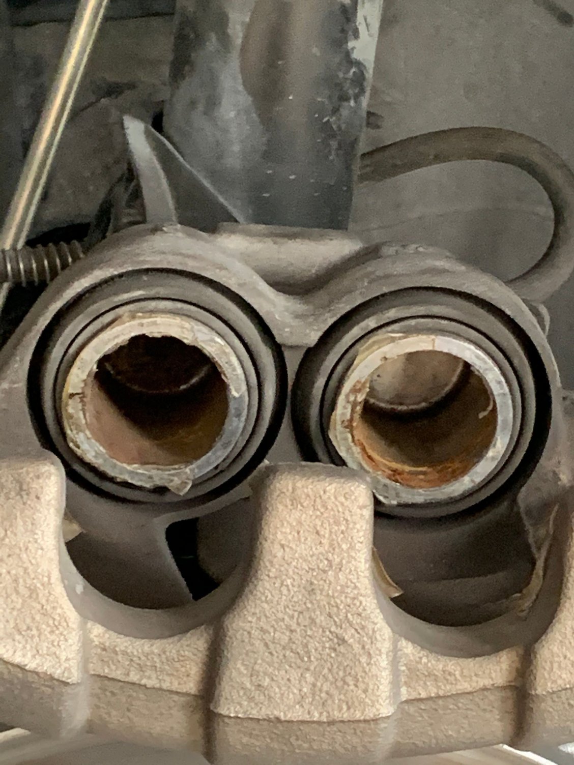

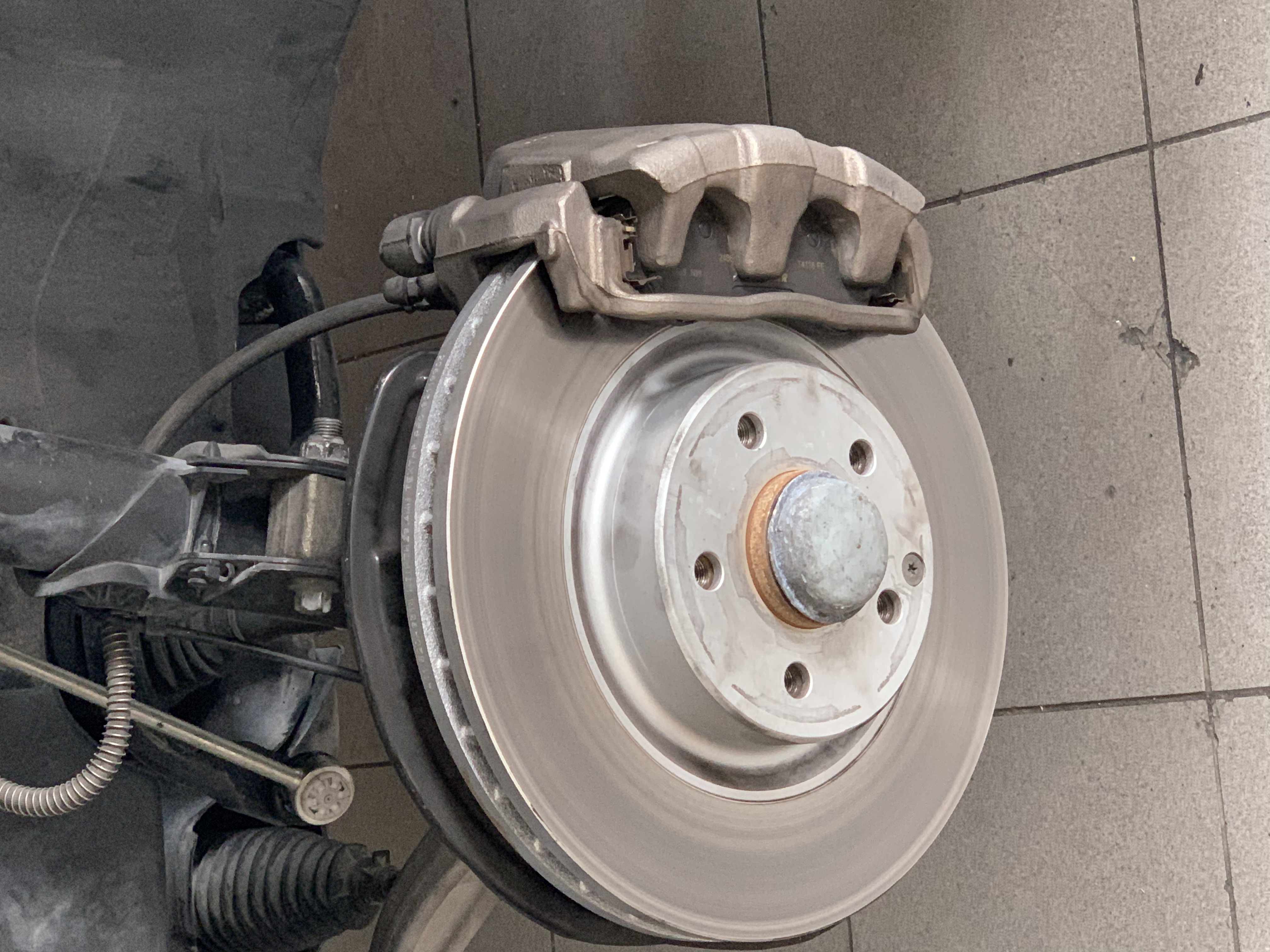

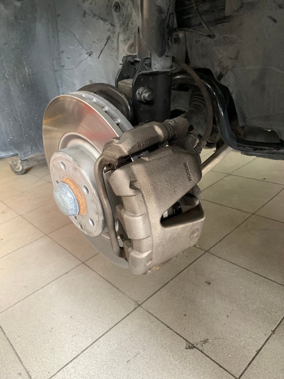

I got my caliper checked today and it’s in a very good condition so the issue is not because of it.
I will take it to a MB specialist garage next weekend.
see attached from todays inspection..
Attached Thumbnails Grinding Noise From Front Left-99140ccc-2c30-4071-a01f-06730fb9f8f2.jpeg

When finished with the vehicle for the day, jack up the side you think the noise is from, spin the wheel the next morning , find the issue , I’ll bet it’s the caliper.
Old Mar 14, 2020 | 12:49 PM
RaiderG's Avatar
Joined: Mar 2020
Posts: 22
From: Dubai
2014 GLK250
Here is the video of the slider pins, lubriciously sliding..
https://streamable.com/823pj
