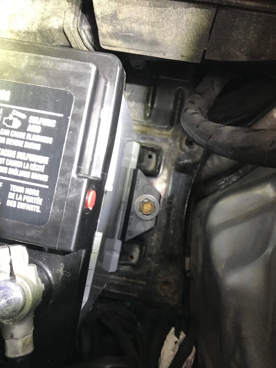

We recently purchased a 2010 GLK350. My last benz was a 1991 560SEL so bare with me...
it only has 87000kms on it and was used sparingly since 2015. It sat a lot in underground parking.
it has a Bosch s5 battery dated 9/14. Group 48 It load tests ok, but I'd you leave any lights on while parked for any longer than 20 minutes it wont start without a boost.
Should I replace with a group 48 (H6) or an H7? It has what looks like 2 position for the single hold down clamp and another 2 bolt hold down clamp at the end of the tray. It looks like the H7 will fit.

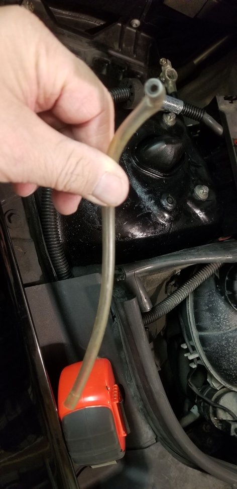

The battery in it is a vented lead with what looks like a factory vent hose, the lower end of the hose is broken off...
I am going to go with am AGM for sure, just wondering if I should up it to the h7?
also, should I replace the aux battery at the same time?
Thanks.

Why do you leave lights on 20 minutes? What was the load test for CCA?
6.5 years is old, I just put in a H7 AGM, the old battery load tested ok but CCA was about 420 so I didn’t think it would last the winter if it got to -10 /-20f. Mine was a 2013. Who you buy the battery from will tell you how big you can go.

H6 vs h7, I live where it can get to -20f , so the biggest battery is just insurance it will start, and it depends on how long you plan to keep it, I just paid 325 for an interstate AGM
