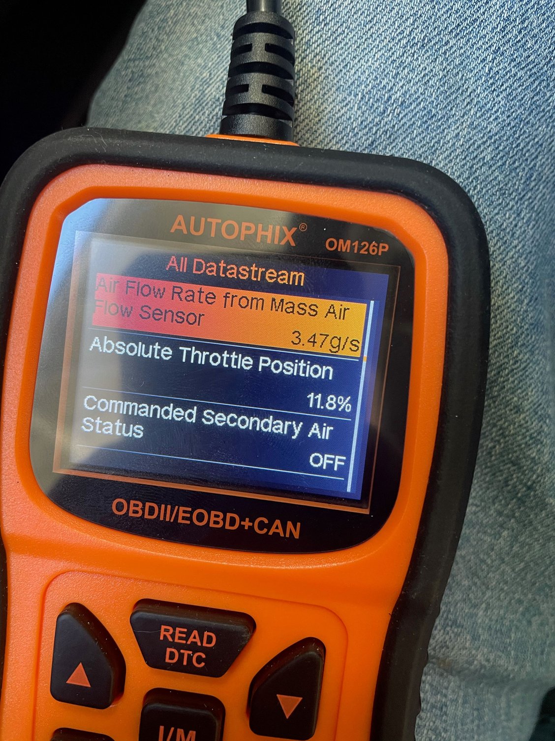

Hi all, Jason here...new to the forum. Been reading some of your fine work and suggestions so far. Keep up the good work! So, I just bought a 2010 fully stacked with literally everything and in pristine condition appearance wise, along with brand new Pirelli 20's....for 10k. I figured that left a few K to play with to fix up whatever hopefully minor things needed to be updated/fixed/replaced. Also checking carfax recently it has had fuel filter, battery, alternator, oil/oil filter, front sway links and secondary fuel pump fixed/replaced. Car has 134k on it which is more than i wanted...but it just is so damn nice so i went for it based on how she looked and what's already been done. Test driving it it has a clunk in the front a bit....even after sway links done...i find that not a big deal as i can rent a lift and swap out some control arms myself for a reasonable cost. Same with squeaking break pads...easy stuff.
However, after a week of light driving it threw some codes....P0172 and P0175 (system too rich both banks)...and once it threw a P0140 (i think it was...forgot to screenshot that one..that one went away and hasn't been back yet though). So i called the place on the carfax who a month ago replaced the secondary air pump...cause of the P0140 or whatever it was. They said they'd have to check the secondary air control valve next.
So far I have changed dirty air filters, and cleaned the MAF sensor. It's been 38km and no codes yet...but the car seems like it is struggling for air and my guess is they will come back.
Symptoms include:
-Low Idle about 500rpm at idle and 600 in drive with foot on break
-Ticky engine noise when fully warm and at idle
-Seems to get a little hot...middle point is 80 on engine temp...it rides at 90 when warm

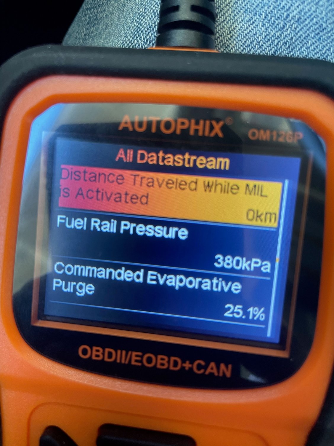

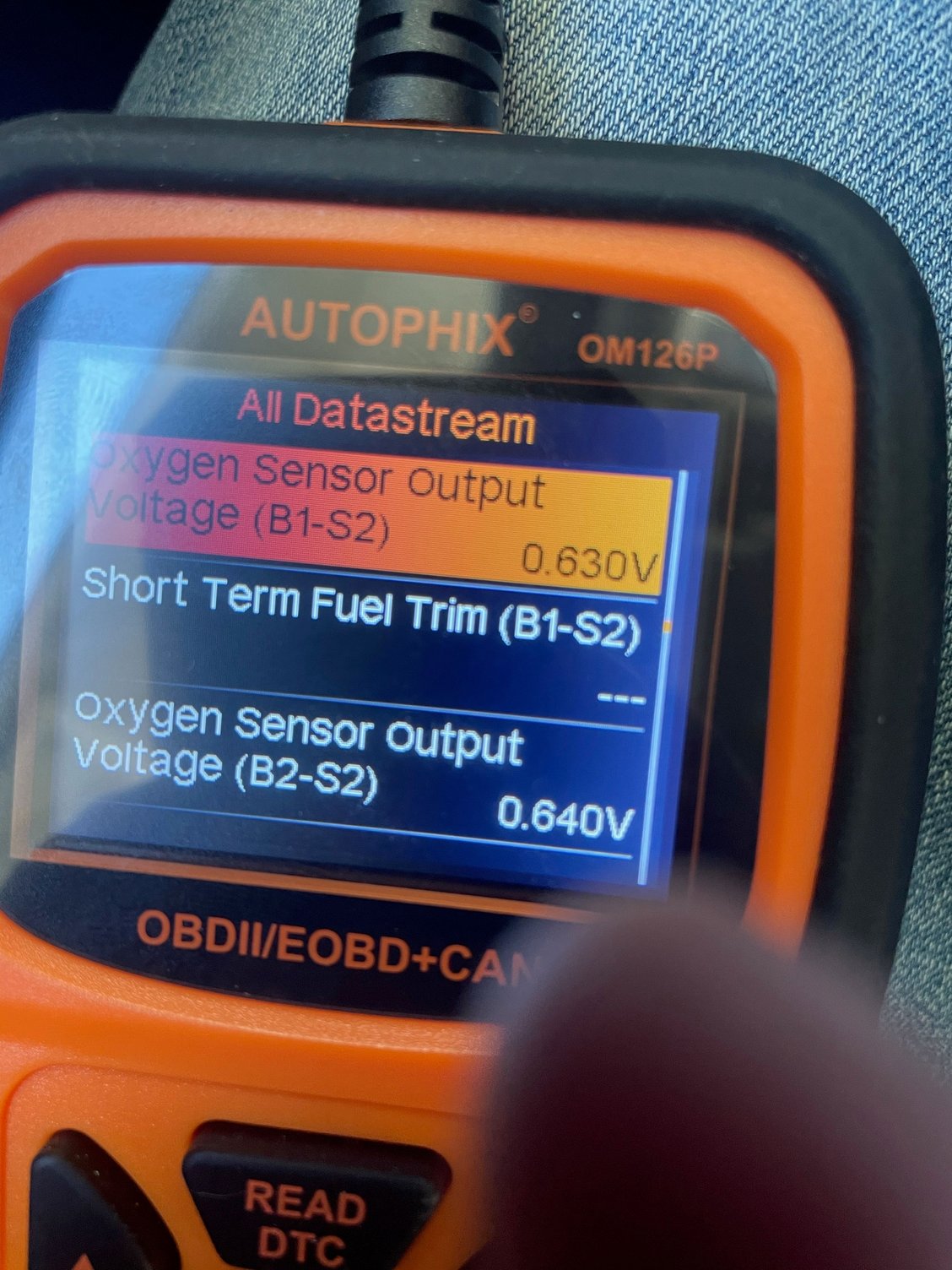

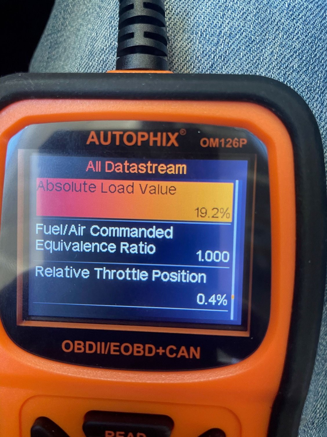

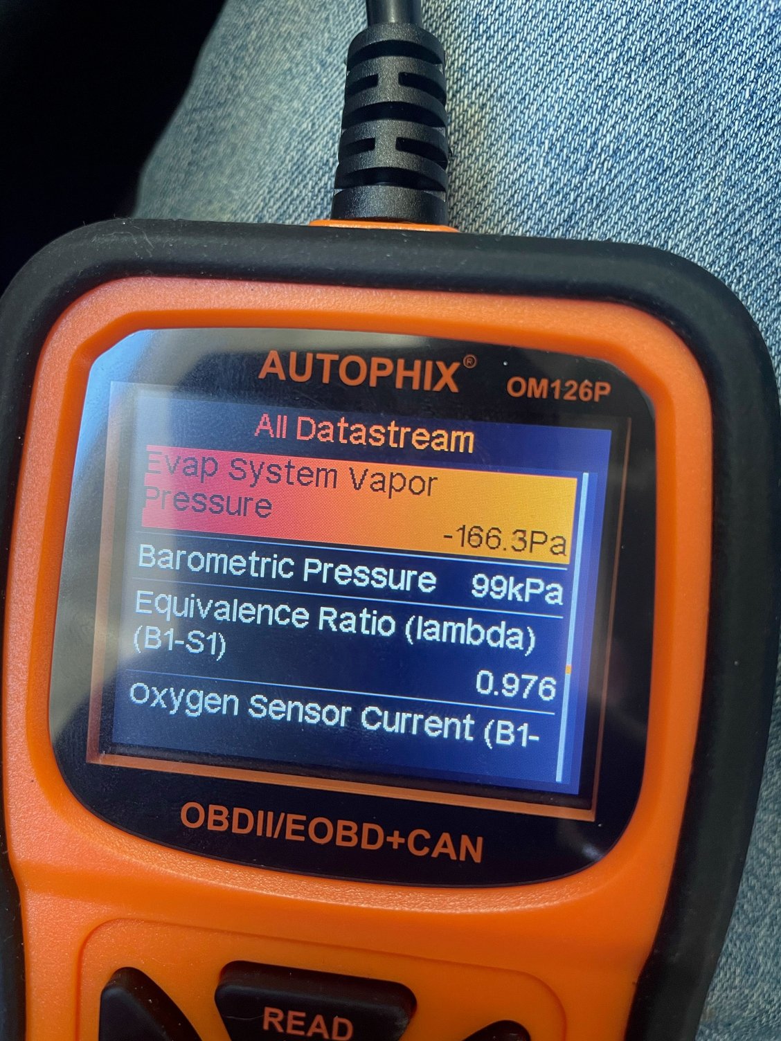

Gonna include some ODB live data...only thing that sticks out is Long Term Fuel Trim is high....but driving it today it got down to 3.5%.
I am going to replace MAP sensor and plugs and coils next as it likely needs the plug/coils anyway. Any thoughts or ideas on what to try or look at next? Or do any of these readings cause room for concern?
Thanks if anyone shares their expertise!

As for the fuel trim being too rich: could be any number of things, from dirty injectors not spraying the correct pattern, questionable fuel, insufficient air (make sure MAF numbers align for requested vs actual).

I'm not exactly sure but I think normal idle is somewhere around 600-650 rpms in park/neutral (not in drive or any kind of load). It's good the fuel trim numbers are adjusting/correcting. They are supposed to be constantly adjusting ECU parameters for a smooth idle and power delivery on demand, so it seems they're working. Hopefully a few tanks of good fuel, fresh filters, and those new plugs will make a big difference.

As an FYI.....cleaning the MAF sensor vigorously and changing the air filters has helped. I'm at 100km and no codes for "running to rich" at this time. Also w/ the OBD reader the LT-Fuel Trim went from over 10 before doing so and now is sitting around 3. Just wanted to post this in case anyone else has similar symptoms or codes and want to try the easiest and cheapest thing possible as the 1st step! I am going to do plugs and coils next just cause at 134k miles who knows if they've EVER been done.
