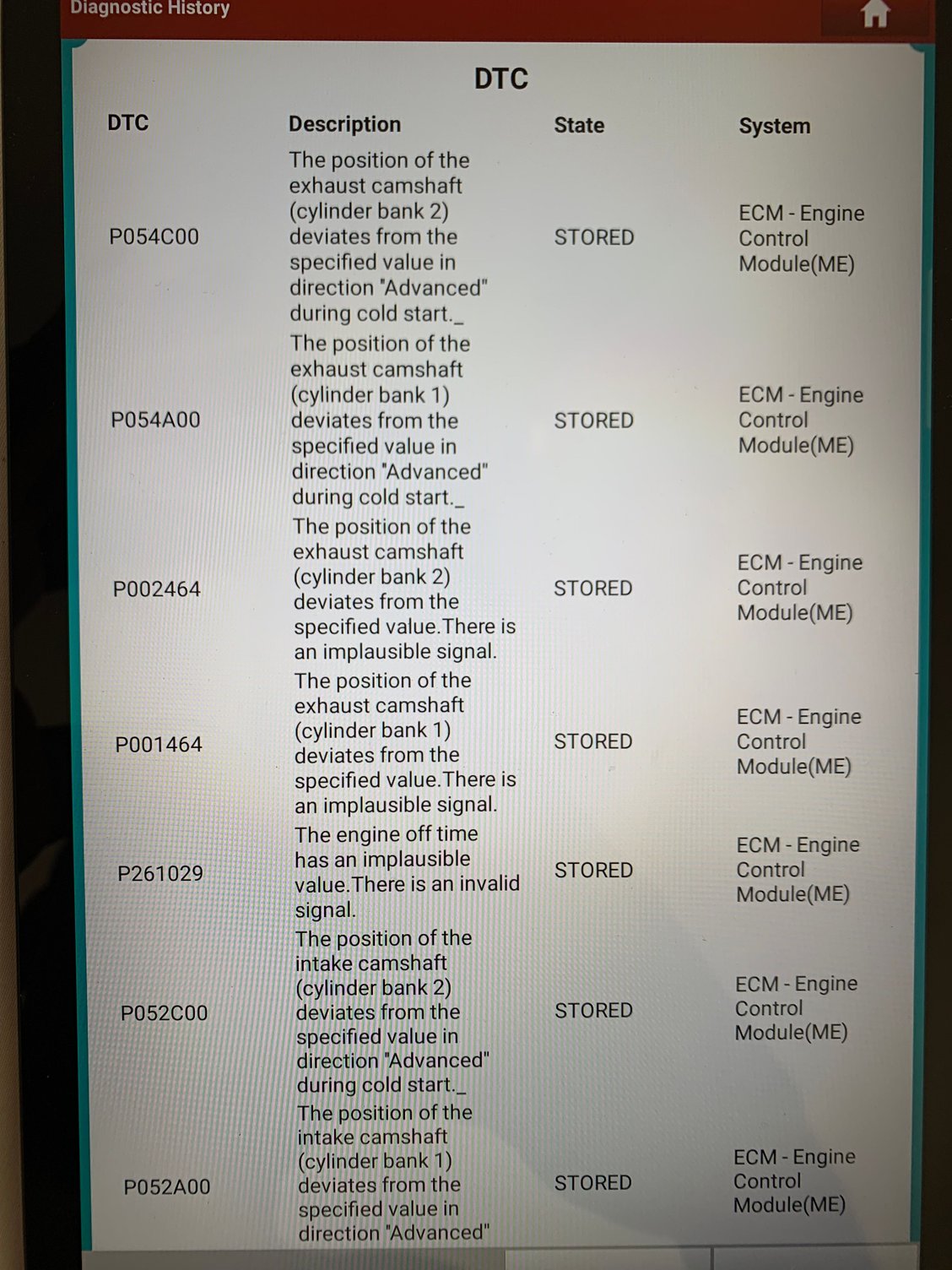

My daughter was driving her glk350 and she said while driving the car stopped working. I recalled the auxiliary battery needing to be changed so I did that. The car dash lights turn on but the car wont crank. Im heading back to scan it so i can see what its saying. wondering if anyone had any ideas where i should be focusing in looking as a start.

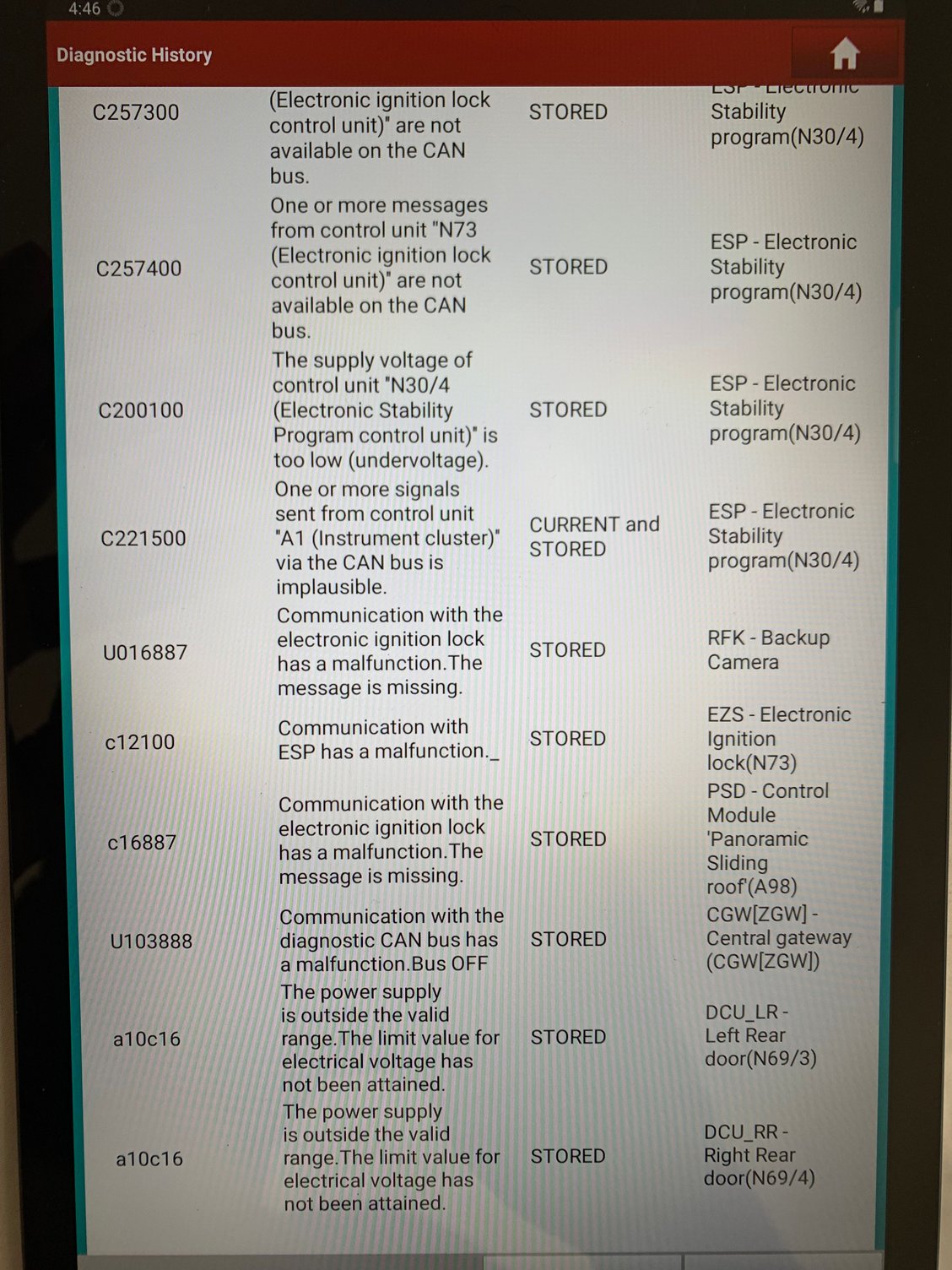

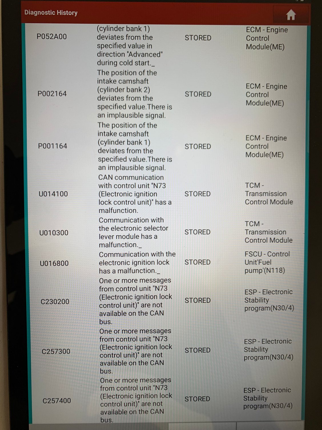

Ill ask her about the fuel when shes back. The nothing happens with the engine at all. I hear the fuel pump but nothing after. Ive done all the various servicing needed since the mechanics plan ran outl. Service C and D if i recall. These are the codes i just pulled.

Wow, that's a lot of codes. But I like the scan tool you're using, it provides plenty of information.
I think you've got a couple main issues, but bear in mind I'm no expert
Two things I know can go wrong with these GLKs (and other Benz) is the camshaft position sensor and the ESL module under the steering wheel. When it breaks, it renders the vehicle unable to start or run. There are a few how-to documents on replacing the module. When it happened to me on my C300 I had no idea what it was and got shafted by stealership for about $2500 to fix.
Read this for starters: https://mbworld.org/forums/c-class-w...lots-pics.html and a search will reveal many more threads. Suffice to say that our GLKs are built on the x204 platform which is shared with the w204 C-class of 2008-2014ish. You should be able to find plenty of info on replacing the ESL.
The camshaft sensor may not be faulty, it may just be telling you the timing/cranking was off and this was likely due to the ESL preventing the engine from starting or running. I think the order of repairs should be ESL first, then see if it starts and runs.

With so many codes, the first thing I'd look at is the battery condition and security of battery connections and related power wiring (see A10C16). Also, you may have to reset something due to the issues with the electronic locking circuitry.

I charged the main battery thats all ok. I was wondering what you meant by resetting something. I will check the wiring tomorrow
