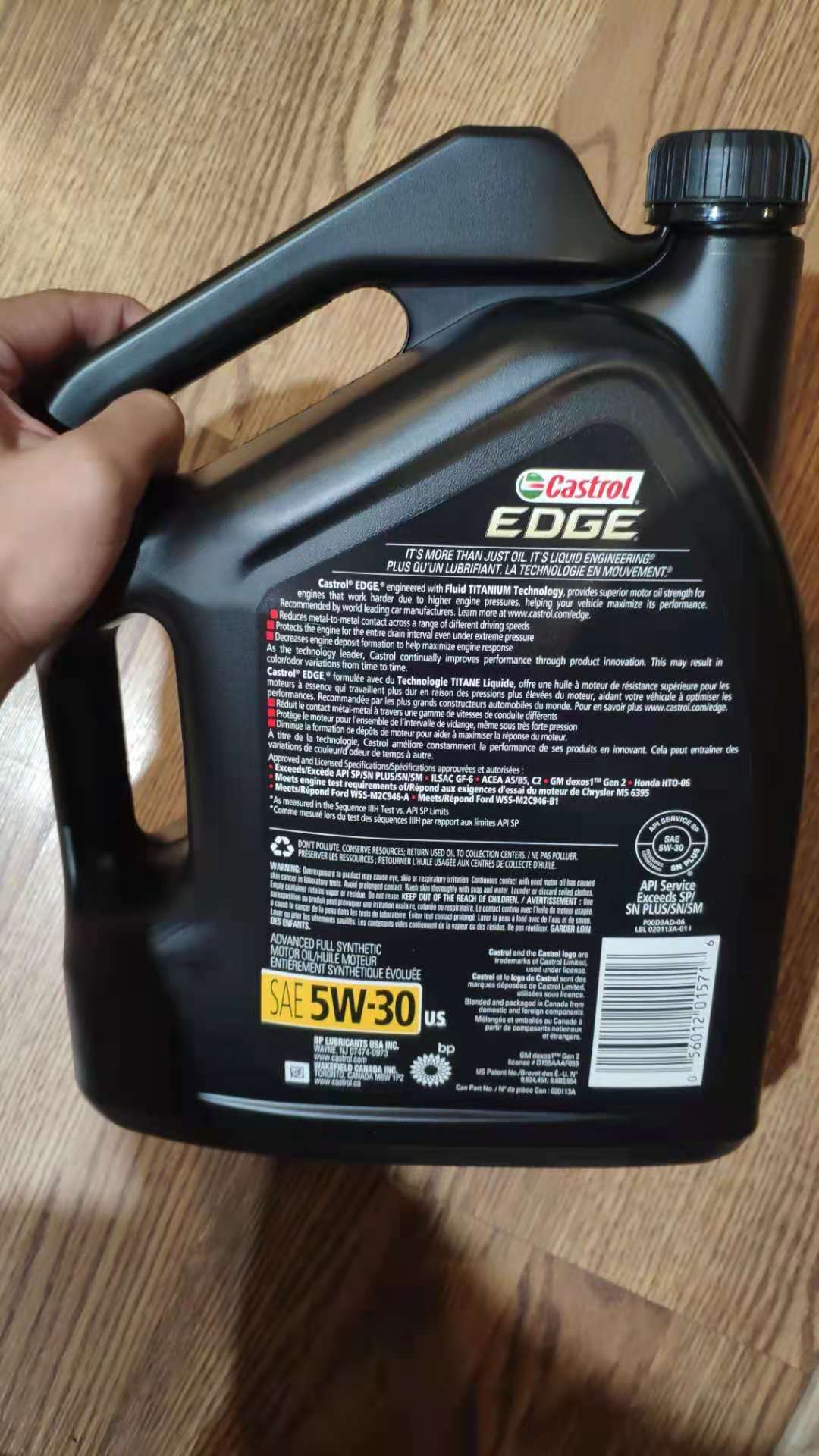

Hello friends,
I have a 2014 GLK250 Bluetec in Canada, recently I need to do some oil change, and I found a website that told me Castrol EDGE 5W30 k or m is approved by the MB (although I don't know the meaning of k and m).
So yesterday I bought the Castrol EDGE 5W30 from Costco, and then I just found that it is kind of like an America Standard engine oil, so is there anyone knows that if I can use this oil? Thank you!

You need engine oil with MB approval 228.51, 229.31, 229.51
So short answer, no you shouldn't be using that engine oil as I don't see the approval.

Looks like Castrol Edge is also approved by MB, however, that particular one you are holding isn't the right one. The engine oil has to have MB-Approval 229.51 and NOT just MB 229.51 (as an example) but the bottle of engine oil you are holding has neither.
By the way just to be extra clear: MB-Approval 229.5 is not the same as MB-Approval 229.51, your car doesn't take MB-Approval 229.5, you need MB-Approval 228.51, MB-Approval 229.31 or MB-Approval 229.51

thank you man, I just found I bought a gasoline oil, how stupid I was lol, anyway thank you man!!!!

Yeah, most Diesel oils have some level of spark ignition rating, but most spark rated oils are not rated for compression ignition. That, and the new "clean" Diesels have elevated ratings to a whole new level.
The only reason an American oil wouldn't be suitable is maybe if your car only speaks French...
You need an oil specifically rated for MB spec 229.51 or 229.52. One American oil that meets the .51 spec and is reasonably priced is Pennzoil Euro L 5W-30.
