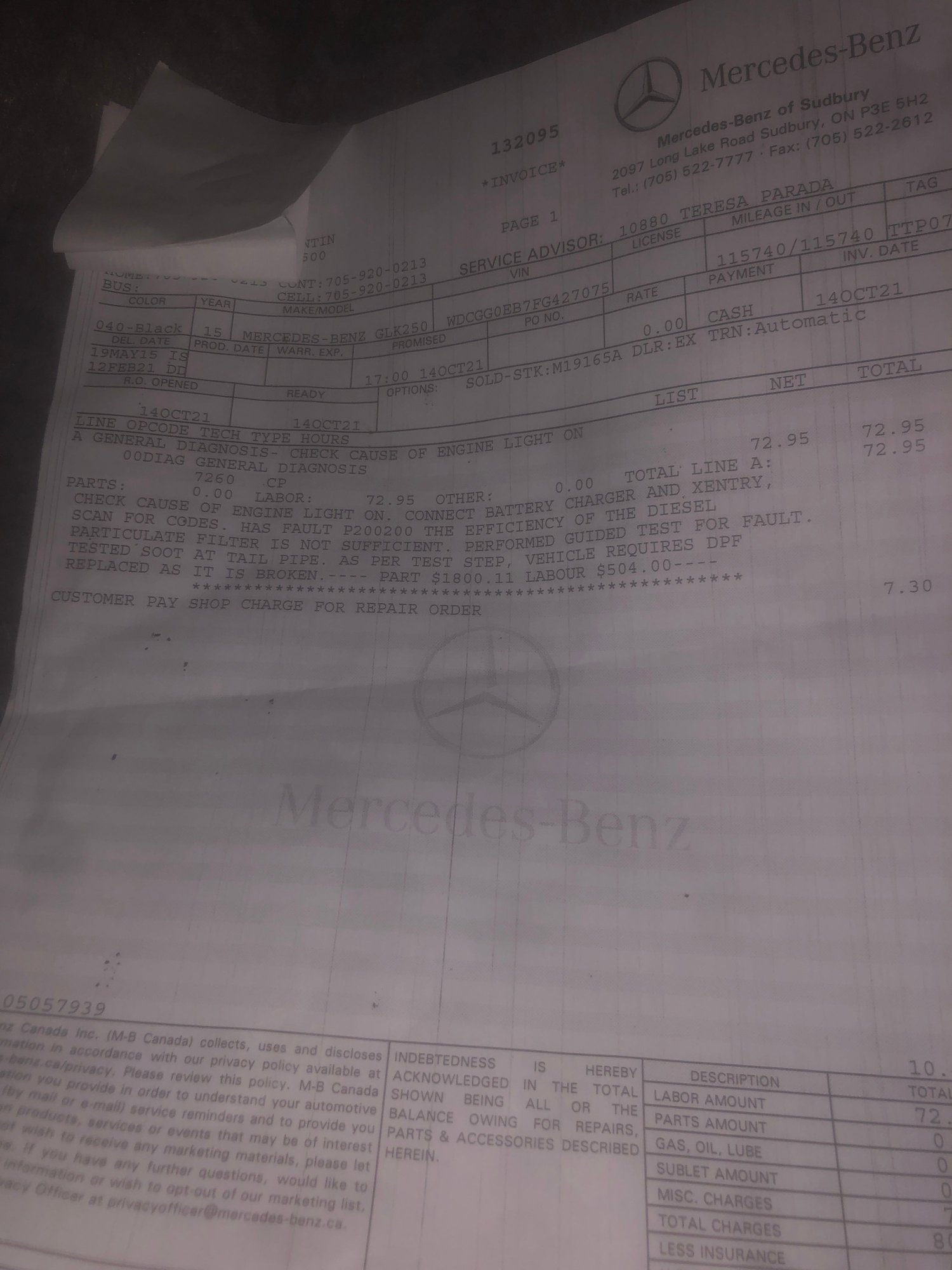

I bought a preowned 2015 bluetec GLK 250 from my local dealership in February 2021 at 108k KMs. My check engine light came on and I had the dealership run the diagnostics after they performed my A service. They told me that my DPF filter was broken and needed to be replaced. Parts and labour quoted at around 2300 before taxes.
I did some of my own research online and found out that dpf filters will clog up if they’re not able to enter regeneration mode and trigger the sensor.
I drove 20+ minutes at 100-110/kms to and from work the day after my A service. When I went to leave for work the next morning 2 days following service, my check engine light was off. I know check engine lights come off if tests are run and passed consecutively.
My question is.. could the mechanic have made the wrong call in suggesting my Dpf filter was broken?
I was quoted for around 2300$ before taxes for parts and labour. They claimed my dpf filter was was broken.

Welcome! No, your DPF is not broken; the stealership's monkeys with wrenches are usually the broken ones
Sadly, you are in Canuckistan, so there are no extended emissions warranty for you like we got in the U.S. There are a couple of threads related to the AEM approved by Mercedes for the Bluetecs, if you're interested in finding out more.
I would recommend you acquaint yourself more closely with your new-to-you Bluetec, especially by getting your own scan tool that can clear engine and emissions errors and that can also force regeneration of the DPF when needed. This will come in handy and save you many potential headaches and dollars during your ownership.
I would also recommend you find a product called LM DPF Protect (link: https://products.liqui-moly.com/dies...otector-5.html) and run a couple of cans in with your fuel, taking the car out on the highway for a good, high-speed (within reason) extended run. Diesels need to be worked hard, and these Bluetecs respond well to being pushed.

Thank you both for your replies.
So far, I absolutely love my GLK! I’m 26 and this is my first “non beater” vehicle. I take very good care of the body and baby it as it were my child lol. Any other tips are always welcome
I bought the comprehensive and high tech package for a parts warranty and I believe any mechanical work done outside of the dealership would void my warranty. I hope that was not a mistake.

It's looking good, I like the black on black.
I think it's likely worth getting a 3rd party warranty, especially on a used luxury car that would quickly become expensive to repair. I do find it odd that there's no mention of the exhaust system components.

Emissions should be covered up to 6 years, I had mine replaced for free but it was +2300CAD bill, zero paidTry Durham mb near Oshawa if you near GTA Ontario
