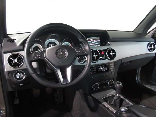

Yikes:
Originally Posted by Travelness
....Too bad they never made a manual 6 speed for our GLK!
They did, but not for all markets :-(
Old Nov 2, 2021 | 10:30 AM
andreigbs's Avatar
Joined: Jul 2012
Posts: 1,369
Likes: 319
From: WI
GLK 250
The powertrain options never allowed a manual GLK for the U.S. market, but in Europe it was quite common to get this 4-cyl OM651 engine mated to a 6-spd manual gearbox in the C class cars.
You may have to search Europe's used car part depots but you will find a manual MB tranmission for this engine, and it can be made to work but you need someone knowledgeable on both sides of the pond to make sure you have everything you need (mounts, electronic components, etc.)
