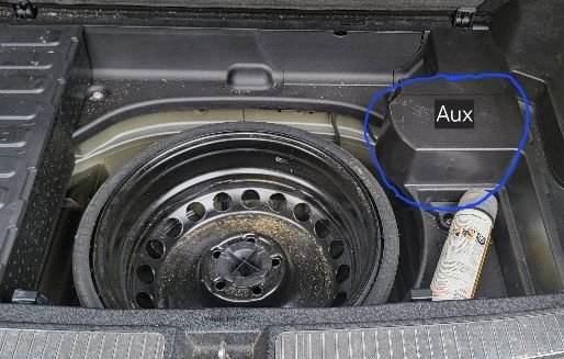

calder-cay's Avatar
Joined: Jun 2021
Posts: 1,008
Likes: 280
From: South Texas
2014 GLK350 base model (active) ; 2001 E320 base (retired); 2001 Wrangler soft-top
Originally Posted by Roger Rajah
I have 2013 GLK250 blue tech .... My auxiliary battery over 10 years old and no issues so far.
Should I replace my auxiliary battery now ( preventive maintenance) or wait for it fault message?
If I need to replace it , where the auxiliary battery located
I didn't know our 2014 GLK350 Base had an Aux battery until the message showed up on the dash.
I spent about 5 minutes researching its location ... open the tailgate, lift the spare tire "cover" - the Aux is on the right side, very obvious.
Took about 10 minutes to replace.
However, I can't speak for the 2013 GLK250 BlueTech - you might watch the YouTube posted up in this thread.
My opinion ... if you discover you do have an Aux battery, just wait for the message on the dash.
It's not like the GLK is gonna die on the side of the road when the warning shows up.
After we saw the initial Aux message on the dash, it was a month later when I replaced it

Old Jan 27, 2024 | 03:49 PM
calder-cay's Avatar
Joined: Jun 2021
Posts: 1,008
Likes: 280
From: South Texas
As I mentioned - we DO NOT have a BluTech, but we do have ECO ... anyway, I just snapped a photo (below) showing where our Aux battery is, with spare

Old Jan 27, 2024 | 07:07 PM
Bill F's Avatar
Joined: Oct 2007
Posts: 163
Likes: 53
From: Surrey B.C.
2013 GLK 350 4 matic
Did you remove all the junk from the trunk before the photo? LOL Good photo better than 1000 words.
Nope, not staged - it's looked like that (empty) since we bought it
I should, however, toss that years-old can of flat fixer, since we carry a plug kit and tiny compressor.
