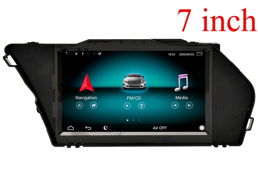

Have any of you installed these displays? Which size did you go with? I like the idea of looking at the map and YouTube on a 12.5 screen, but because it's the same 720p, it would probably look pixelated. 10.25 looks neat but on a smaller side. I wish both of them were 1080p at least.
An original dimension version
https://www.carnaviplayer.com/merced...h-screen-p-172
There's also an option for retrofitting the OEM screen, it has worse colors and no touch.
