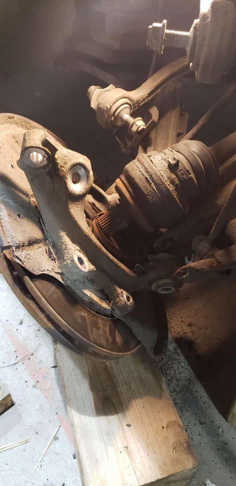

Old Oct 8, 2022 | 01:55 PM
glkoffroad's Avatar
Joined: Jun 2020
Posts: 77
glk
I had this twice. both times it was the reluctor ring. its like 25$ from car quest. u can see the cracked ring around the cv axle. its really not a bad job if u have the e torx, triple sqaure bits and big axle nut socket.
