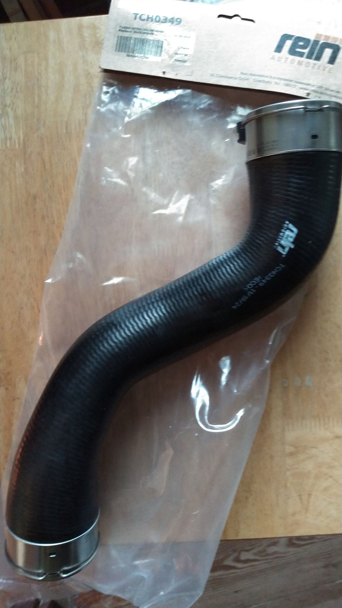

Well, as expected, it's back. This time I have 3 codes, P0299, P056E and B2aaa. Not sure if the third one means anything, but the other two seem to point to turbo control issues. Any suggestions? I'm trying to get my Scangauge to display MAP, but so far no luck.

Anyone tried the Rein hose from FCP Euro? In stock and half the price of the OE part. There's even this subtle implication: "The Rein brand includes a growing number of 'better than OE' parts for selected applications. These parts address known weaknesses and premature failures of factory parts."

My gosh 180$ for a coolant hose. I would just go the rein.

Not a coolant hose; it's a charge air hose.

Anyone have a hint on the best way to release the clamps?

Sorry I mistyped. Does the hose quality feel like a decent replacement?

Seems to be. Only time will tell...
