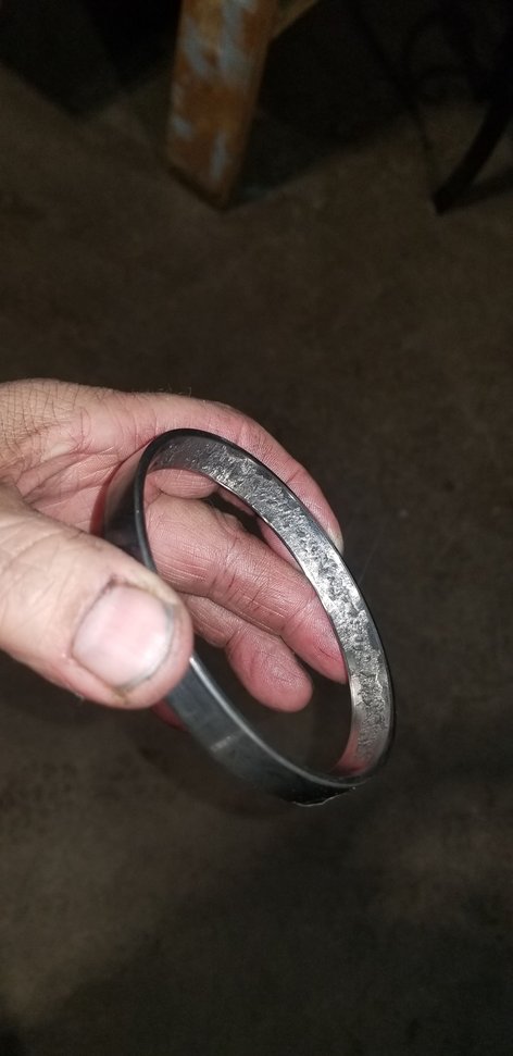

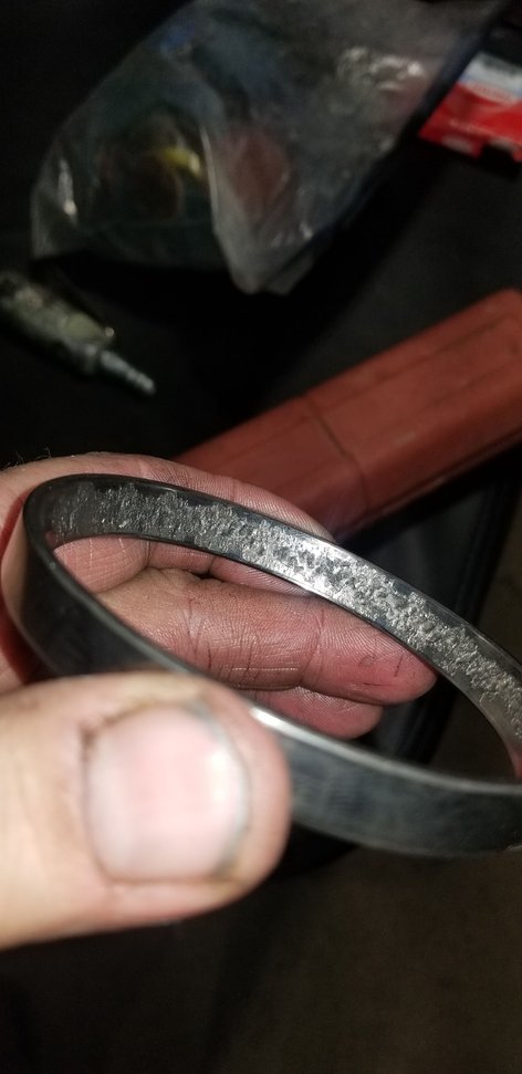

Didnt get a chance to post this yesterday but all went well, actually is a pretty easy job. Had 2 bearings that were in pretty bad condition, the front one on the main shaft up against the transmission output shaft, the second the forward one on the front drive output shaft. The seal wasnt a big deal you just need to be careful. I have a small endoscope camera I used to get it lined up, pulled the camera out and slid it home. Easy peasy.
I'm kind of disappointed in the design of the front output shaft design. The slip yolk sh ou old be on the front joint and have enough travel you can remove the driveshaft, and the seal sh oki uld be external so it can be done without tearing down the transfer case. But, it is what it is.

Those bearings don't look that bad....
