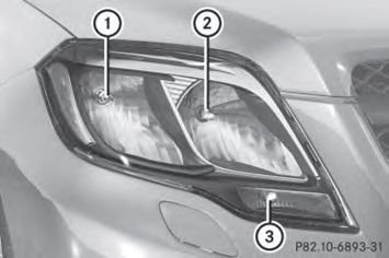

Also, in the main headlights (non-HIDs), what are the lights next to the low beams? I know they're high beams, but when the high beams are off, the bulbs are on and dim. At first I thought this was the DRLs, but eventually figured out the LEDs are the DRLs. So what is the purpose of the dim lights in the high beam location?

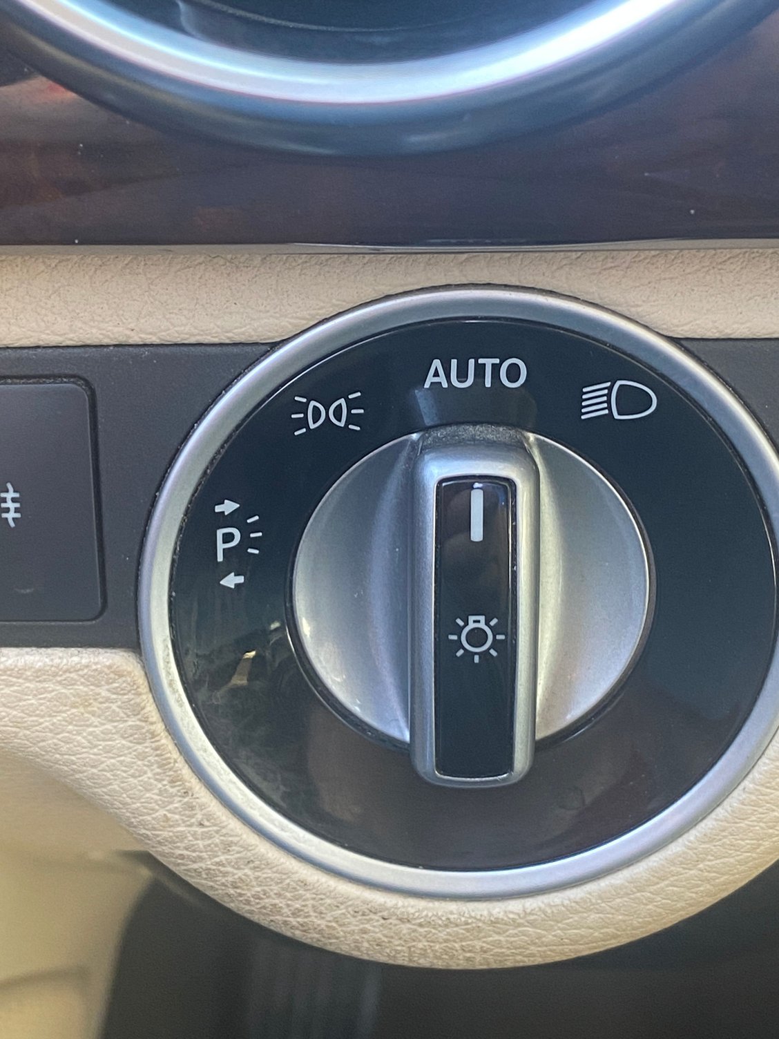

The drl and low beams should be on at night, I don’t think you have the selector set properly , experiment with different settings of the big dial.
I think you have the parking lights on, which is no real illumination, but my 13 had the worst lights I’ve ever had in a car,

The high beam bulb also has a separate parking light filament.
I'd leave the headlight switch straight up and forget about it.
Halogen headlamps
1 : Low-beam headlamp: H7 55 W
2 ; High-beam headlamp/parking lamp/
standing lamp: H15 55 W/15 W
3 Turn signal lamp: PWY 24 W

Proper position for DRL and low beam together

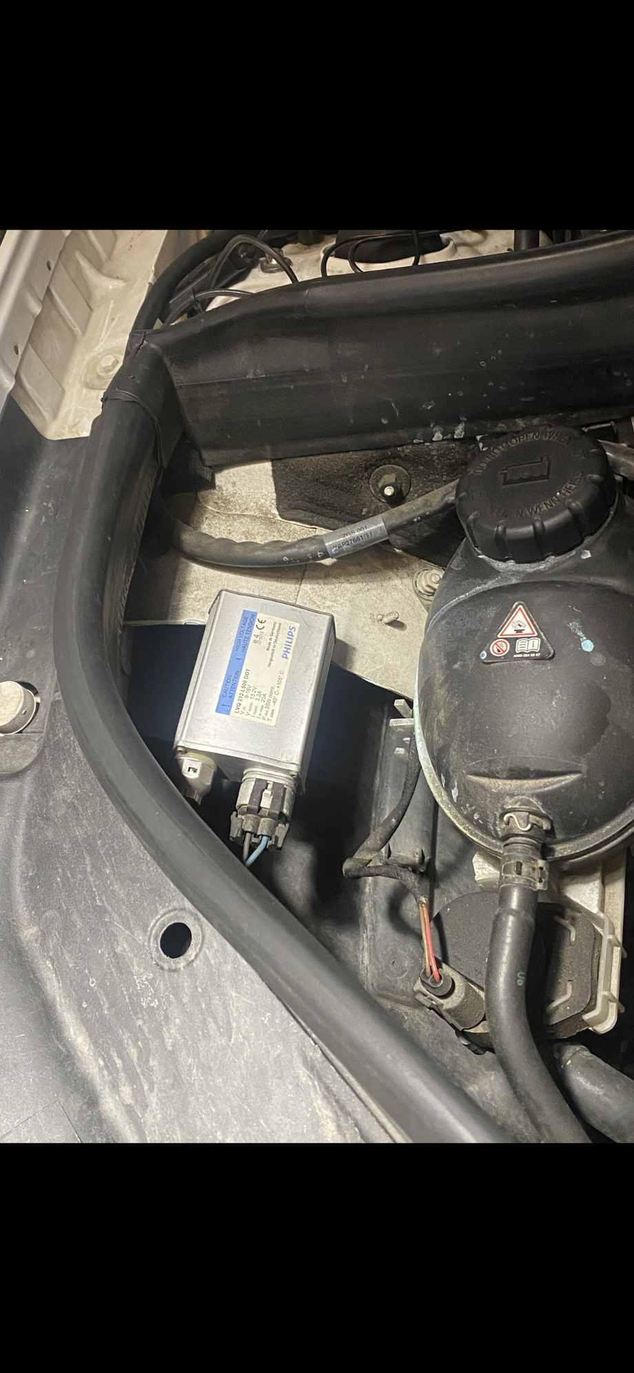

It is a kit , I bought a Phillips Hid 35w , I think 5000k kit. Two replacement bulbs and two ballasts. The kit was maybe 150$. I paid about 125 for the install years ago. But a warning , the ballasts need to be mounted low or when uou shut off the motor they heat up from the engine and may not light until they cool down. The bulbs will last as long as your vehicle. Google or YouTube it. I think mb installs the ballet in the front quarter way low. I’ll look for before after photos of change. And you must aim lights all the way down . Light output with a 35 watt bulb is 2.5x more than the 55 watt halogen you have now

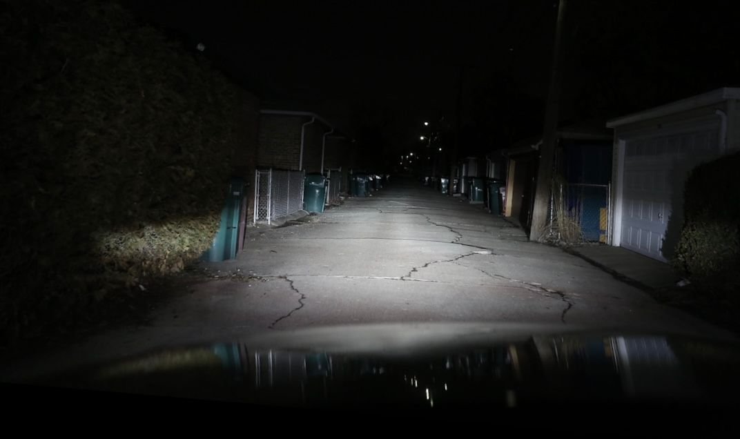

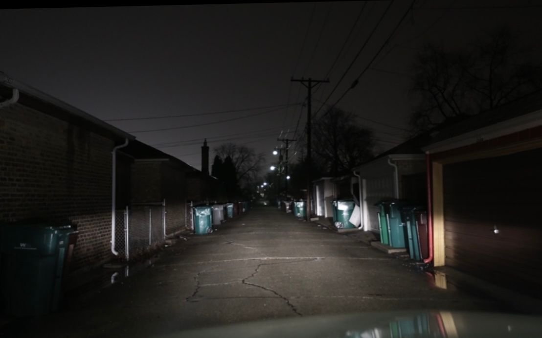

Bottom are mb 55 watt halogen, notice how high mb set them, just lowering them put more light on the road. Top are 35 watt HID 5000 kelvin, Phillips. The photos are not exactly as it looked.

So, only the low beams, right? Do you get an error from them? I don't think my lows are as good as the second photo, and I have 100 watt bulbs in there. Maybe they're aimed too low!

I only have low beam hid, both photos are low beam. The bright photo is 35w hid low beam. The stock lights are the worst I’ve ever had, and I’ve driven things like Camry , Volvo , blazer . For being mb you would think they would be great. But the Glk 13 stock lights are worthless. I upgraded just to see potholes. Now I see them ! You do need a Canbus Hid. Philips is the only company I know if that has it in one unit. Most companies sell the Canbus separately. Never a problem or code. Only mine are mounted to high and get to hot in summer and have failed until cooled down. They need to be mounted low. There is a Philips kit on eBay for 150 now.

I would recommend going to your local stereo auto store and ask them, and let them put it in . Then you have a warranty. Car stereo shops wire cars all day long. What they sell you they will warranty . I might be switching out my ballast to a different brand that is heat resistant, or I need to get it lowered down so it doesn’t heat soak and fail, when I stop somewhere. If you’re in Chicago ABC automotive is good.

FWIW, I prefer the halogen beam pattern of the two photos. Lighting the road surface immediately in front of the bumper is nice, but has no bearing on being able to see where you're going. In fact, bright lighting in the immediate proximity to the vehicle makes it harder to see "down-range", which is really what "better lighting" is supposed to be about.
It also appears that the HID messed with the pattern in terms of what's shining above the "cut-off" (a relative term when used with non-projector lights, but you know what I mean). The halogen photo shows a fairly distinct cut-off of light above the designed pattern.
I've read the same from many who've installed HID lights in halogen headlight (aim them down, and they light up the road better) but the end result is the opposite of what I was looking for when I upgraded my (projector, thankfully) headlights.

My ballast is mounted to high and overheats . I don’t know if it is normal or defective
Reply 1
