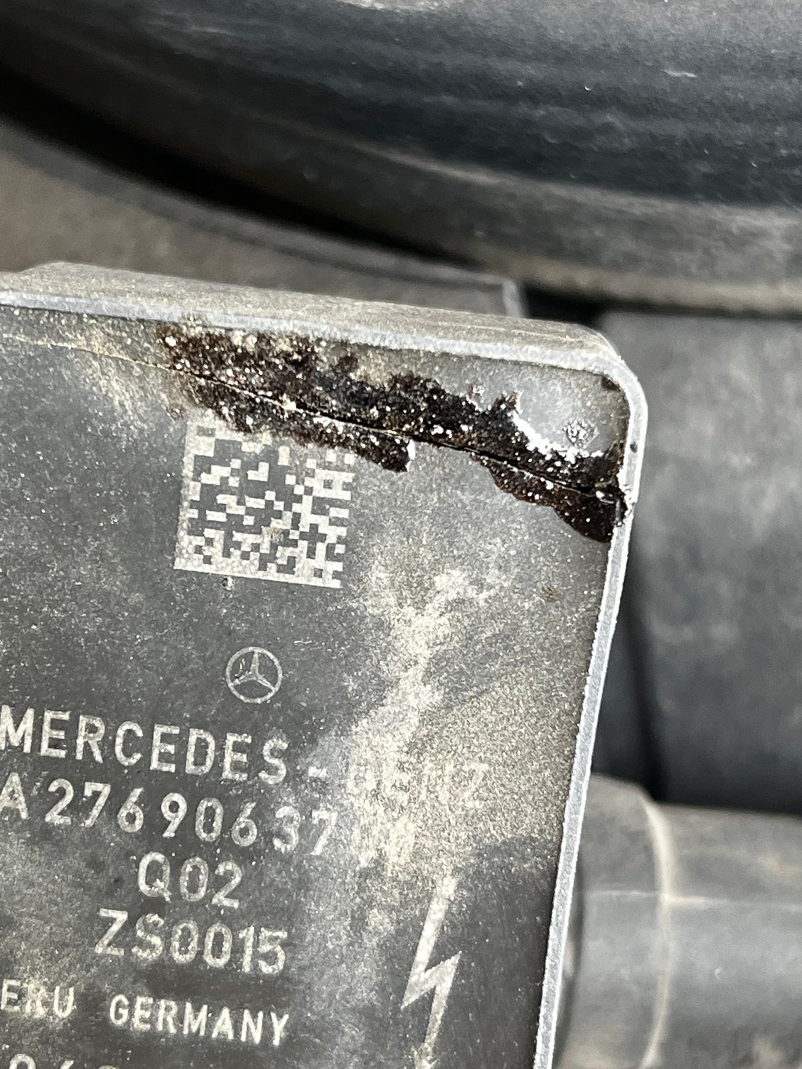

Habby, I must disagree about the MB / Beru factory coils. I had one fail catastrophically, literally burst, arc out and disable an entire cylinder bank. Shortly after I sorted that mess out a second factory coil failed in less dramatic fashion. I do agree that the spark plug job is Very laborious and "tricky" due to space concerns. If I had proactively changed out the coils when I did the plugs(Bosch) I would have avoided the subsequent coil failure episodes. I switched to the upgraded Bosch units, not costly, from FCP Euro.
I also agree absolutely stay away from obscure off brands. Its not money you save its money you don't spend today...
