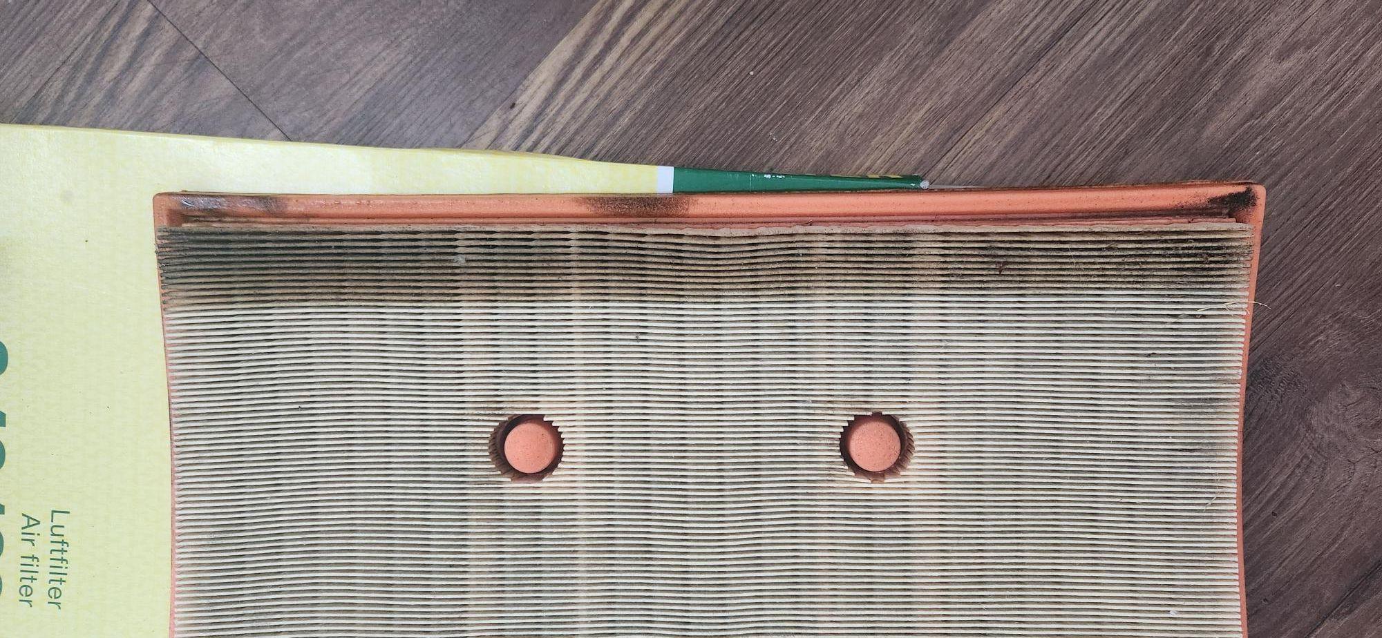

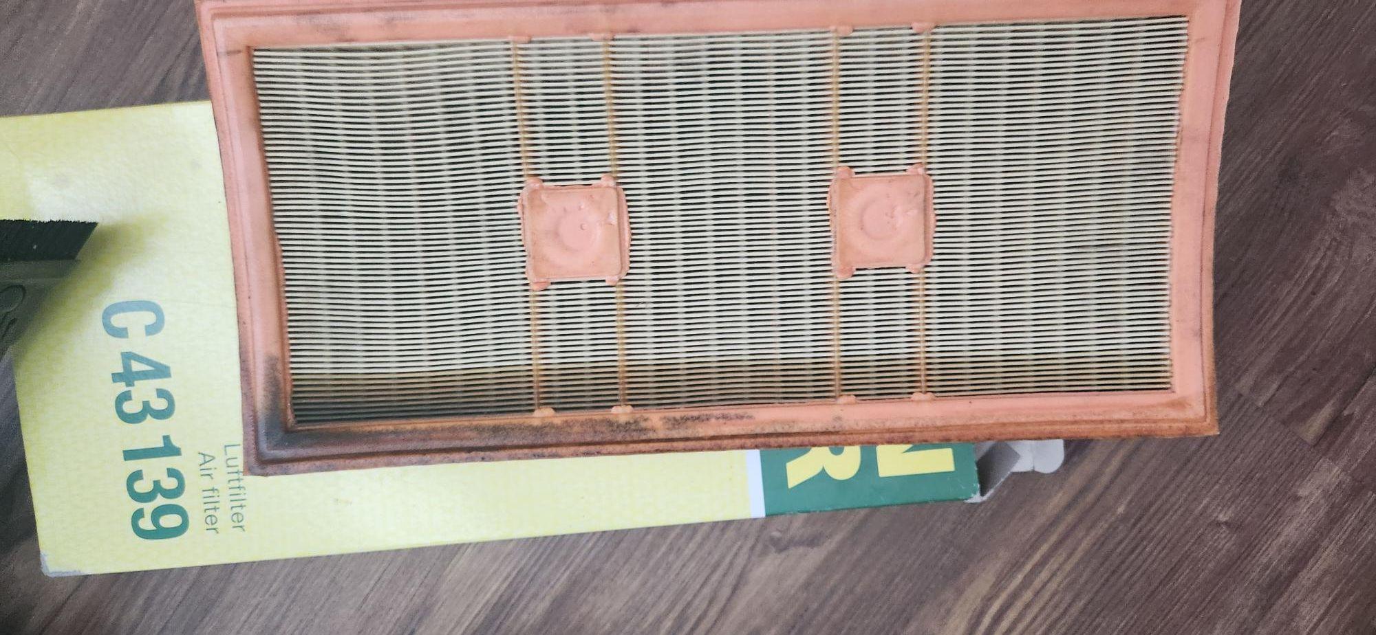

I'm posting a photo of the old air filter with oil because I changed the filter yesterday and cleaned the filter holder case.
I must add that in the link Mmr1 posted, they mentioned that the oil would fall on the alternator, and it did. There were no leaks or oil on the engine until I opened the filter box. I saw the wet filter, and after that, I checked the air filter box holder, and the oil had accumulated in the lower corner close to the radiator.
There was quite a bit of oil because when I tried to clean it, it spilled on the alternator and part of the chassis. I sprayed Simple Green on the engine, chassis, and alternator to remove some of the oil. I hope I don't have any alternator problems later on.

That’s a lot of oil on the filter and it looks maybe original . Did you test vacuum or try lifting up on the oil cap with motor running to check PCV , it’s like a 5 hour job to replace it.

Yes, there was a lot of oil on the filter box. I assume this was the factory filter, and nine years later, with no maintenance, it probably accumulated a lot of oil.
I'm not sure if you read the preview post about what the mechanic said and the similar post someone posted here saying that this was a common problem and I should not worry about it?
The mechanic has the car, and I will get it back to you later today.
