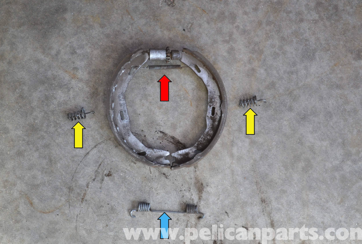

Yes, theres parking brake shoes in each rear wheel.
Should be drum type pads inside the rear rotors. Pull the cable and a spreader spreads the two pads out to contact the inside surfaces of the rotors.
I worked on my W204, which should be similar to the X204, with basic tools. screwdrivers, pliars etc.
heres a Pelican parts article on the W204, should be similar to X204: https://www.pelicanparts.com/techart...xnoq8gNawuRkJ9
How does everything look under the car back there? All mine was severly rusted so alot of work, replacement was needed.
Can always try removing the wheels then squirting some lubricating oil on the parking brake pad springs and the spreader. jack up the entire rear so you can spin the rotors with the wheels off, try and align the wheel bolt holes so you can spray the springs. When I worked on mine the spreader was so rusted it wouldnt move properly, had to replace.
The spreaders will be on the opposite side of the calipers on each wheel.
The manual says to grease everything when replacing. heres a link to replacement procedures: https://charm.li/Mercedes%20Benz/201...20Replacement/
The blue arrow spring is the one at the spreaders. Does most of the closing. The red arrow is the adjuster side.
