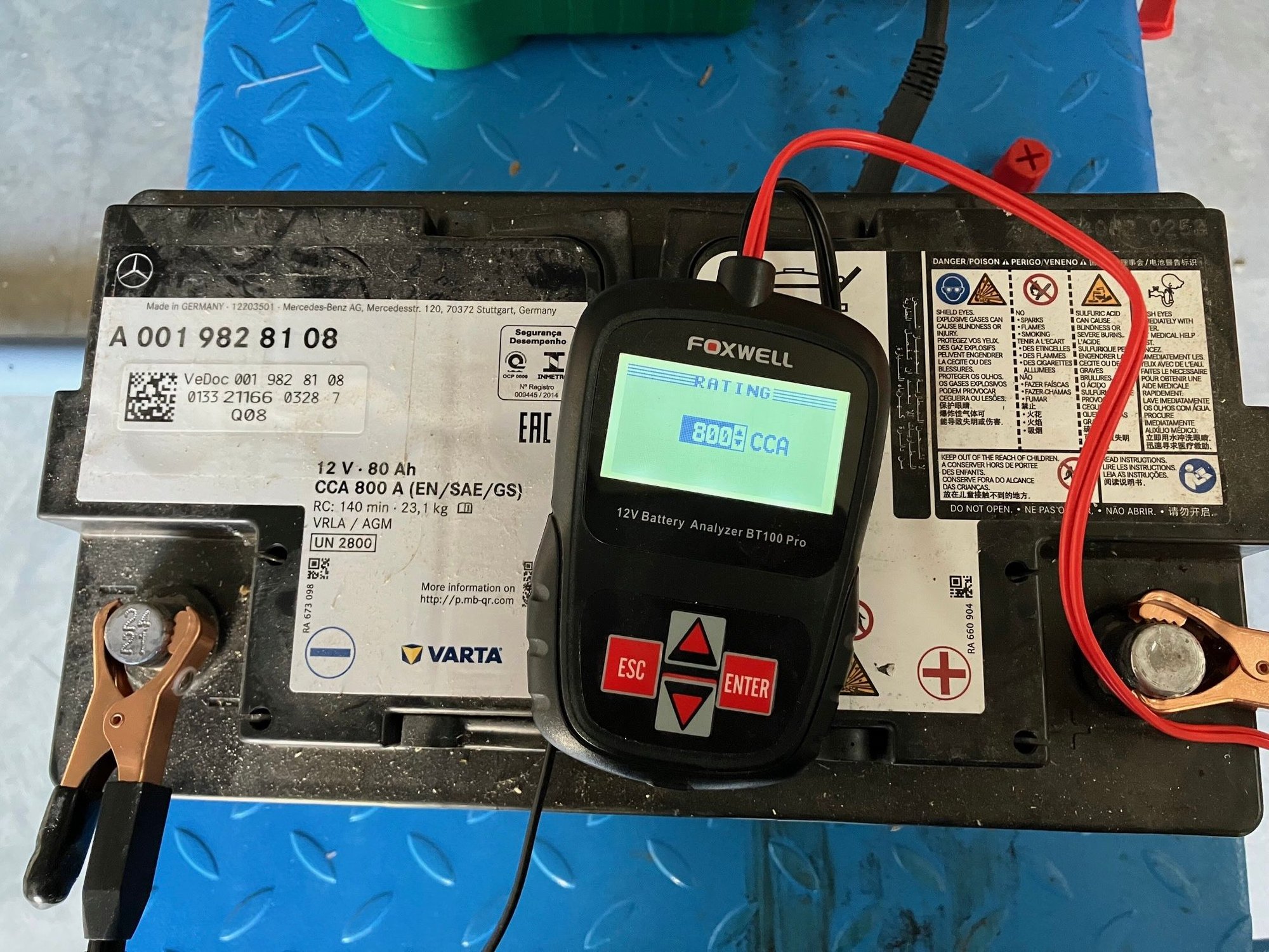

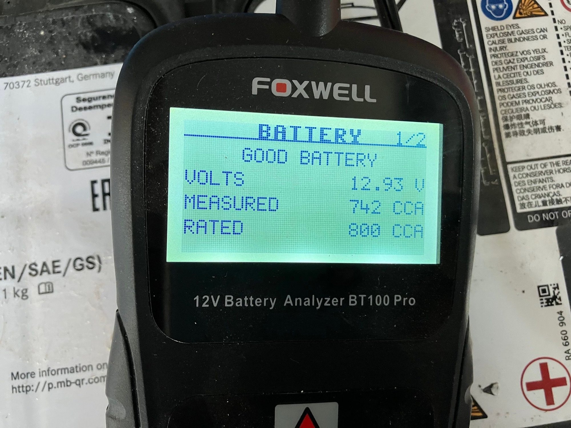

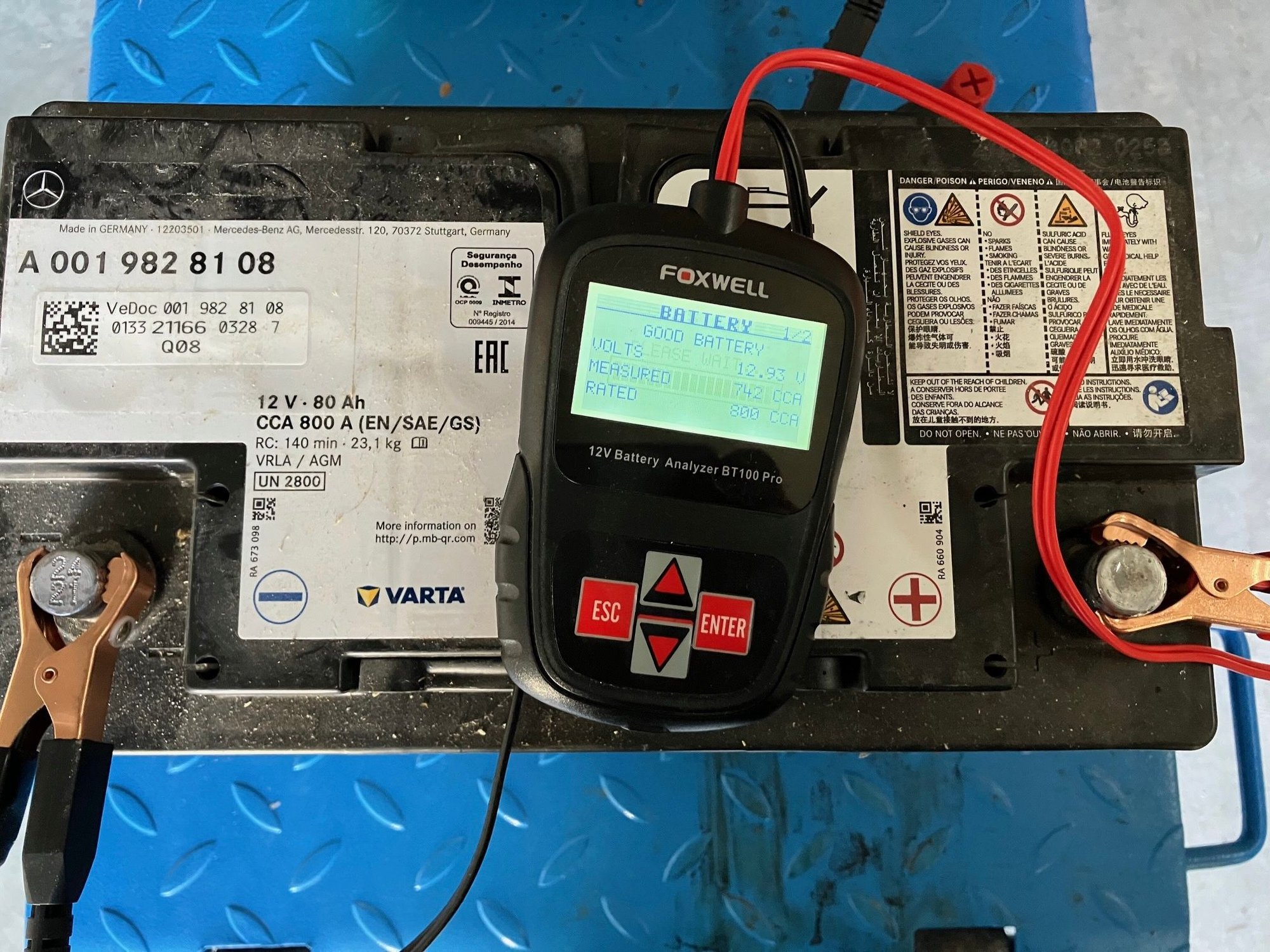

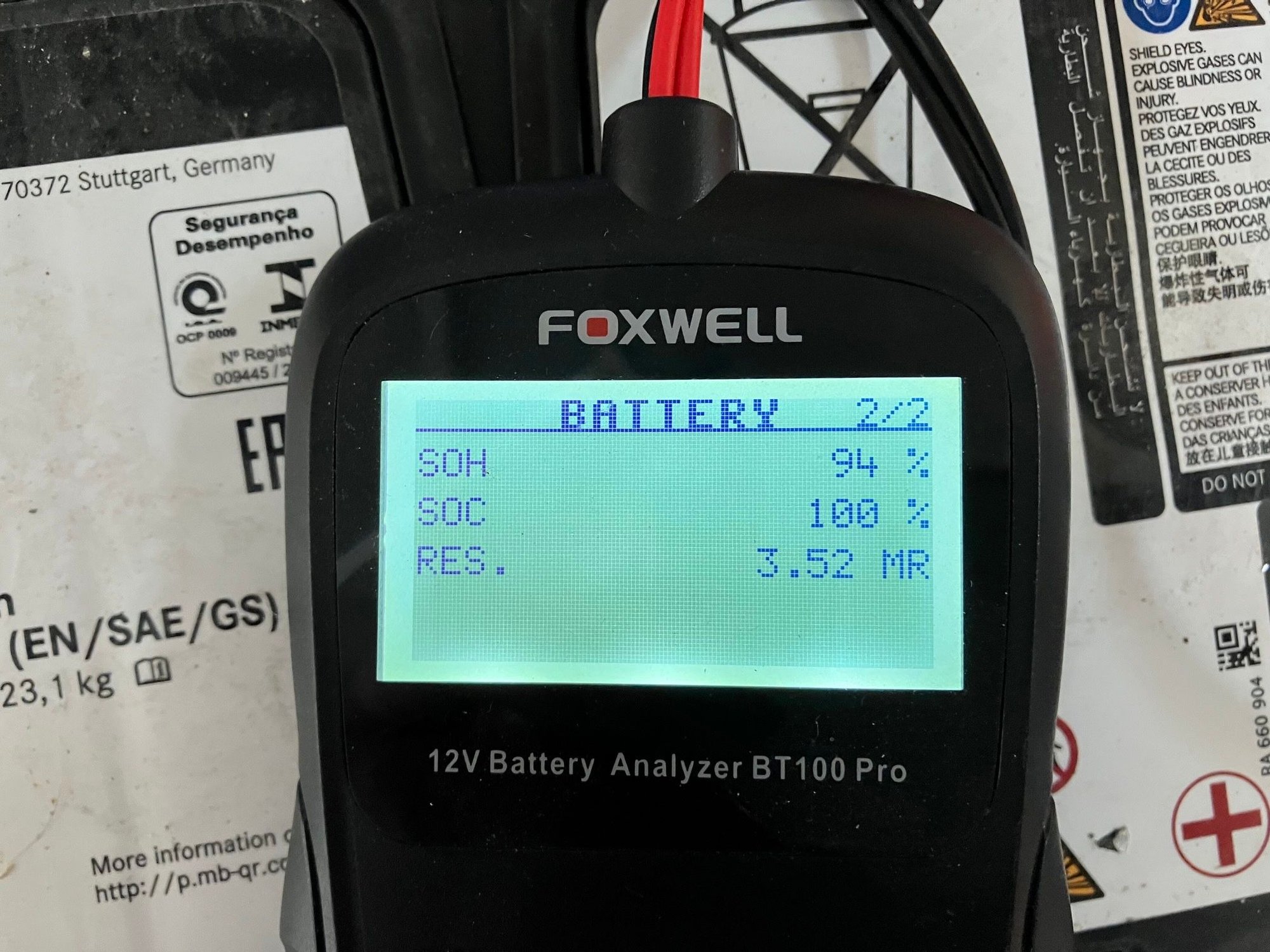

New GLK battery that I bought two or three years ago but never installed. Looks dirty because it sat on my garage floor those years. These test readings are after charging 24 hours on an AGM charger.

Even older than that! the numbers stamped on the negative post indicate it was manufactured in the 24th week of 2021.
now I wonder if it would have measured ~800 CCA if I had checked when I bought it.

It goes to show that care and good feeding of your battery will result in a long and productive life.
