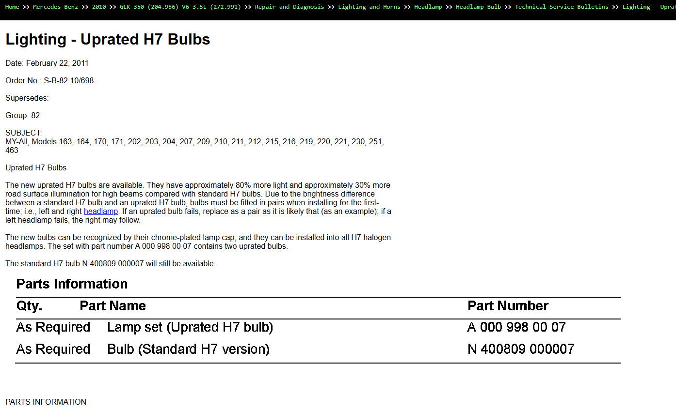

What type of bulbs are in there, regular H7? Black plastic thing? Are you trying to remove the high beam, theres a version that has a large plastic holder.
First time driving my W204 at night and i could not believe how bad the headlights were, I felt it was dangerous with how dim the road ahead looked. I searched online looking for the brightest H7 replacement bulbs I could find being sold at the time and ended up getting a set of Osram Nightbreaker Unlimited. When I went to swap the bulbs out I noticed that the Silverstar Ultra were in there. I did install the Nightbreakers and did not notice a difference at all.
I noticed Mercedes has a bulletin for upgraded H7 bulbs which from my research are just Philips X-treme Vision bulbs.
I ended up installing a can bus type hid kit and that completely solved the low lighting issue. If I were to just install H7 bulbs back in I would probably go with the latest nightbreaker bulbs.
