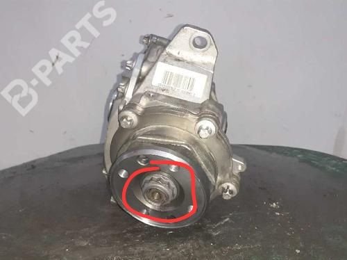

Hi how you guys doing? I really need some help i was wondering if there's people who knows what's the torque spec on the nut circled in red for glk 350 2013 please ?
Might consider looking for a torque clue in this thread, possibly Reply 4

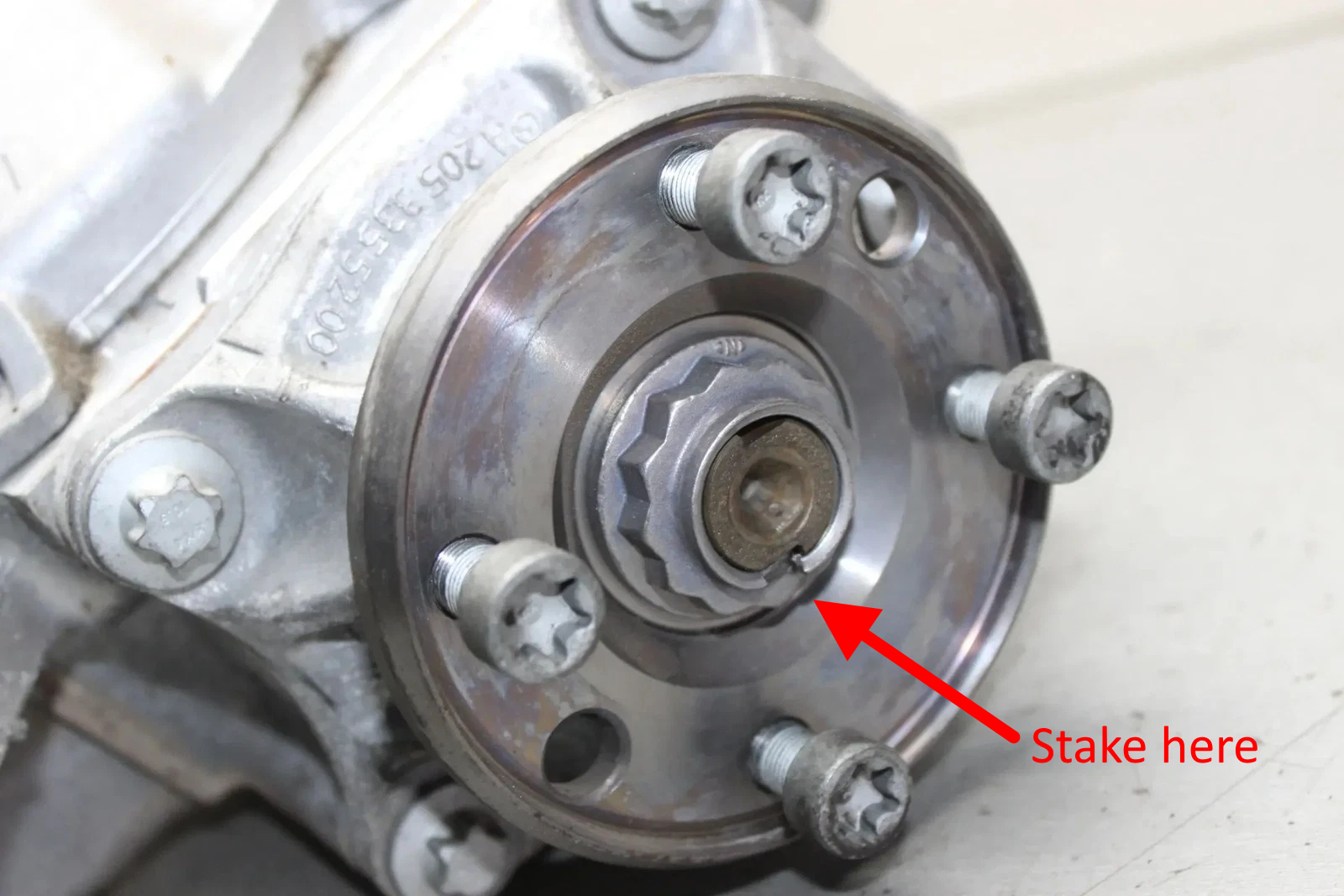

The A2213530372 nut is torqued to 100Nm (roughly 74 foot-pounds) with no thread locking. I am seeing it as a twelve sided 30mm socket size.

Also note you need to counter hold the flange when applying the torque. Once the nut is on there you will need to stake the edge into one of the two available the cut outs.
