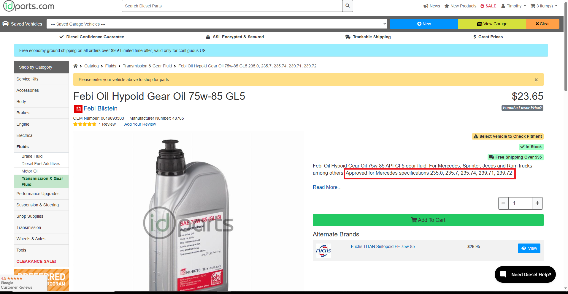

The Febi brand fluid is the same fluid I used for the front and rear diff in my W204. Its on the approved spec list and even has it printed on the label. I found it at IDparts which happens to be in the next town over from me so I can pick up my orders for free. When I did it the fluid was around $18/each but the price has gone up since then. 2 bottles was plenty, something like 1.1 quarts for the rear and the front was around .7 quarts.

Jusy FYI, that febi bottle isn't approved anymore for any of those specs. The Fuchs is on some of those approvals.

Odd. I looked on the Febi website and the spec is still listed. The bottle I have has the spec number on it though it is a few years old. I'd use it again if the new bottles still have the spec listed. May replace the fluid again this summer just for fun.
