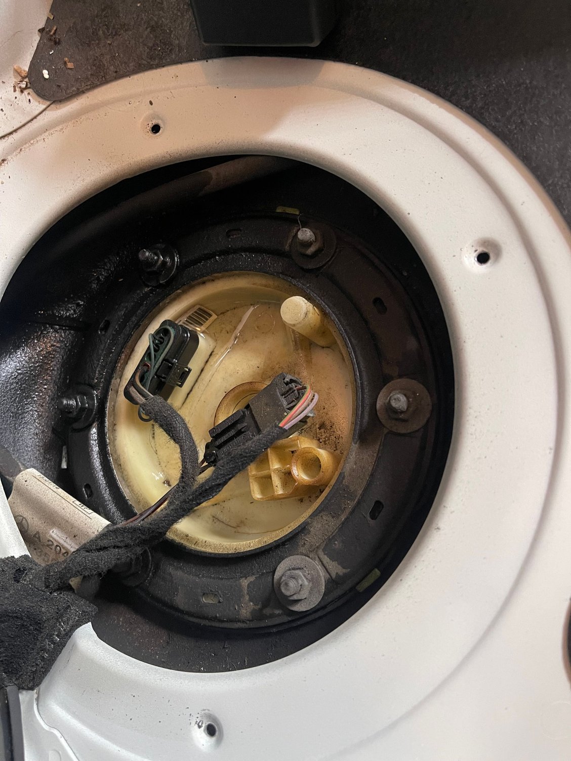

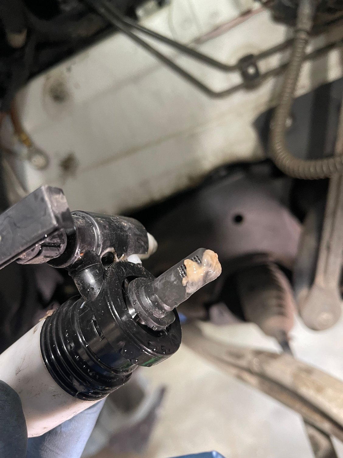

Washer fluid pump and fuel leak
I bought a new washer fluid pump at Autozone on the way back home from a swim meet with my daughter this morning. I wasn’t sure I’d need it, but they had one in stock so I grabbed it. I had to pull the front driver’s side wheel off to get at the pump. The wheel-well cover (whatever it’s called) was a bit of a pain, but I got it off. I put a bucket under the fluid tank and proceeded to pry the pump out. Turned out there was some gummy, orange moldy crud plugging the filter
The filter is flexible rubber, and doubles as a seal between the pump and fluid reservoir. I was able to clean the filter and flush out the reservoir. I reinstalled the pump and tested with some water, and it sprayed perfectly. The pump itself is a tiny impeller pump. I pulled the pump out again to make sure the filter was clean, drained the water, and put it all back together. I’m a big fan of anti-seize compound so it went on the lug bolts, points of contact on the back side of the rim, and under-car panel screws. New pump will be going back to Autozone, I’ll spend the $40 on something else.
I also pulled out the back seat to get at the fuel tank. The cap behind the driver’s seat was bone dry, no sign of leaking. The passenger side plastic cap had a pool of fuel on top.
No sign of cracking or breakdown on the cap, so I ordered a new gasket from FCP Euro.
Checking things off the list way faster than expected. This car really is a joy to work on.

I think I’m going to start a different thread for other items. Transmission is shifting like magic! Just replaced the fuel tank gasket. The old gasket was hard, and there was some corrosion that was likely interfering with the seal. I have not filled the tank to see if it actually seals.
