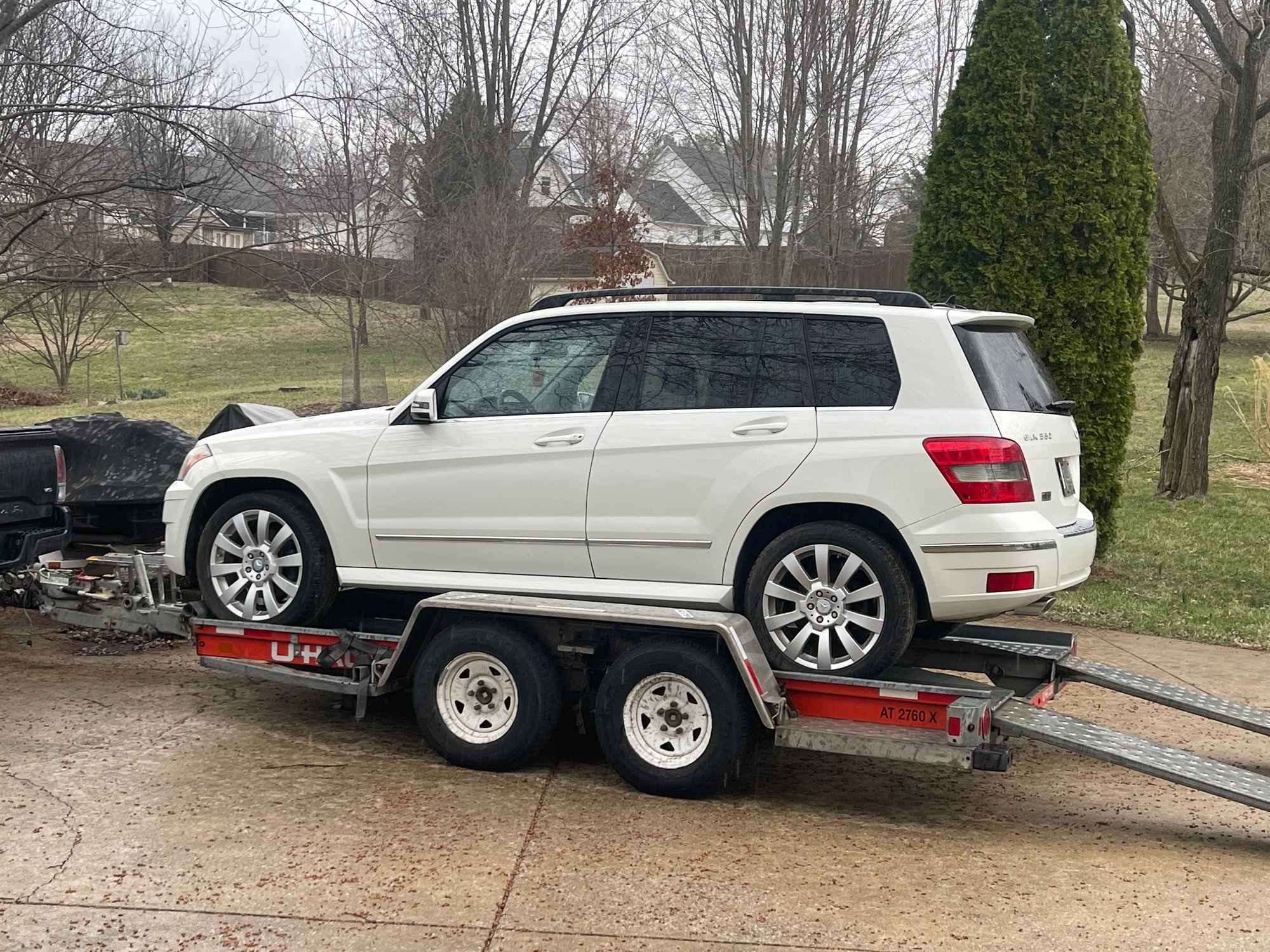

Just picked up a 2010 GLK350 4-matic as a project for my daughter and I. Mileage is around 150k, PO says a European specialty shop said it needed a new transmission. Body and interior are in very good condition. I don’t like bodywork or upholstery, but thrive on the mechanical stuff, so this was ideal for me. No signs of major leaks under the hood. Engine oil looks and smells OK.
I haven’t had any experience with transmissions other than changing mounts and fluids, but I’m excited to dig in.
It’s been a while since I’ve owned a MB, my last was a 2001 E320. Loved the car, but needed something better for midwest winters (went with BMW x-drive)
Super excited to dig in and tap into the throbbing brain that is this group.
Safe at new home
Safe at new home

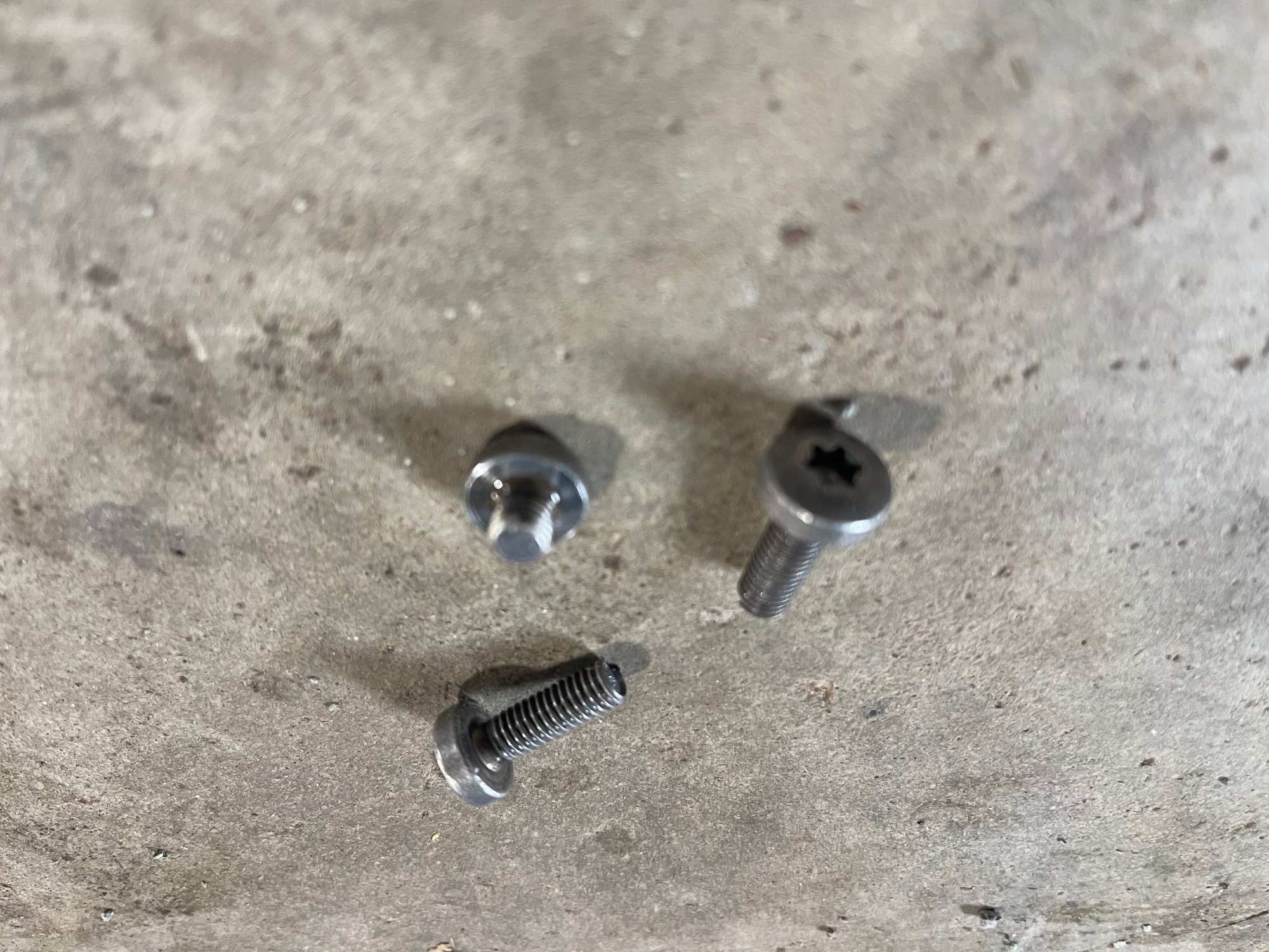

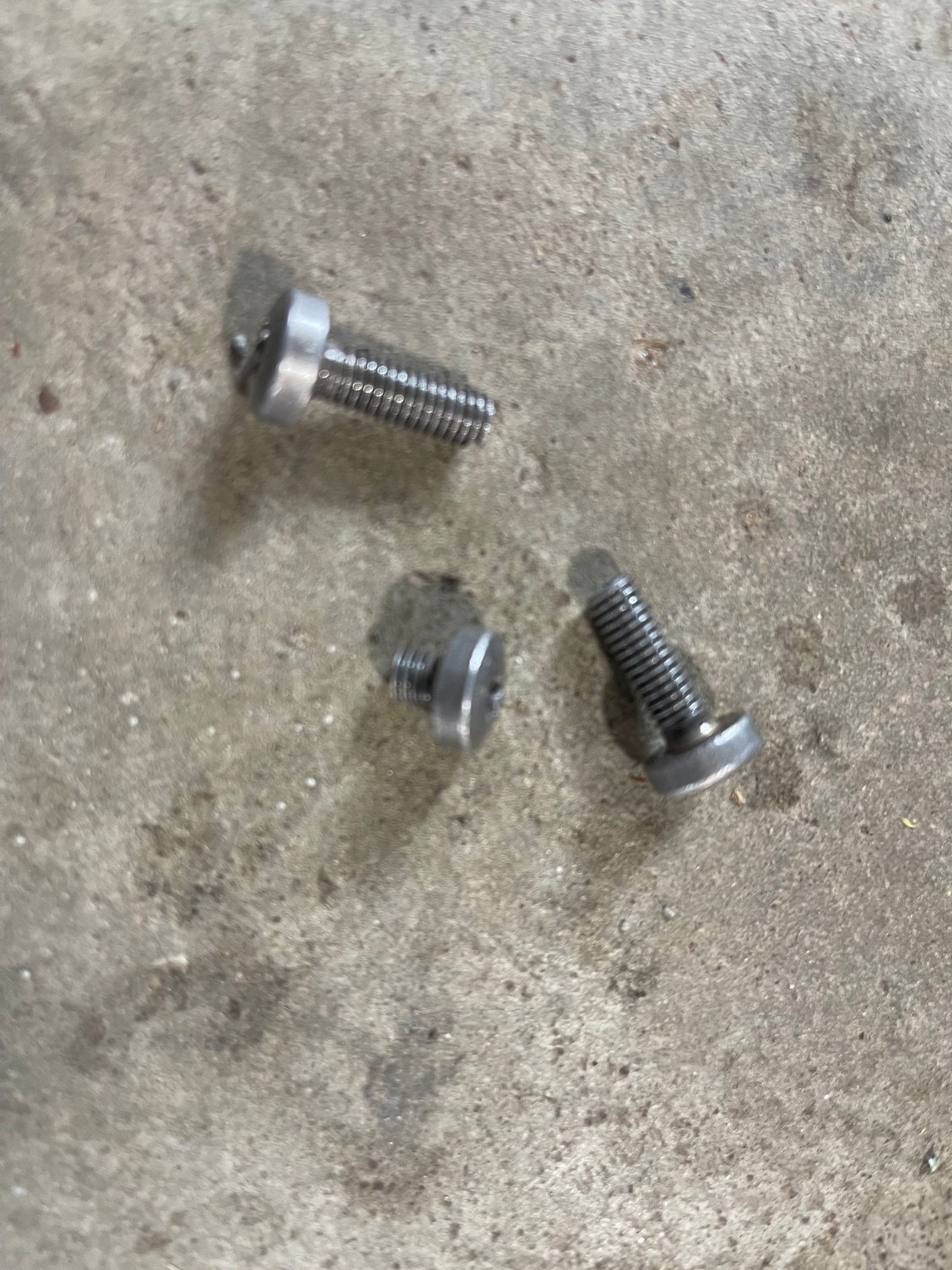

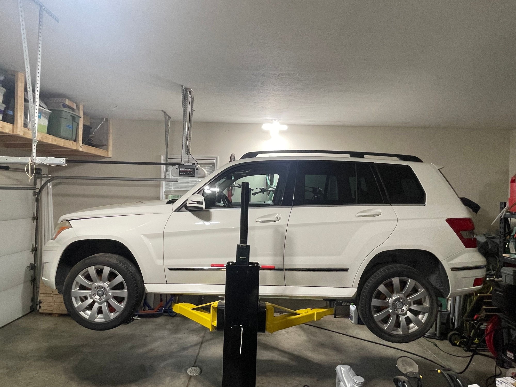

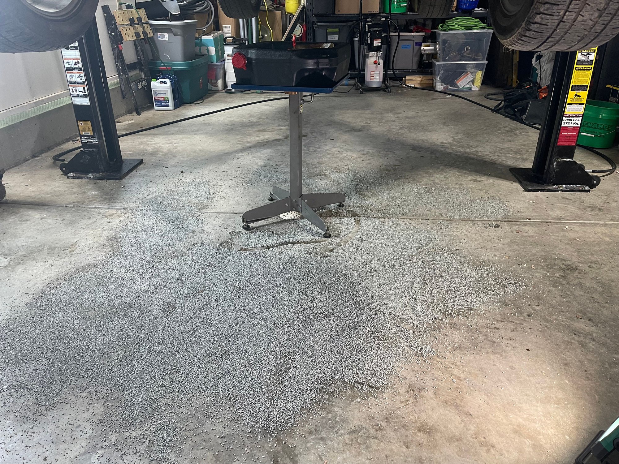

Dropped the pan…the plot thickens
I finally got my son’s BMW off the lift and got the GLK in the air and drained the transmission fluid. Surprisingly not bad looking or smelling. Definitely a brownish tint, but does not smell burnt or otherwise bad. No visible metallic shavings, or glimmer. Next step was dropping the pan. Messy job to say the least. I wasn’t sure what to expect, but it was definitely not this. 3 aluminum bolts with torx heads. 1 is sheared off, the other 2 appear complete. Bolts are around 1” long.
Lots of absorbent on the floor. As I sit with a beer and wait for the mess to clean itself up, I wonder what other surprises await.
Any ideas on the bolts? I would completely understand one or two 10mm sockets in there, but not bolts.
