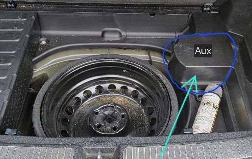

Originally Posted by Thguns
Do all of these have an auxiliary Battery?
because I’m pretty sure I do, just can’t find it. Checked in rear where spare is located ...
Our Aux is in the back with the spare. Here's a photo of our 2014 GLK350 Base rear trunk /spare area. I'm standing near the rear bumper for the photo ... I've marked where the Aux battery is - it's underneath that dedicated (Aux) cover on the right side. There's two bolts (where that can of fix-a-flat is) that need to be removed. There might be a couple more - I forget now.
