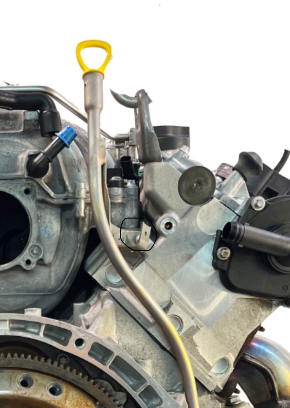

Besides the obvious pcv valve leak, from the video not sure if I’m seeing oil accumulating where the dipstick assembly attaches to back of cylinder head? Black circle in pic attached. Hard to see the Intake elbow and TB.
when I had decent amount of oil in the hose from pcv to the air intake elbow/TB it was isolated to inside the units, no external leaks.
