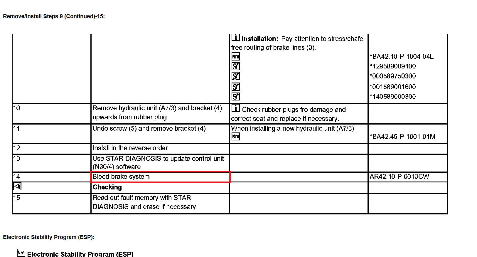

I dont believe there is a specific "abs bleeding" procedure. I think its done while bleeding the brake lines, its part of the system. If you bleed the brake lines you are flushing the abs.
Even in the instructions for replacing the hydraulic unit it just mentions bleeding the brakes.
I was using the 2010 manuals, should the the same or similar for 2013. https://charm.li/Mercedes%20Benz/201...d%20Diagnosis/

Here is the document referred to in item 14 above.
