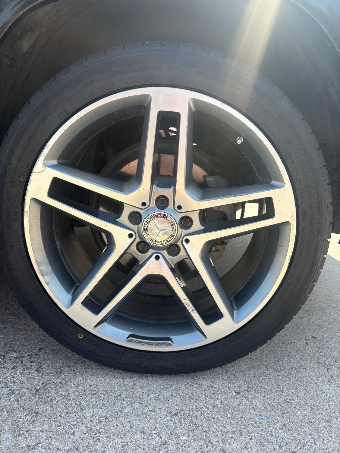

Got a cracked wheel and trying to see if I should look any other place besides eBay. I have searched around but it appears to be out of stock everywhere. I’m pretty sure they made this in a 19 and 20, needing a 20. Any help would be appreciated.

Those came in three colors and two widths. Only in 20" diameter.
If your car has a square setup, then four of these 204-401-66-02. All are 8.5 inch width. Looks like you got 245mm/45 tires so you would need this 8.5 inch wheel.
Staggered is two of the 8.5 inch and two of the 9.5 inch width 204-401-67-02.
If you live in a metropolitan area there are usually wheel repair shops. I didn't have a crack in my wheel but most places can repair a wheel if it is not cracked deep along the barrel.

Why not see if it can be fixed , there are shops that do quality work. It’s just welding.

Thanks guys, I was able to get it repaired. I was on a time crunch, it’s my daughter’s car and she was in from college. We are in a smaller town and don’t have a person in town that does that kinda work. Had a buddy take a shot at it and the bend area wouldn’t seal. Ended up taken it to a guy about and hour away and he got it fixed up. Best $125 I’ve spent.

I fixed a bend rim that also cracked. While the work was good I just could not get past the fact that I could see a slight little bend still so I purchase a new rim,
