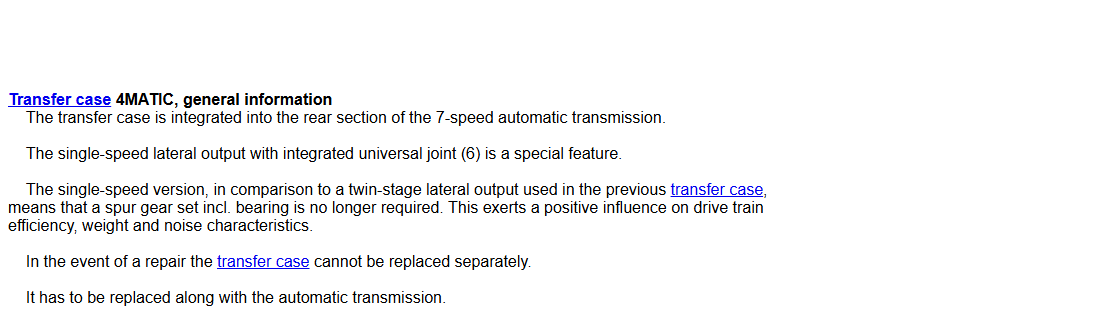

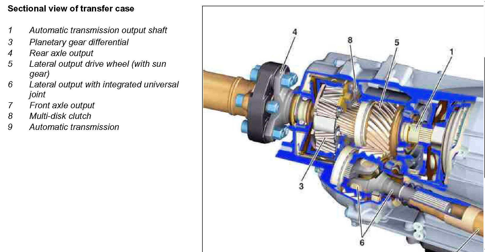

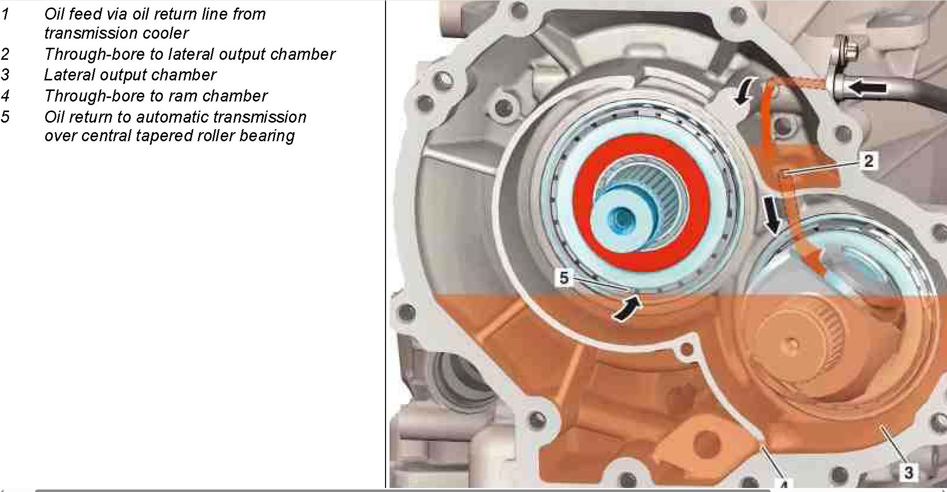

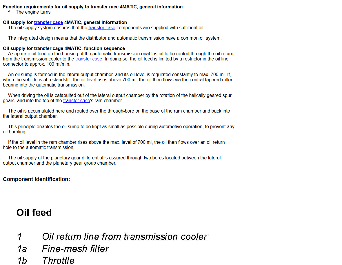

As stated above the transfer case is integrated into the back of the transmission and shares the same fluid. There is a line from the transmission cooler that feeds the transfer case then that fluid goes back into the transmission.

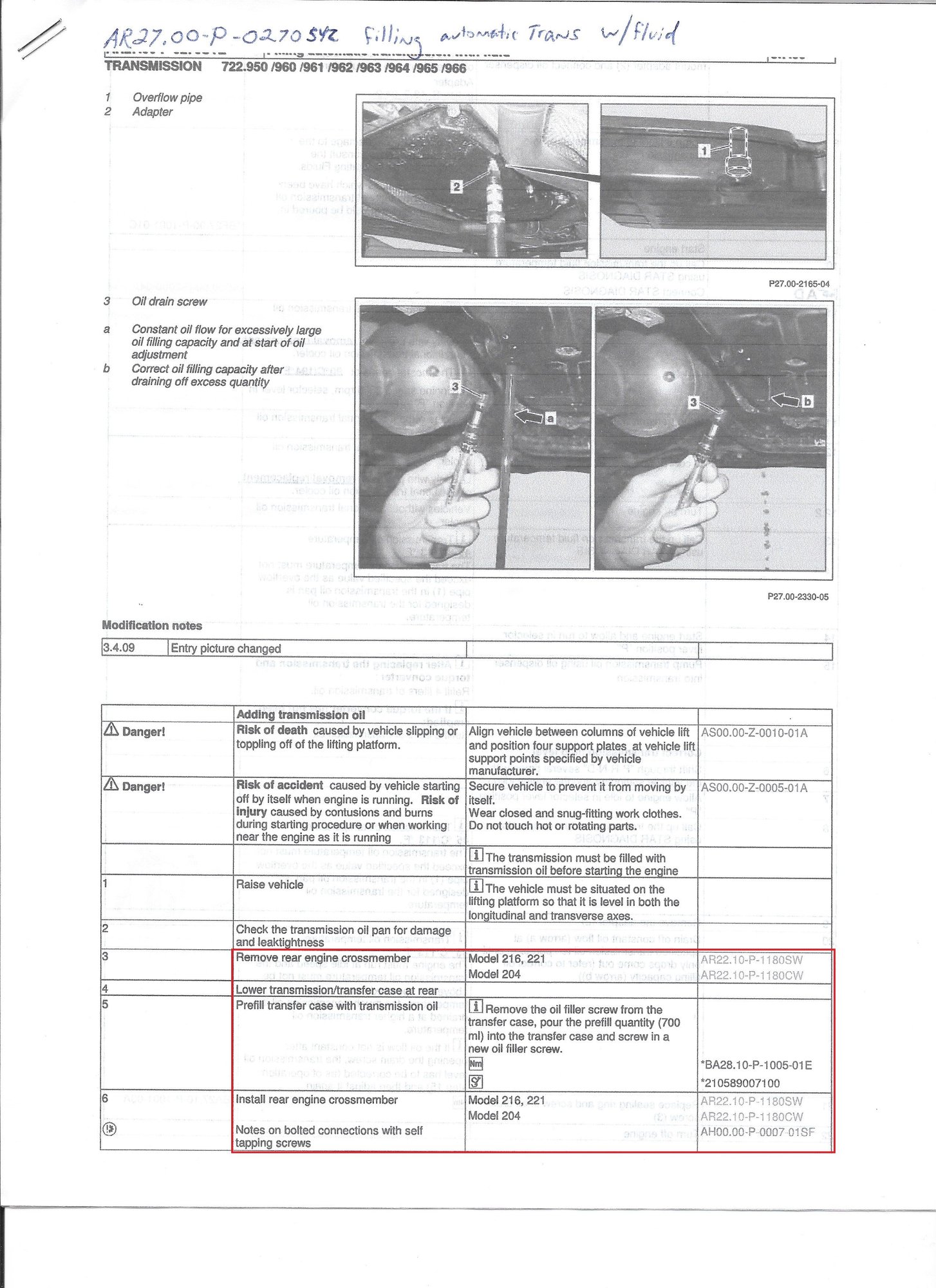

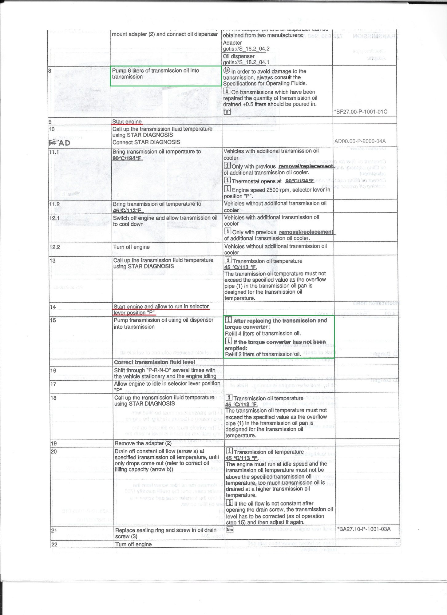

When preparing to service my transmission I noticed the part about pre-filling the transfer case. I did not do that and skipped that part. I think that is if there is no fluid in the system at all, like it was recently overhauled. Im speculating.

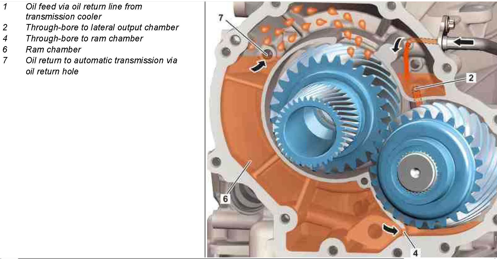

Heres some info on how the fluid flows thru the transfer case.
At idle:
When driving:

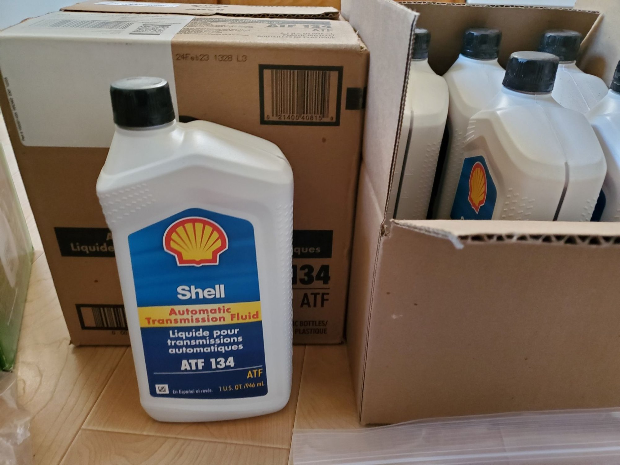

I'll show everything I used. Bought a pump sprayer that worked great for filling the fluid. I replaced the pan due to severe rusting. New sprags because the old ones were heavily corroded. When I was done I cut open the filter just to have a look. Everything looked good, no metal shavings or glitter that I could see.

Heres a diagram of how the fluid flows to the transfer case:

When I re-filled it the first time I pumped in 8 quarts total but then after setting the level 2 quarts came back out. So basically without draining the TC it took 6 quarts.
I put in 8 quarts because I followed the instructions, 6 quarts first fill then another 2 quarts. But after pulling the pan I only had around 5-1/2 quarts old fluid so should have only pumped in 6 quarts. I also thought the transmission was low due to seepage, but was really only low by 1/2 quart.
