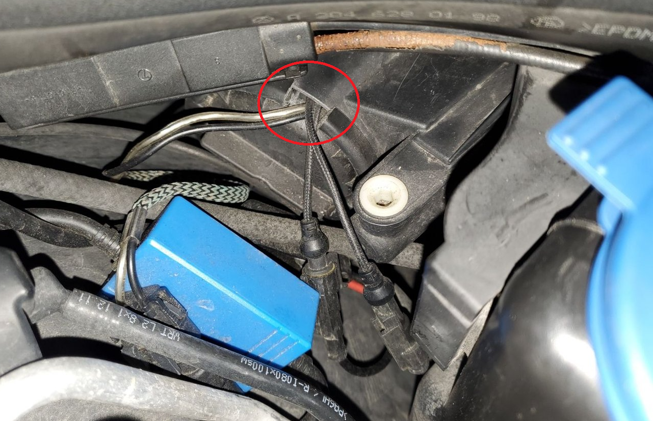

One of the 1st things I did after getting my W204 was install an HID kit for the low beams to replace the dim halogen bulbs.

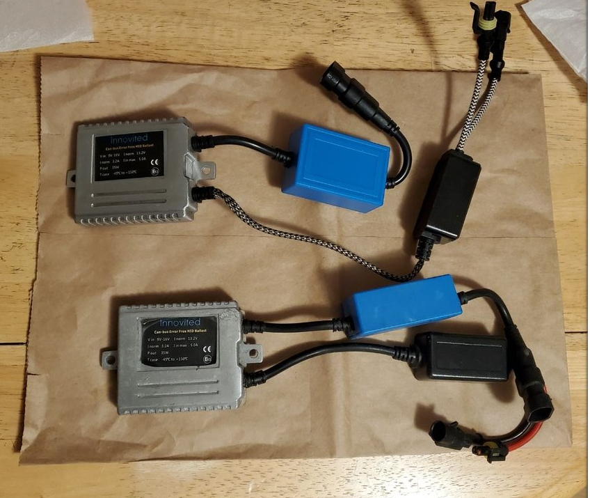

I didnt know how they would work in a Mercedes so I bought an inexpensive Innovited 35w kit to test out. They work great so kept them. I did have to replace one of the ballasts after 4yrs. I did get Morimoto H7-B bulbs because the original hid bulbs were causing a dark shadow on the road. Guess its due to the position of the wire on the side of the bulbs.
When the ballast stopped working I was curious what it looked like inside so opened it up. Seem pretty well made. I have photos here: https://mbworld.org/forums/c-class-w...lfunction.html
I just zip tied all the components down wherever I could find a spot behind the headlight housings. I cut a small notch out on the outside edge of each headlight cover for the wires to run thru.

I cut a notch in the covers not in the headlight housing. I was going to apply some sealant around the wires I just never remembered to. I can always buy new covers if I change back to halogen.
The ballast/igniter/warning canceller thing do not fit inside the headlight housing so 2 sets of wires have to pass thru the cover, or just leave the cover off.

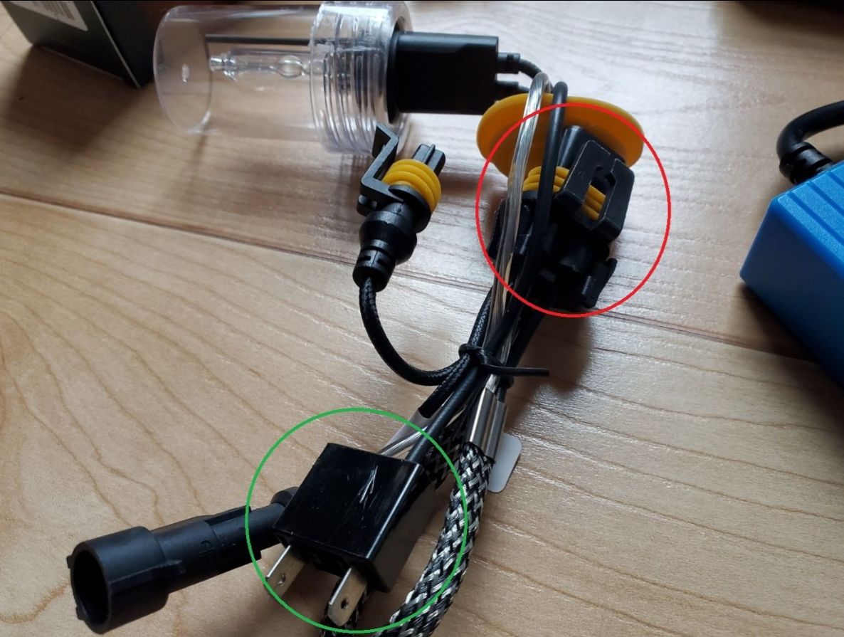

If you do go with an HID kit you can just buy any ballast kit and then buy the H7 bulbs (or whatever bulbs your car has). Its the bulbs that come with the specific connector that installs to the cars factory harness. All ballasts/kits use the 9006 connectors. If I bought another car that has H11 bulbs I can use everything except I would have to buy the H11 HID bulbs that will come with the H11 harness. The Morimoto H& bulbs I bought come with a large rubber grommet meant to fit into a hole you cut in the covers, I just cut the grommets off the wires.
I installed the ballasts/igniters where ever they happen to fit. Just shoved them in there so they dont move around easily. They dont really get hot so im not worried about them melting anything. Heat from the engine seems to get hotter.

My photos are of my HID kit. Not LED.
In my specific car I dont think I can install LED bulbs due to the way the low beam bulbs are secured. Mine has a metal wire type retainer. Even with the thin shape of the HID bulbs it was a project getting the wire holder to snap back on. Been awhile since i did it but I think I removed the wire holder, installed the bulb then get the wire holder back on.

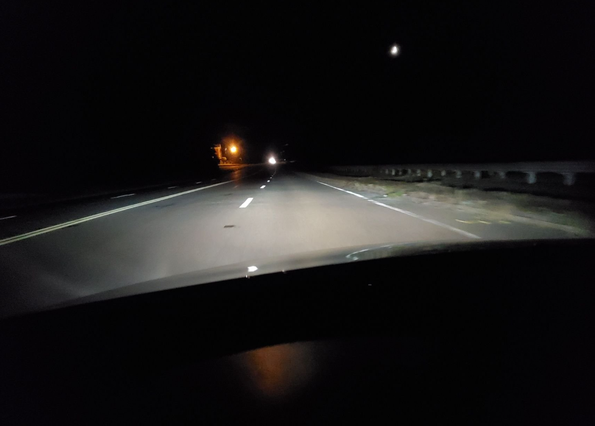

I went for a ride after it got dark. Everything got adjusted properly. Illumination is very good. Distance is reasonably good - much, much better than halogens. I checked for glare, as you mentioned @Mmr1 , and it’s not bad at all. It looks like the projectors work well with LEDs. Even without the decor capacitors I did not have any flickering or light out warnings on the dash. I think HIDs might be better for distance based on past vehicles I’ve driven with them but these are a close second. I’m sold.
