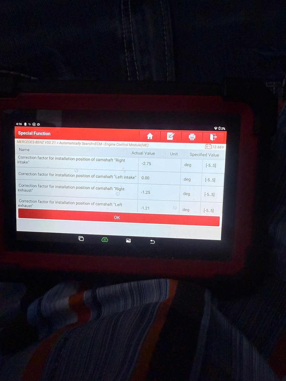

First of all this is my first post, I appreciate letting me join the group. I’m looking for a little help on my 2013 glk 350. So I’m having a hard time wrapping my head around these Mercedes. I have done alot of reading and it’s taught me what I know thus far and how I’m at where I’m at.
Bought the car about 2 months ago with the nutritious knock on start up. Code in computer comes back as P0018 (bank 2 intake cam implausible to crankshaft position. Along with misfire codes that started coming up about 2 weeks ago and I have traced that down to 2 bad injectors (2 new ones in mail now). I’m reading out the faults with my launch x431 crp919ebt scanner.
I believe I have a handle on the misfires so I’m mainly here asking for help with the P0018 code. I bought an adjuster for it and installed it on the bank 2 intake there is still a slight rattle on start-up. I have not gone looking for the culperate on it yet but I’m assuming it’s NOT the new one I put in. I have also swapped magnets and can sensors with other cams and it stays with the bank 2 intake. I have checked Timing in the motor, matter of dact last night I checked it. Put the crank at 53* and all 4 holes showed very close to the middle. I’m stumped on what to do next. I will attach pictures as well of what my launch data streams show. I have performed the teach-in of replacement compustible engine MANY times. It tells you when complete the camshaft corrections. Bank 2 intake is 0.00. Which seems suspect to me. But I’m not a Mercedes guy so that’s why I’m here. If someone has questions and can help me I am available pretty much all the time. I’ll post pics of diagnostics and if you need any other information please let me know.
Thank you all in advance for your help.
