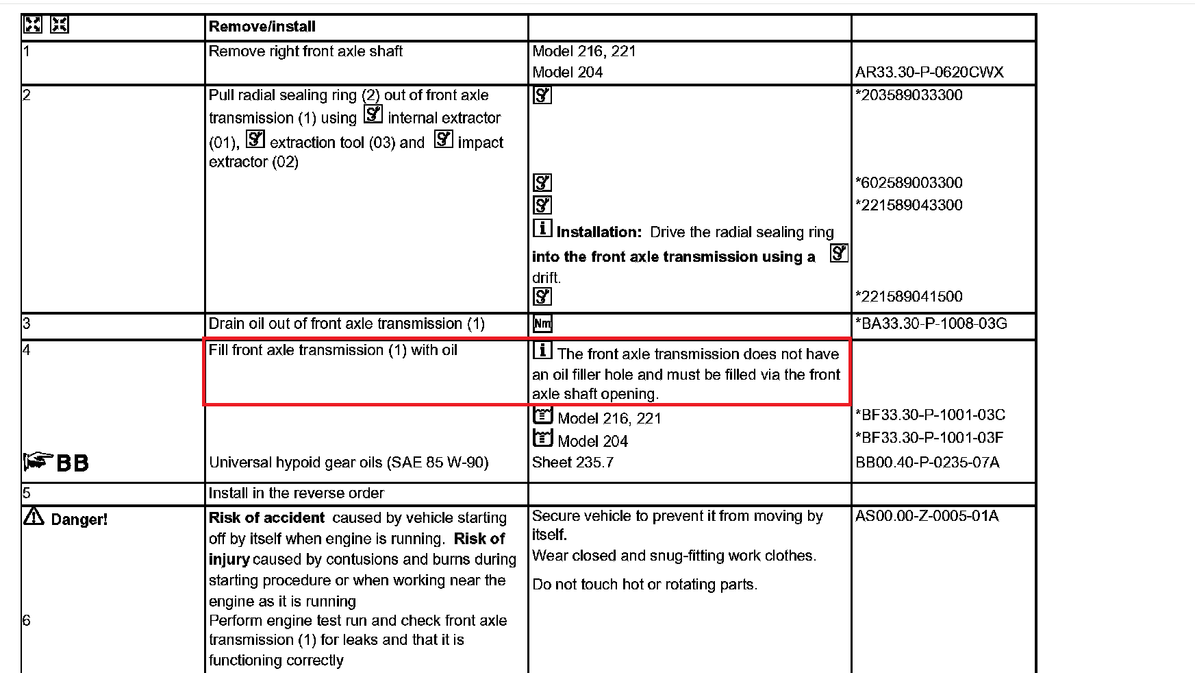

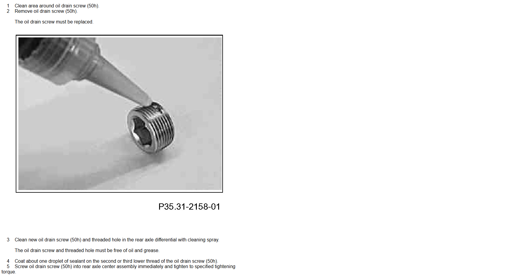

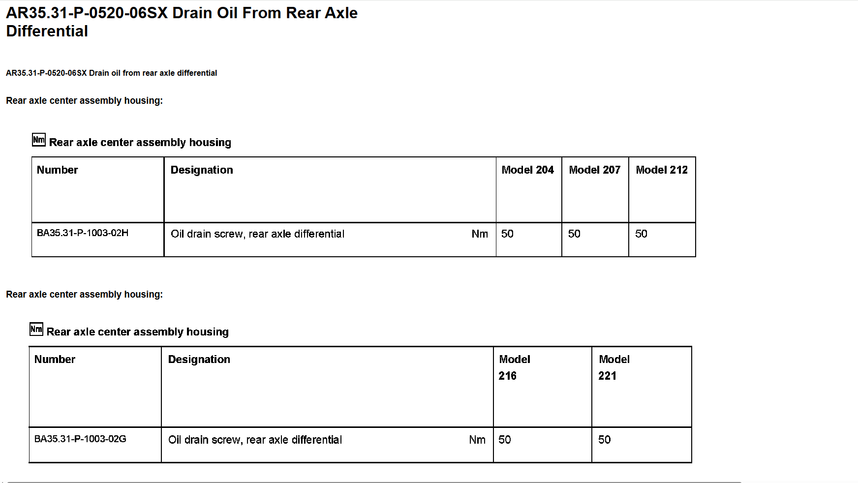

There are no recommended service intervals for front and rear diff. I serviced mine wanting to inspect the condition of the fluid for the age and mileage on the car.
Draining/filling the rear diff procedures can be found in the Maintenance section of the MB manual.
Draining/filling the front is found mentioned in the Transmission and Drivetrain section under replacing the right side diff seal, maybe somewhere else but cant think of it. Since unlike the rear there is no fill plug on the front they say to fill thru the right side axle hole. I did not do that and instead pumped in the new fluid thru the drain using the transmission fill adapter. The front diff drain plug even uses the same gasket as the transmission drain plug.
Maybe the answer would be obvious if I were lying on my back under the car, but, after you fill it, how to you put the drain plug back without getting an oil shower when you take the fill adapter out? The trans has that standpipe in it, but I can't imagine the differential would have one, too.

Unscrew the fill adapter and quickly screw in the drain plug.

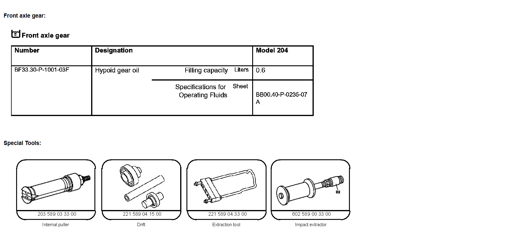

In my photo above I have a quick connect that I unhooked after pumping the oil in. This kept the oil from draining back out. Then unscrew the adapter slowly and once its out plug the hole with my finger. Then get the drain plug ready and put it in. Just had a few drips of oil when done.
I measured the old oil that came out, caught it in a large measuring cup. It was around 0.7l so I pumped in 0.75l to account for drips. I was fully prepared to do it over if I somehow screwed up and too much oil came out. When I did my transmission I dropped the drain plug in the container of fluid and had to fish it out when I was setting the level.

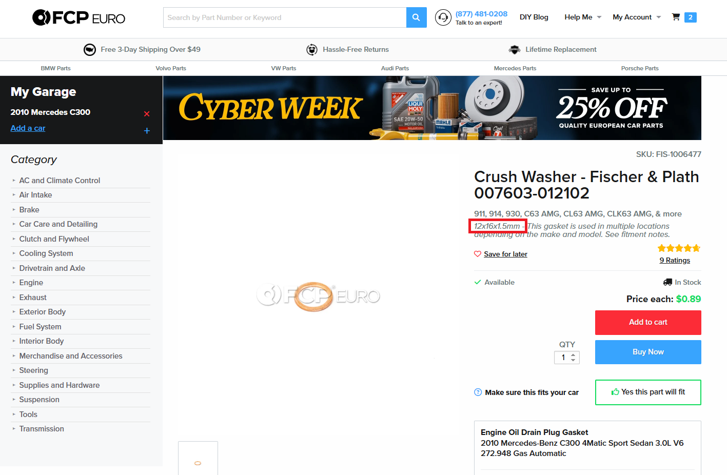

I used Febi 75W-85 GL5 gear oil. It meets the MB spec and they sell it at IDparts which is close so I can pick up my orders and dont have to pay shipping. For the front and the rear two bottles was plenty and have a little left over. It was only $18/bottle at the time and seems prices have gone up. They also have the Fuchs that meets MB spec.
I did buy a new rear drain plug just in case I had trouble with one of them but I ended up reusing the old ones since they were fine. I reused the front drain plug and just replaced the gasket. The front diff uses the same drain plug 000908012009 and drain plug gasket 007603012102 as the transmission pan. I bought a few of the gaskets at FCP when I was placing an order. They are just 12mmx16mmx1.5mm and can find them at your local auto parts store cheap if you need one.

I will use Loctite 243 on threads. Bought the bottle years ago and since I hardly every use it its lasting me a long time. I chose the 243 because I read it is good for parts that may not be cleaned spotless which is most of the things I work on. I like to use PB Blaster and Liquid Wrench on rusted bolts.
The front diff drain plug I got off easy but the rears were really tight and made harder by not having much leverage. I ended up using my Dewalt 1/2" DCF901 impact wrench to break them loose.

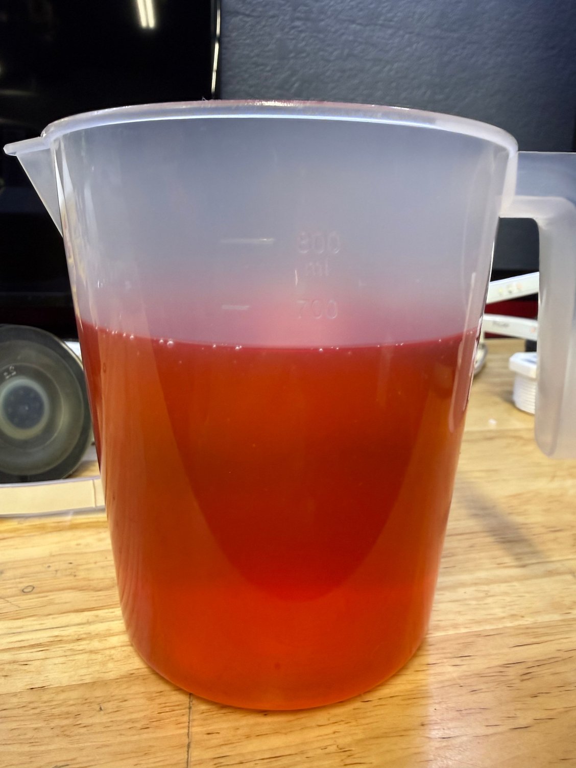

2014 GLK350

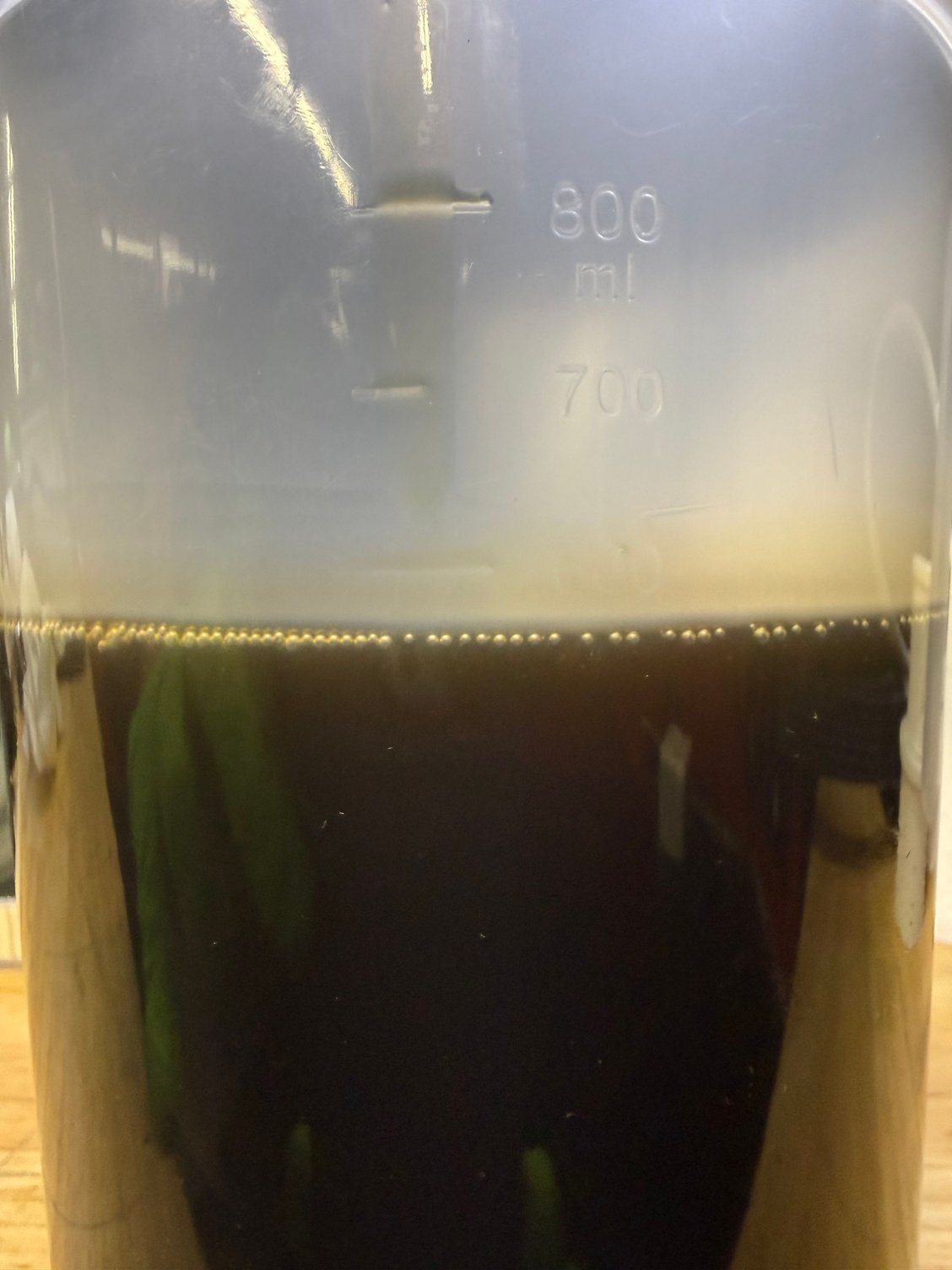

old fluid, new fluid, front diff, 102k miles
