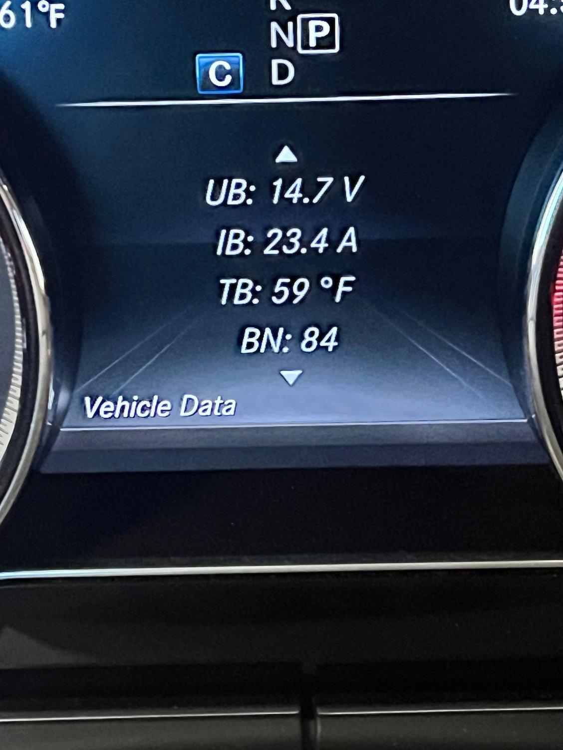

More data
Directly from my 2018 E400
I had to get to a diagnostic mode to see the data
When I started my E400 the current was high but it quickly came down (see the next picture). Note the battery temperature, the voltage should drop at higher temperatures.
After a minute or so the current going into the battery dropped to a very reasonable low level.
6.0 Amps going into the battery
EDIT: the pictures were taken exactly 5 minutes apart.
EDIT: I took these pictures back in January when I was just learning about my Mercedes. It wasn’t hot at all.

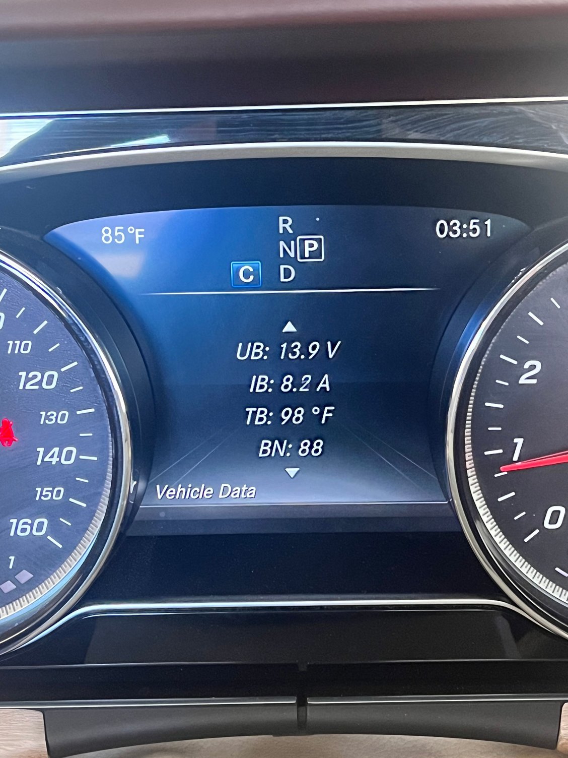

One last piece of data
it is very hot today (I live in Las Vegas) and I wanted to confirm that the voltage would be lower at higher temperatures.
If you research AGM charging you will find that the optimal voltage decreases when the temperature increases.
If possible you should verify that your Mercedes is doing this
Here is the result for my 2018 E400
13.9 Volts at 98F is consistent with what I have found searching for voltage vs temperature for AGM charging
EDIT: this picture is from today the pictures above were from January. Due to the temperature change the charging voltage also changed (this is done to protect the hot battery and to make sure that the cold battery gets a sufficient charge)
I really appreciate your post.
Now I have some data that shows my Alternator is working well
Hopefully this can be helpful to you
Take care
Paul
