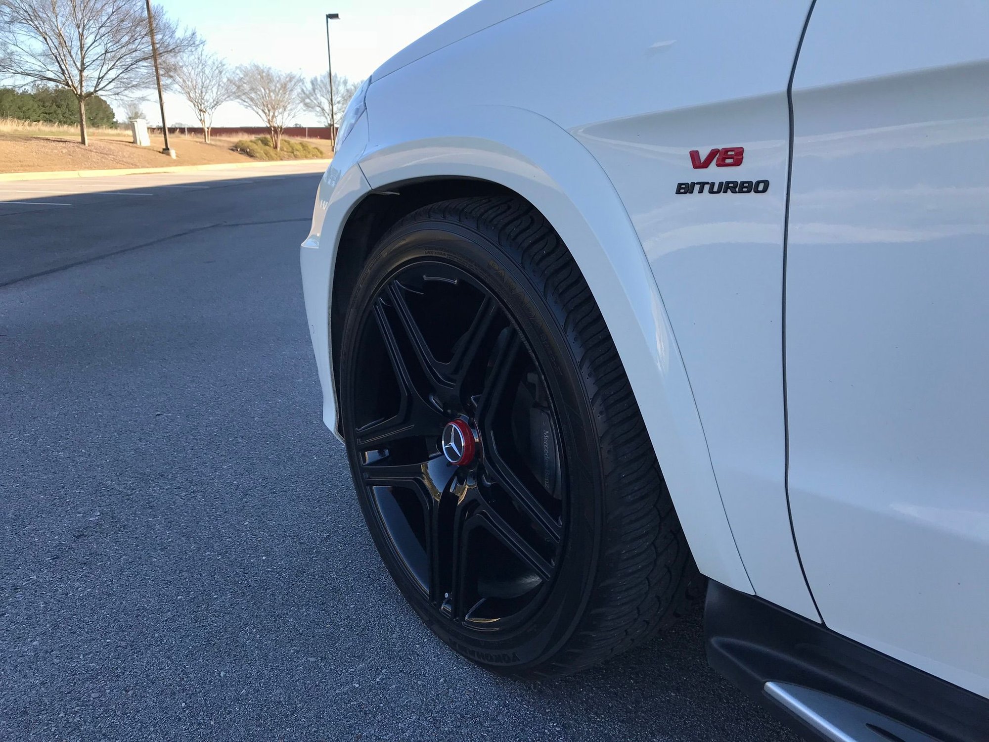

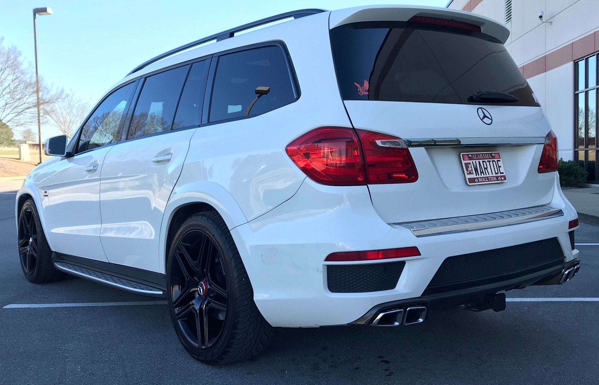

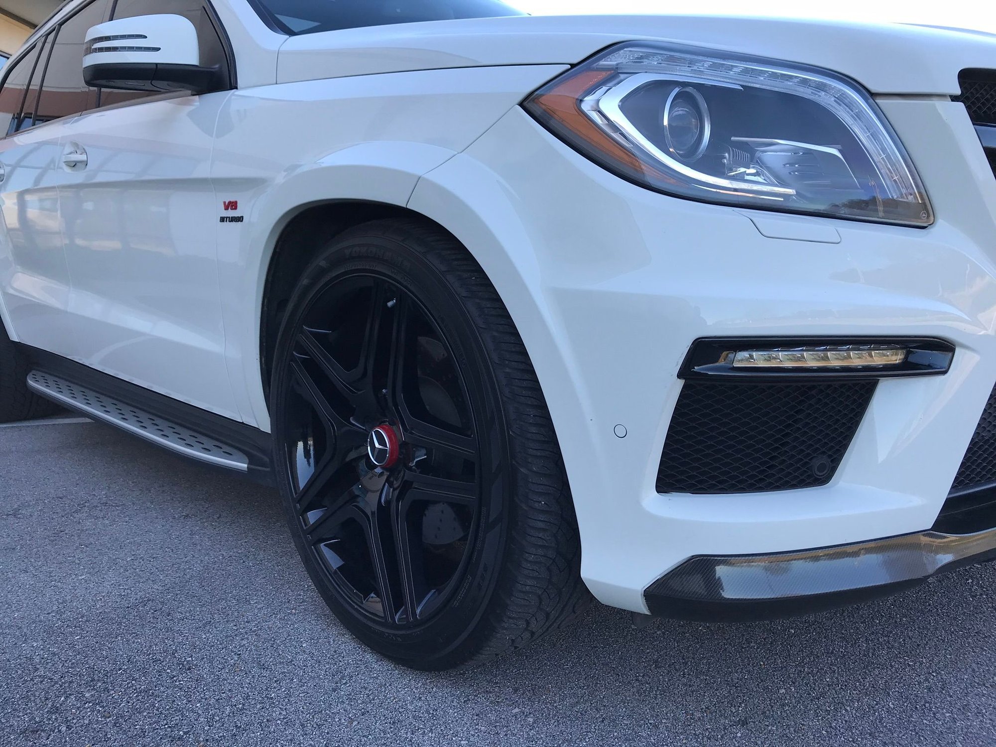

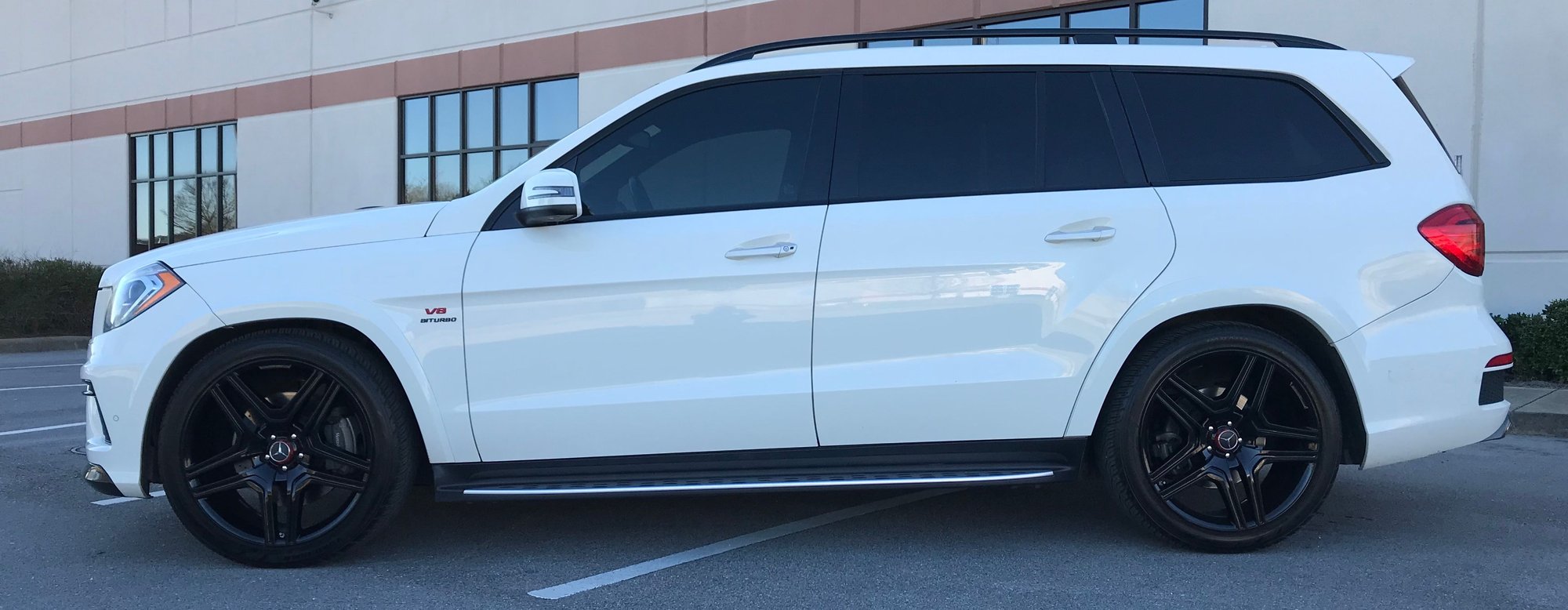

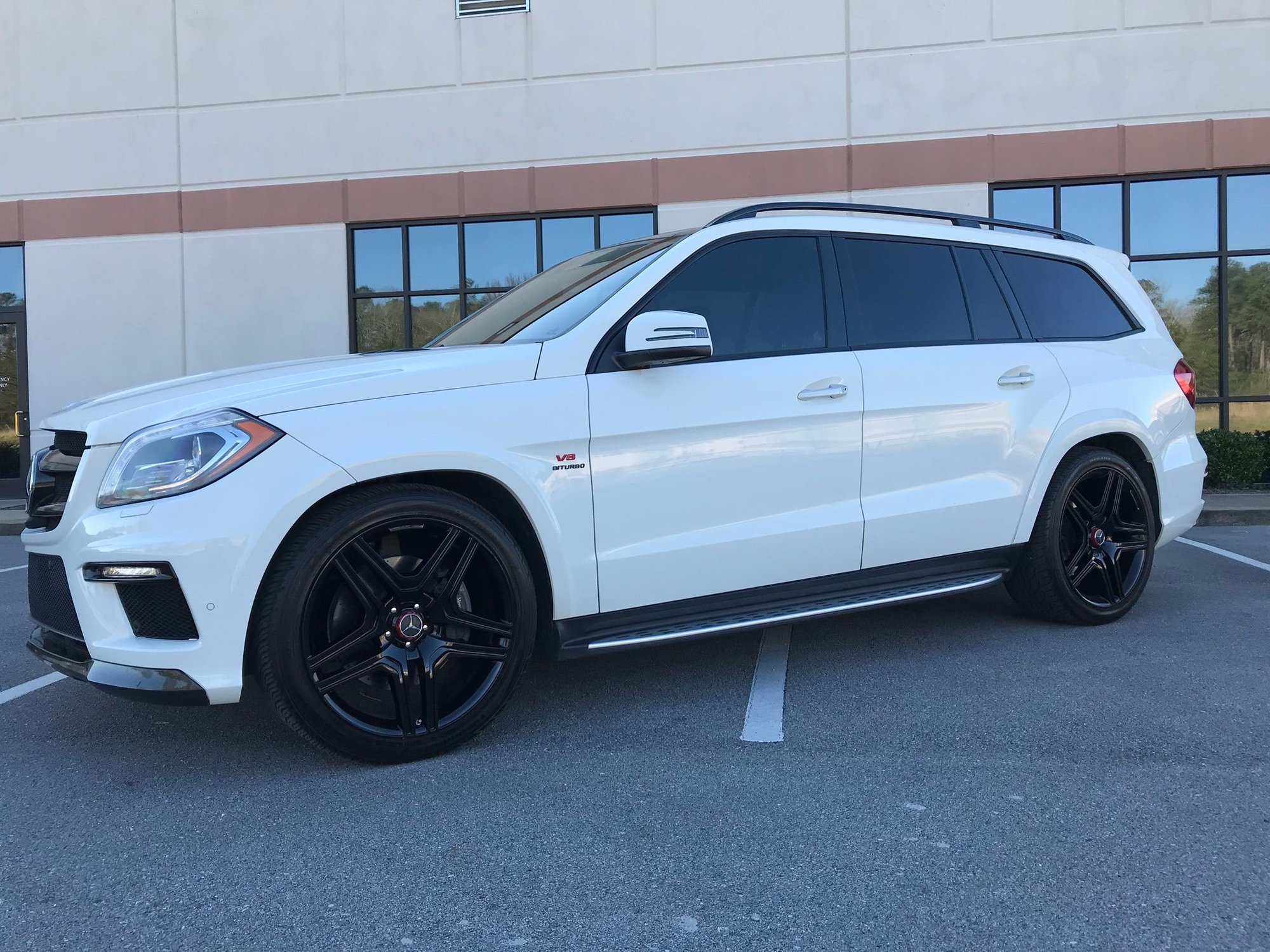

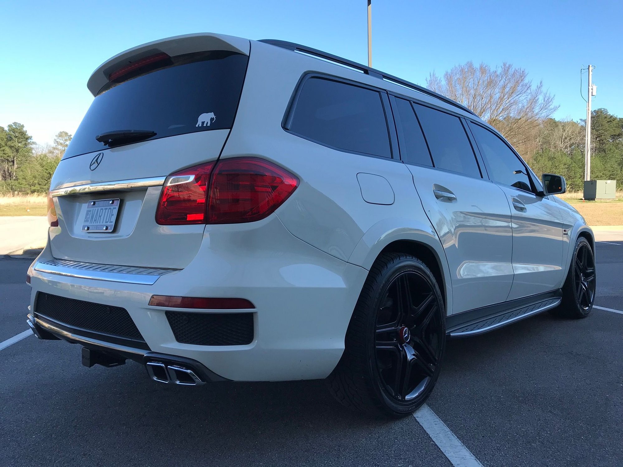

Lowered on links with 22s. Tires have been Michelin’s for the last few years but rotating them is pointless bc it will still always wear on the same inside and get only about a year of them. Also as tire wears in the last 30% or so before wear bars they suck horribly in the rain.
This time have gone with Nexxen tires that were half the price or more and can swap side to side to try to even the wear. Tire shop guy said they suck when I had them shipped there but honestly in the last 5-6k miles they have been comparable to the other more $$$ sets we have used. Time will tell as they wear for the rain traction but again no issues so far.
we have a 550 with catless downpipes and tuned so making 63 level or little higher and the traction dry has not changed.
Setup is not staggered but due to offset of wheels had to add think it was 20mm spacers to push out for better stance.
have a build thread titles “panda build” in the GL X166 section of want to see other random stuff we have done

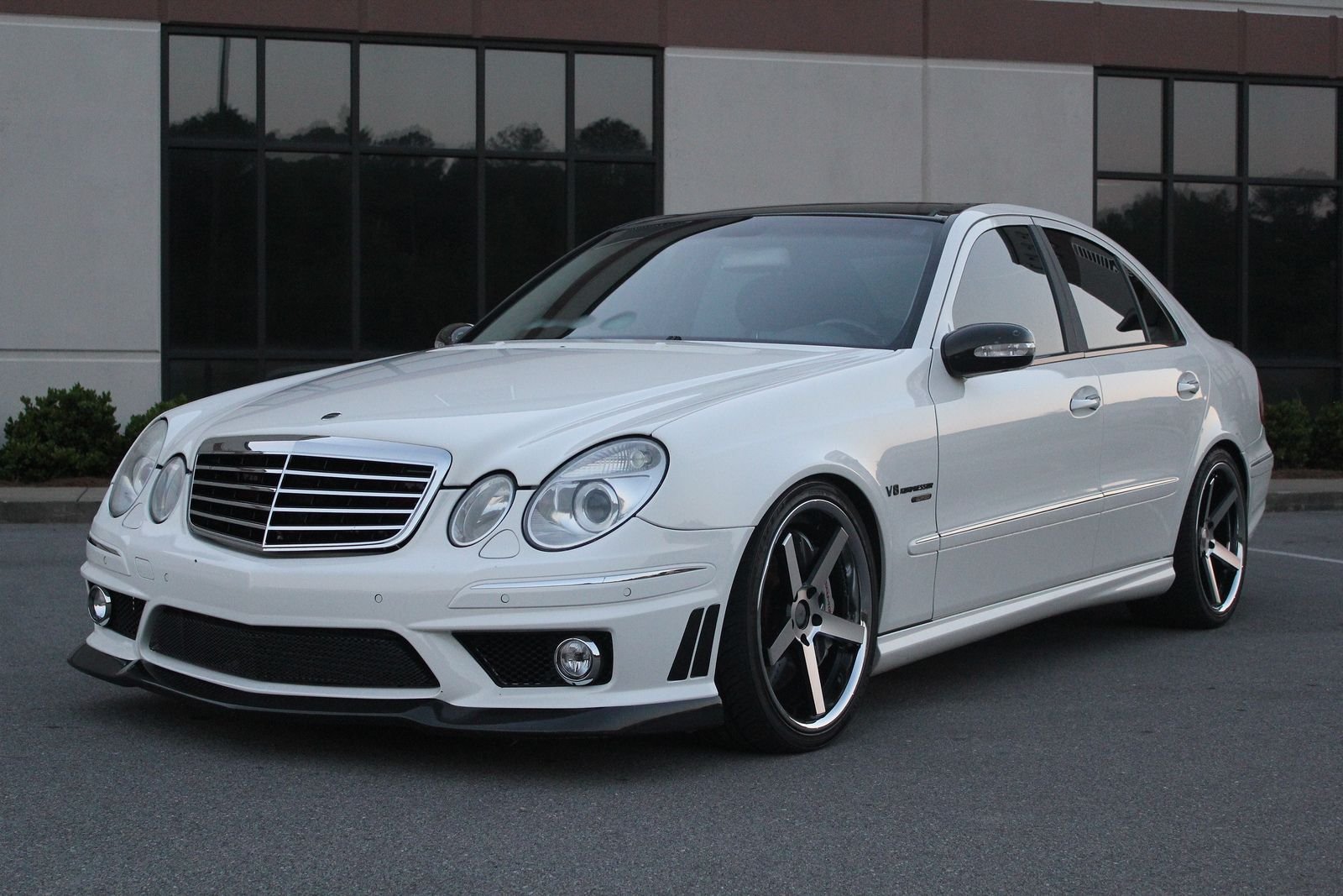

Links are no issue with the ADS. It was easy to install and once done haven’t messed with and were like $200 or maybe $100. My E 55 is lowered using the factory STAR system.
The spacers I added as the wheels I replaced the stock ones with didn’t have quite the right offset for me so added the spacers to push out as far as I could.

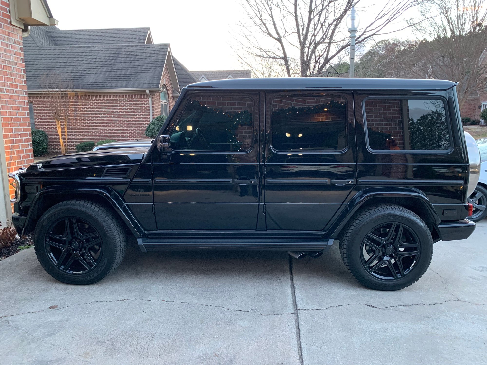

I also agree on the Atturo tires as I have them on our tuned/lifted/spacer setup G55. They have been just fine up to 120ish in the G and no problems in rain or anything.
Pre-lift and satin white wrap to match the others

As for the wheels you went with 20mm spacers all around? Do you recall what the offset of the wheels was? On my standard Benz 22” the offset is 45mm. Trying to determine spacers or just get the offset right in the wheels when I order my summer set. Al least if I’m wrong with spacers I can correct easily.
As for the wear on the tires. Did you get or consider getting them aligned and correcting the camber a bit? I’d have to think this would help get more miles out of the tires.
Appreciate the post. Sharp work!
I will look up the offset shortly and reply back. EDITED it’s 48
Alignment is checked each rotation and it still never matters. Heavy car and lots of weight shifts to the rear constantly.

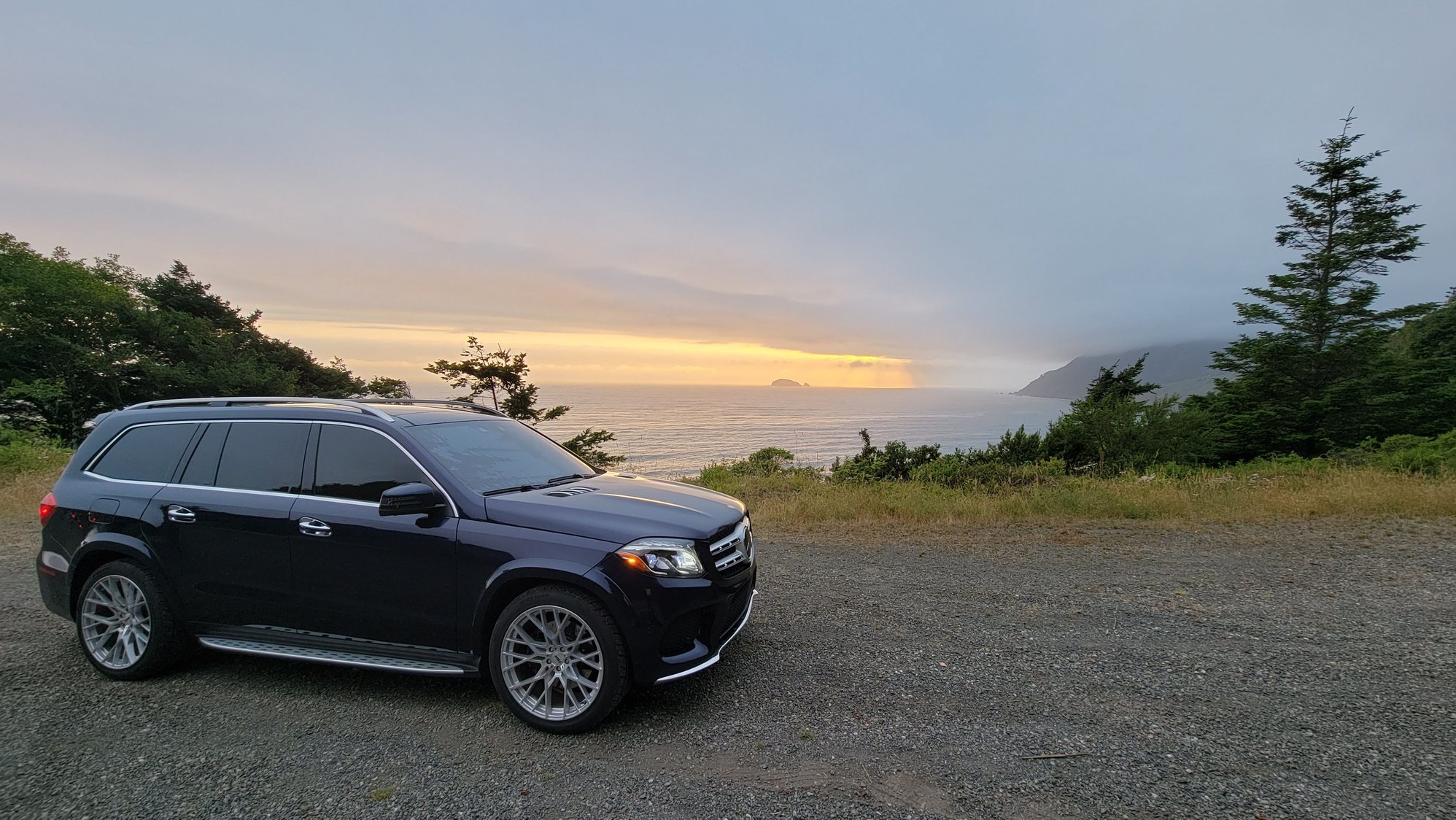

There you go , Gents: TSW Sebring 22x10.5 ET38 shod on Toyo Proxes ST3 285 40 22.
Chirboiz,
Bob
PS: Pardon the dust, but took the rig, fully loaded (crew&gear) on a roadtrip. Toyos are awesome, meaty and sticky. Well planted rallying on curvy backcountry roads. Fronts brakedust a lot due to drilled rotors.
