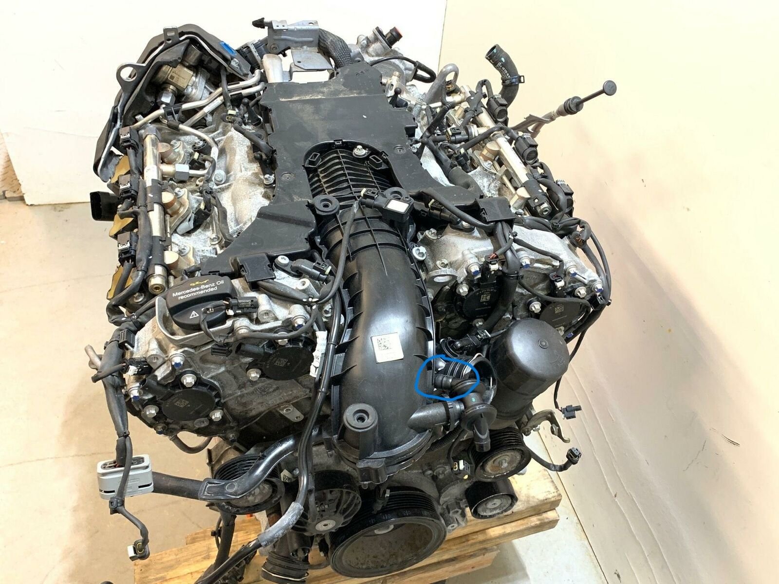

Can anyone identify this part?
Seems seems like a lot of air passing, if I rock it back and forth gently I hear the air suction change… still don’t know if that’s it. Help

That definitely could be your problem
Try getting replacement o rings
Looks to be air temperature sensor

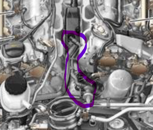

Does any one have a repair manual showing how to remove the air intake plenum? Any tips? Computer has to be removed first then there are 4 bolts on each side of the plenum.
I have to remove the plenum in order to get to where that vaccum line goes under (Image 1). I sprayed trottlebody cleaner where that hose goes down the side of plenum and heard the changes in vaccum when the engine stalls so that's definately where the leak is. Image 2 shows a picture of the plenum removed showing what looks like where the line ends up.

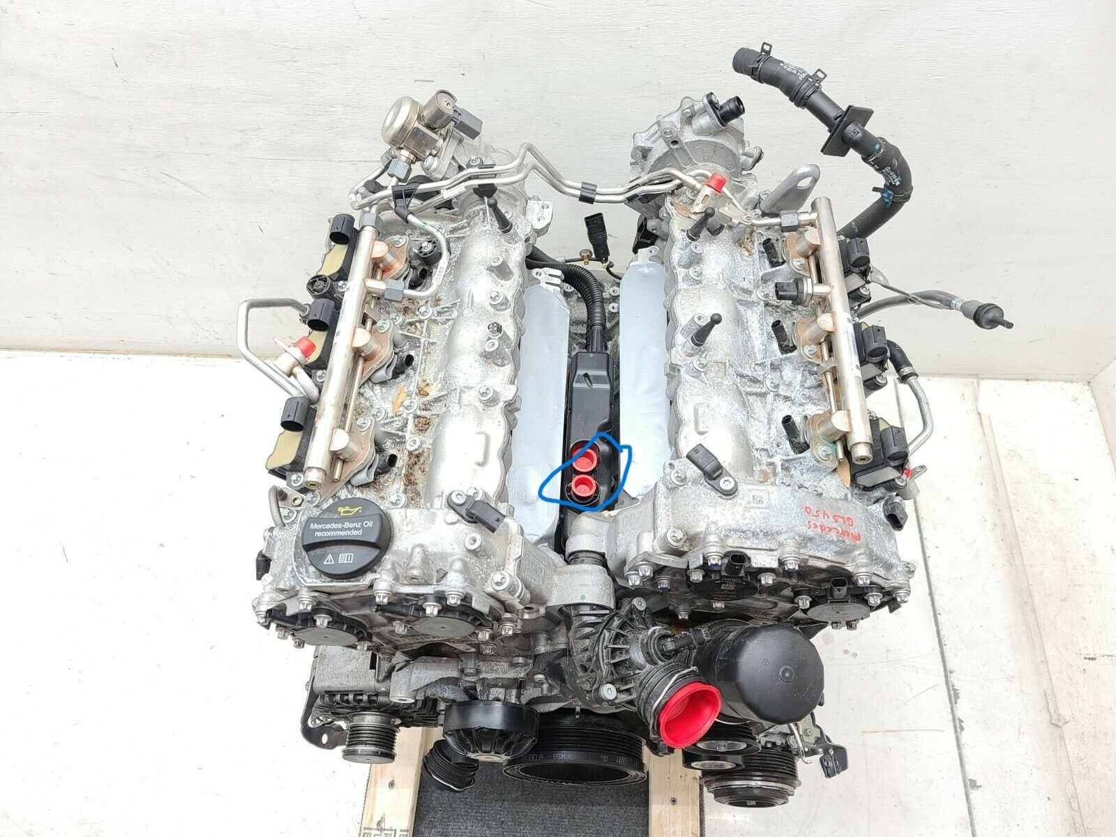

no problem, just don't know how that happened, cold weather related maybe. Here's a picture of the actual line that was replaced.
