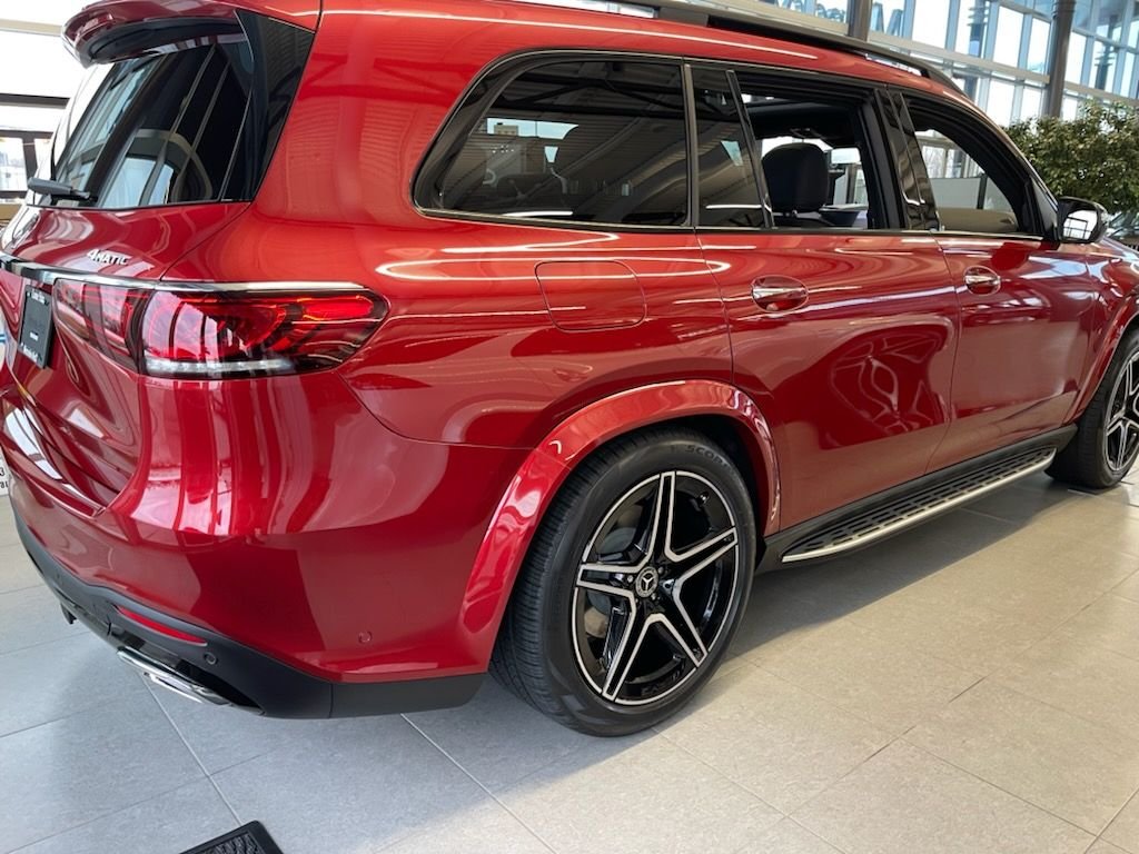

Here's the '18
and here's the '22

Just my opinion but that looks like my vehicle when there was a problem with the airmatic system

When I had my GLS, it would settle after parking extended periods of time, but it never looked like that. That looks like a leak somewhere.

Its not normal or ok. My 2008 GL450 has been sitting for 2 weeks and the height hasn't changed at all. It did, however, sag like that when the airbags had leaks. It hasn't sagged since I replaced them.

Sales guy is talking rubbish. If you want the car tell them to replace the rear airbags then work out a deal (after the airbags are fixed).
