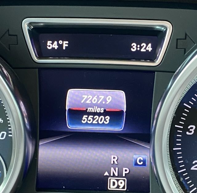

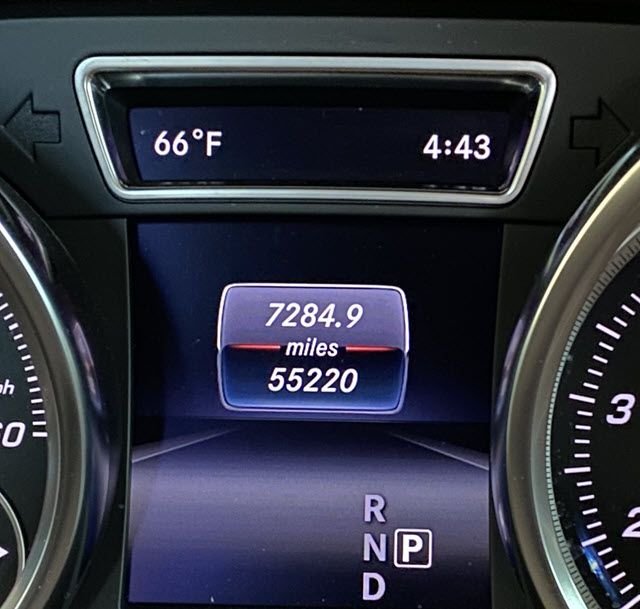

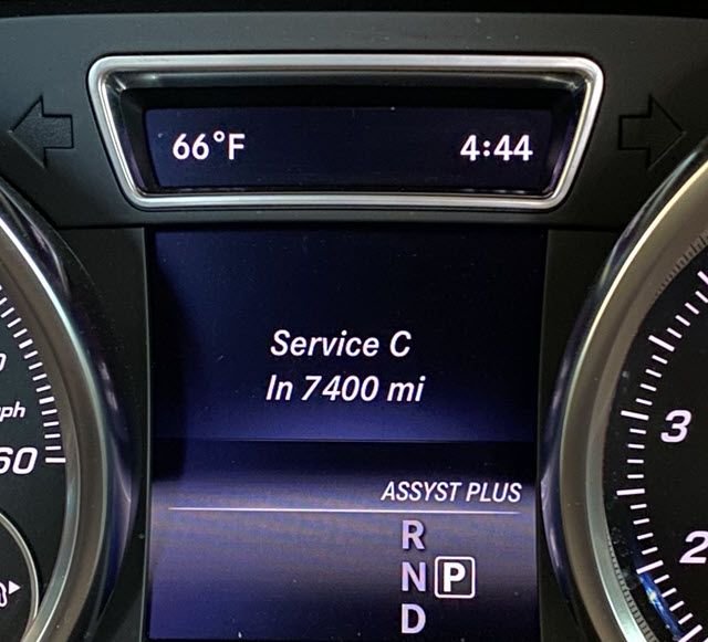

2018 GLS 550 purchased used CPO in January of 2021 with 27773 miles on it. I also purchased an extended warranty AND pre-paid maintenance. The car now has 55220 miles on it but it has never called for a scheduled maintenance service. Everytime I check the ASSYST PLUS it says "Service C In 7400 mi" - regardless of the mileage displayed the Service C mileage is always the same.
Is this functioning correctly? I've paid for pre-paid maintenance but the car is never calling for service?! (I have changed the oil and filter twice, and the air filters once on my own)
These are pictures of mileage and service counter from yesterday and today, and, the "Service C In 7400 mi" has read like that for over a year.
Yesterday afternoon.
Today.
Today.

I had the same thing happen on mine, and I had to bring it back to the dealer twice to have them reset from their own system. It would not reset through the steering wheel. However, since reset, it has been fine.
Mine was on Service C 365 Days for 12k miles.
