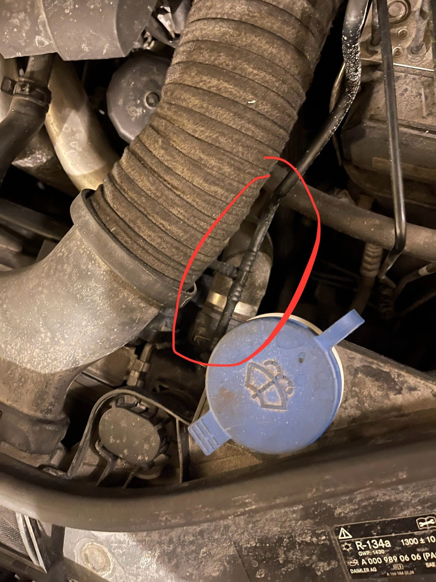

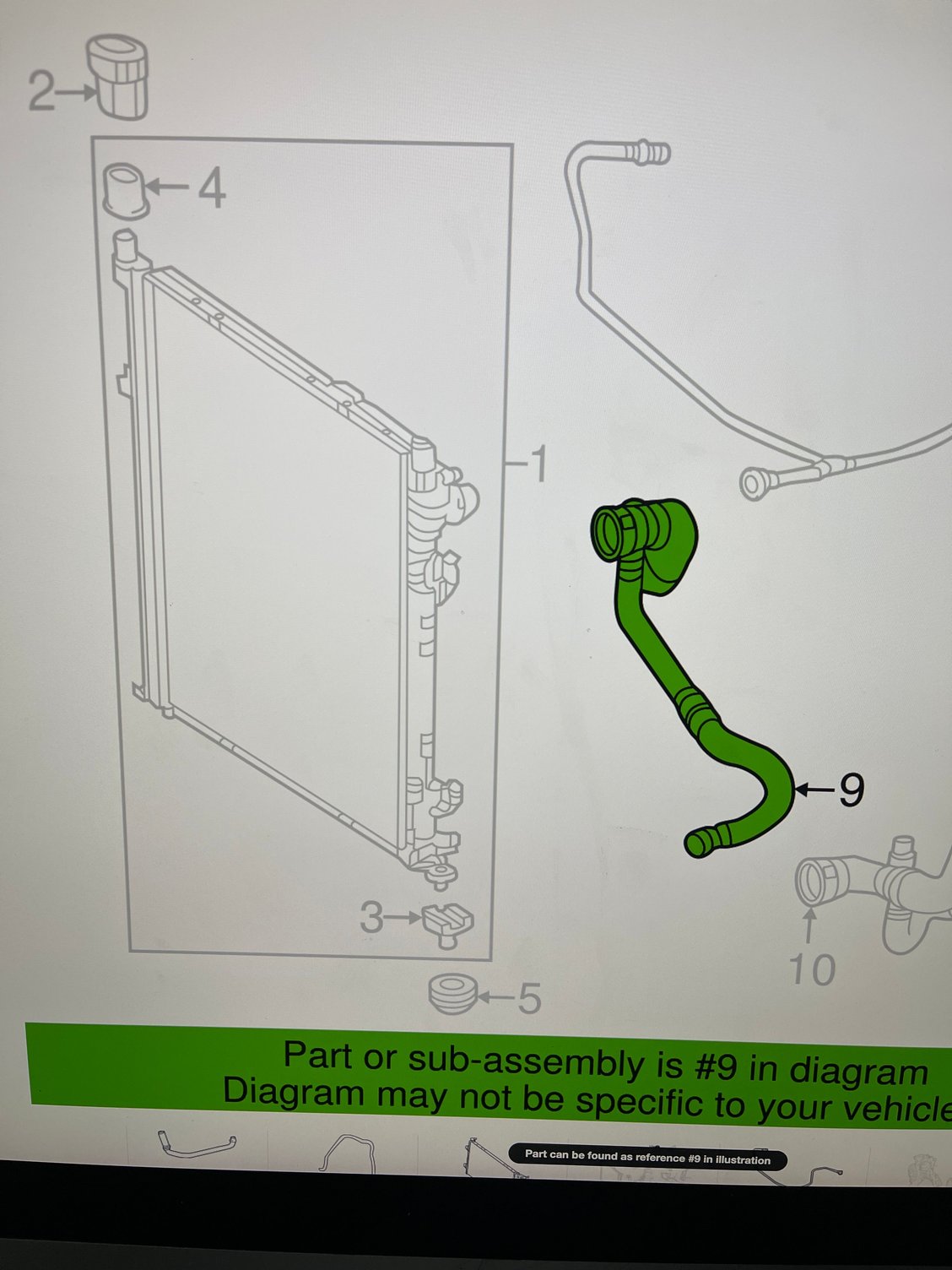

this is the hose i have access to and it is pretty soft. I left the car over night though.
That's a good sign. If possible, check it a few hours after running it to full temp and driving at least a couple of miles.
You can get the combustion gas test kit from most auto parts stores, Harbor Freight, etc.
