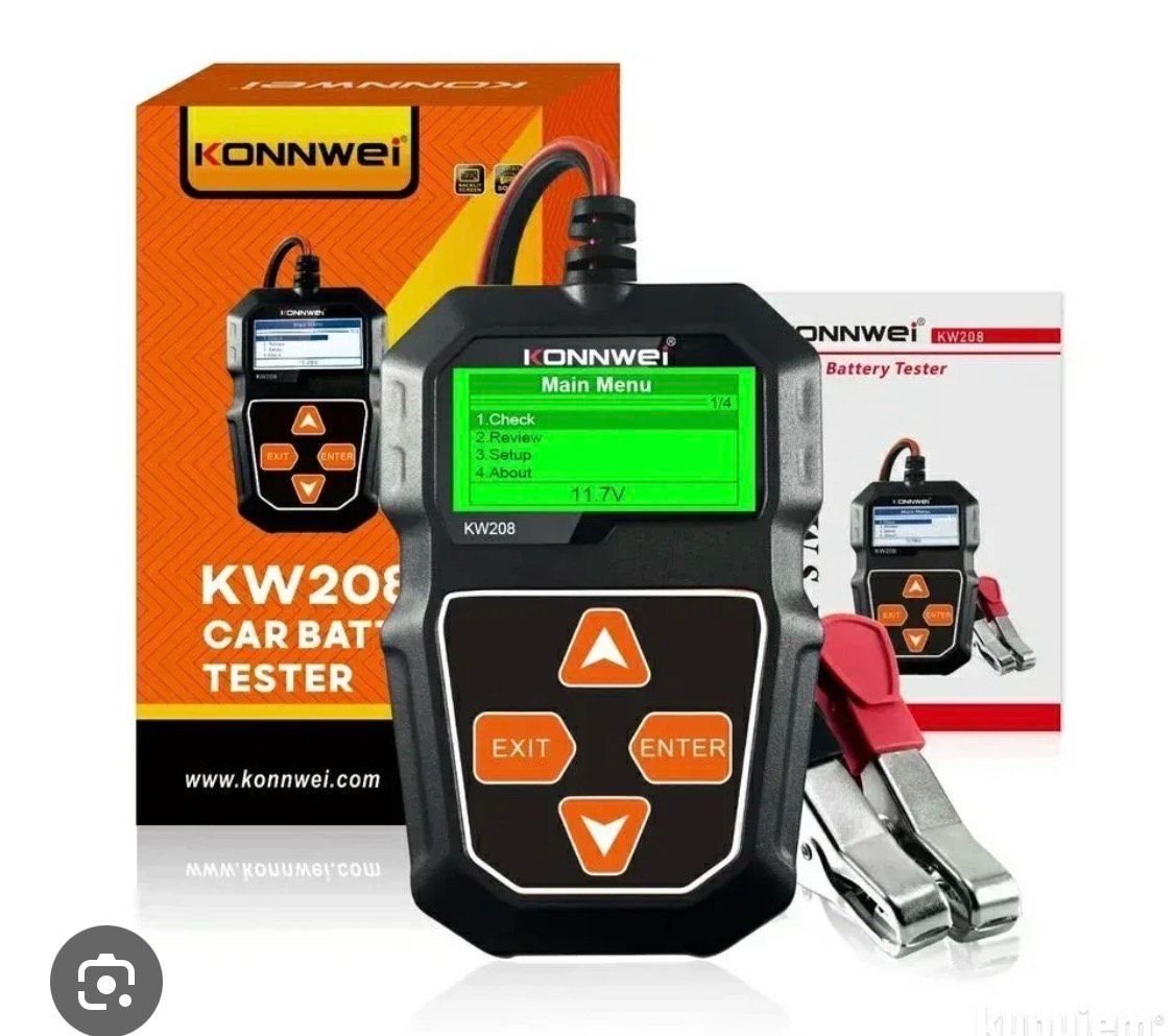

Got this cool thingy,tells me battery health,state of charge
I have 2 of these -- one is a Foxwell and the other is a Topdon. I haven't used either one enough to opine as to their usefulness, but it is important to attach them directly to the battery terminals and not the engine compartment jumper terminals (if your vehicle is so configured).

true,it gives me totally diferent reading when i connect to jump terminal under the hood
